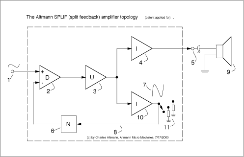

Is there anybody built a non feedback amplifier??
However, I have determined that I can move the pull-up resistor to the collector of the previous stage and then place the damping resistor between that collector and both bases, which are then tied together. That way I can get evidence as to my best option. It is good to try different possibilities and then zero in on the best choice, so long as the part count is considered.
