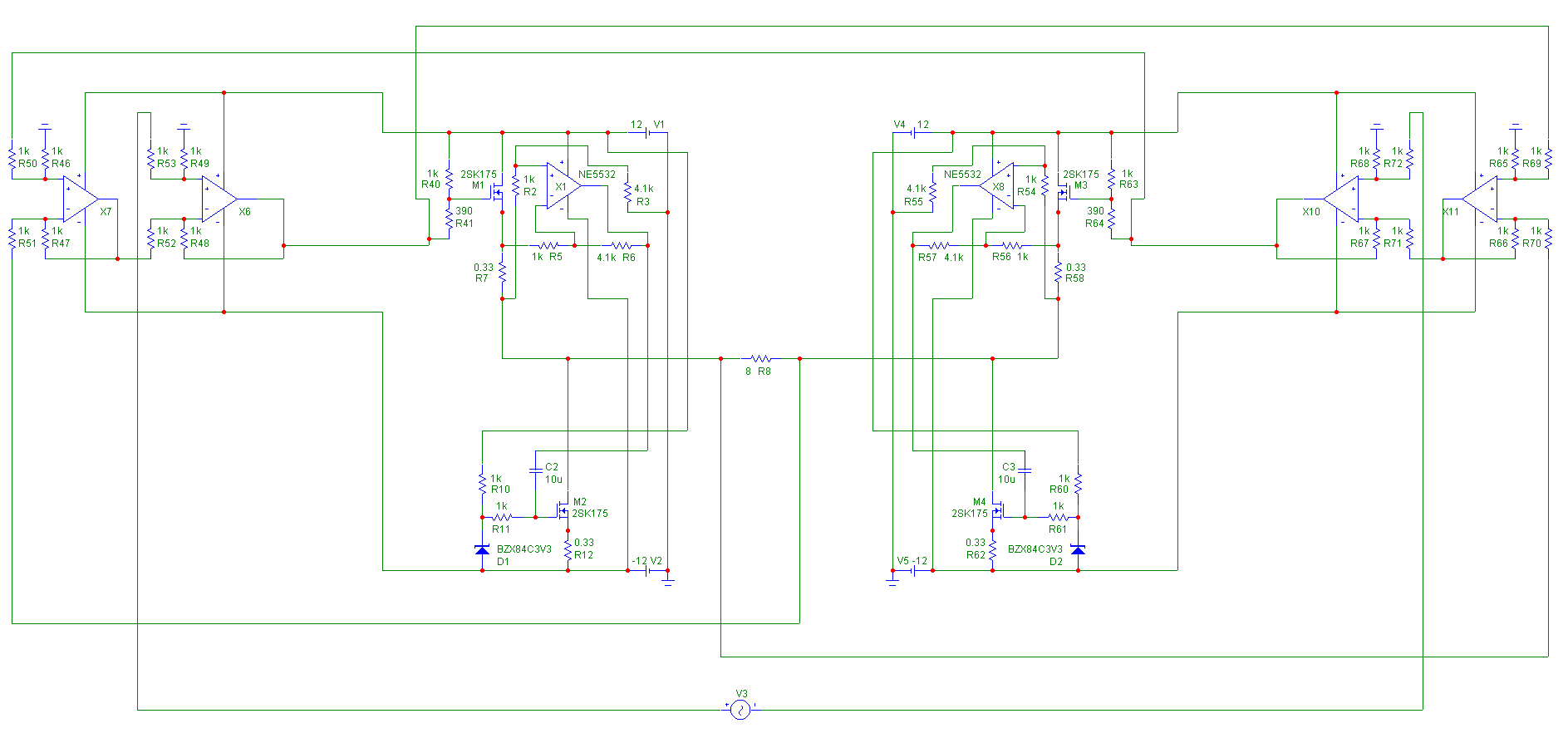

My new creation
Xcuse me for the big schematic
Inspired by this very thread I made the crossed distortion killer circuit without feedback loop around the output fets M1 & M3.
The difference between leftside input and left side output is added to the right side and vice versa.
Gives K2 -158 dB and K3 125 dB across load.
With feedback it is even much better.
What ya think ?

john curl said:Personally, I am concerned with any kind of feedback, because it tends to multiply the intrinsic harmonic series, generating higher order harmonic and IM distortion products. I don't know if this happens with a follower, however.
If it does, that would certainly dispel the notion that a simple emitter-follower is an "open loop" circuit with no feedback, wouldn't it?
Andy, would you care to do a distortion spectra for a simple emitter follower versus a common-emitter with the same value of load resistor?
