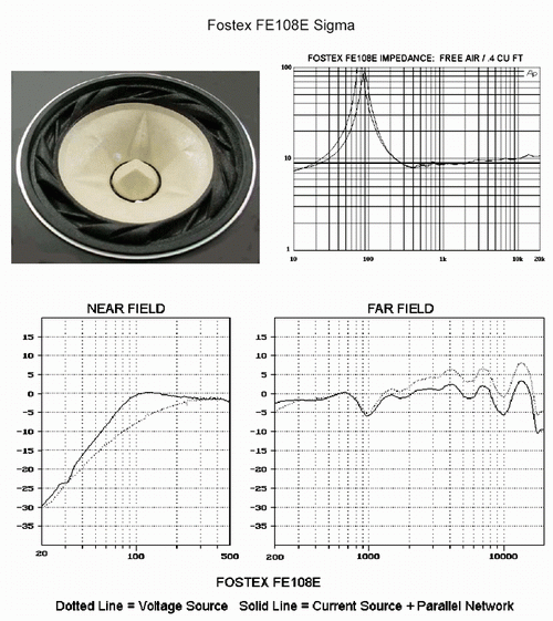

hello all,
here is the link to nelsons article i mentioned above --> http://www.6moons.com/audioreviews/firstwatt/firstwatt.html
below you can see a near- and farfield measurement from the 108ez. it's from nelsons article.

The difference between the independently measured in post 4 and Fostex's measurement can perhaps be somewhat attributed to the smoothing?
My apologies, I just read this. This is exactly what I saw when looking at the graph. The Fostex graph appears to be smoothed to 1, or 1/3 octave which might make that dip look much more benign.LilMik said:how does fostex smooth there measurements. if you use 1 octave or 1/2 octave, a small but sharp dip may disappear or look hamrless, if you smooth over 1/16 octave, it can look very bad.
The dip is probably there. But it is not unfair to present 1/3 octave smoothed measurements where the dip doesn’t look bad, rather it is unfair to present unsmoothed (or smoothed to 1/12 octave for instance) graphs where the dip looks scary. The 1/3 smoothing isn’t there for nothing, it isn’t a random choice but a well thought one. It is coming from years of experience and it is correlated with the way our ear responds - our ear smoothes frequency regions in such a way. If unsmoothed frequency responses of well-known speakers were to be presented you would all be very scared and would come to the (apparently false) conclusion that all these speakers are not about hi-fi.
Furthermore, our ear corresponds well to bumps but is more insensitive to dips. Someone should perhaps look after bumps in 1/6 smoothing, and dips in 1/3 octave smoothing. Lastly, our ear doesn’t reveal the same sensibility in every frequency region (and I’m not talking now about equal loudness contours) – it responds more if a same octave region dip is in the 300 Hz region for instance, were it will perceive changes in tonal balance - voices and string would seem thinner, but doesn’t easily recognize even a broader dip in the 1KHz region, which doesn’t easily change the tonal balance)
This fostex driver is probably of very good quality and its 1/3 octave response reveals part of this reality.

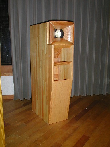

that is beautiful dave. what loading is it? bass reflex? truly beautiful.
Those are a customers buschhorn 2s.
dave
dave
They dont look deep enough to be horns. How deep are they?
http://p10hifi.net/tlinespeakers/FAL/box-plans/buschhorn-Mk2.gif
