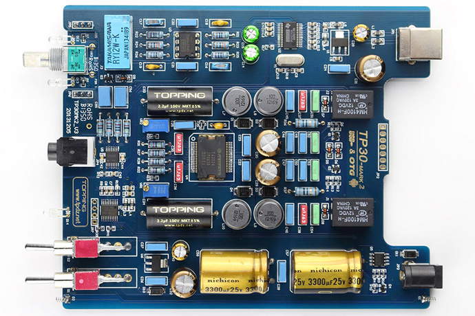

I have the Topping TP30MarkII (2x20W Amp with ADC) and I'm going to use it to build a boombox.
The problem is, the sound is very good when I connect my phone (supports OTG) and PC through USB ADC but when I connect those through the RCA inputs, not just only dynamic is gone but also the sound level is much lower.
I understand about differences of sound dynamic with these connections. But lower sound level is not acceptable for me.
My question is "Do I need a pre-amp if I want to connect them through RCA input?"
If your answer is yes, I think I better buy a new amp and let the TP30 become the desktop amp, right?

What is your phone? It's DAC might not be up to par compared to the Topping.
Sorry I didn't make myself clear.
The DAC is in the TP30 power amp.
My phones, none of them have DAC but Lenovo A700Plus supports USB OTG.
If I connect the phone/PC to TP30 with Earphone-RCA cables, the sound output lost dynamic and also has lower power compare to DAC USB connection.
Yes, well if you connect your phone or pc through RCA, that it will be up to DAC inside those devices to convert digital signal (1s and 0s) to analogue (voltage). All devices that has an audio jack will have a built in DAC. It just may not be as good as the one in the Topping if the source device is cheap.
A pre-amp would help, I am not sure about the dynamics, but definitely the volume. But an amp is only as good as its source.
In regards with the other option. I agree that the topping would be a waste if used with a pre-amp cause the ADC would be no use. However, I would look into getting a good TPA3116 or TPA3118 board if you are going with that route. You can use a lower costing >24V power supply instead of a 32V. The TAS5611 would be a bit much to use on your speakers.
A general consensus right now is that these have pretty good sound quality. But be aware that you have to deal with cheap components from a chinese board compared to a semi-reputable manufacturer like Topping.

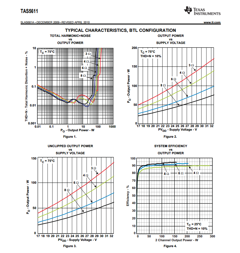

Looking at the datasheet, the power output will be limited when the power input is at 24V. Looking at this, looking at other TI amplifiers would be the best choice in my opinion. I do not know what power output you will need for your boombox. What speakers are you using?
It seems better/comparable performance can be achieved with a 3118/3116 pbtl vs a tas5611 (at 24V input voltage)
Amp boards and power supplies are smaller and cheaper with the TPA chips.
Unless I am completely overlooking the merits and advantages of this TAS5611 chip, I would go for two of the 3118pbtl chip I previously linked. Pair that with this power supply that forum member Jensen mentioned and tested, you can have a good power output in a small package. The amp boards are the size of a postage stamp and the power supply is about 1.5 x the size of a credit card. Either way, tpa or tas would be from chinese manufactures.
