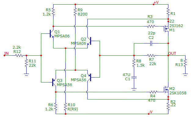

now true measurements
i am sorry..i made a wrong measurement..now its the true one..
i have two pairs.
2sj162 : one of them is 0.8volts and the other one is 0.812 volts
2sk1058 : one of them is 0.666volts and the other is 0.670 volts
now i dont know that is it enough matched to make a high end class a or ab amplifier...what do you think?

Re: now true measurements
@ what current?umut1001 said:i2sj162 : one of them is 0.8volts and the other one is 0.812 volts
- is it necessary to match 2sj162&2sk1058
