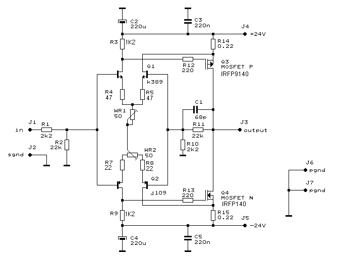

schematic
for example this circuit..
and i need a good class a pcb..i am working and i have not much time to draw it..would you send me a class a pcb ..will work at + -35 volts?

that's my circ - in fact my friend Oly made this little schematic .
you didn't follow exact thread where this is posted ; somewhere in start of Babelfish J thread
it's intended for IRF150 (or IRFP150 , whatever ) and his cousin IRF(P)9150 ; matching isn't so crucial there .
you can use 2SJ and 2SK with slight recalculation of drain resistors of Q1 and Q2 .
and - it isn't too wise to make it with more than 2x 25V

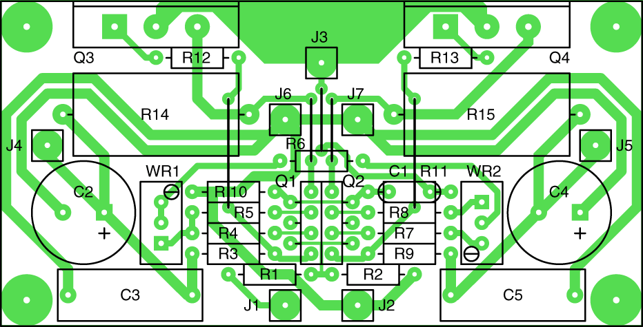

I have somewhere graphical files for that pcb ...... is that what you need ?

yes i need a schematic and pcb..my friend made a class a amplifier works at+-24 volts..it is working with irf540 and 9540..but the current was not stable enough..i will use 2sj162 and 2sk1058..if you send me schematics and pcb i will be happy;) thank you very much:)
well - for stability you need to place input jfets in tight position , same as on this pic:

umut1001 said:
thank you:) is it working well? which transistors are being used for Q3 andQ4..can i use 2sj162 for it by changing the bias?
sorry- I attached wrong picture in post No.7 ; there is right one ;
you can use 2SJ and 2Sk in output if you almost halve drain resistors for 2sj109 AND 2sk389
