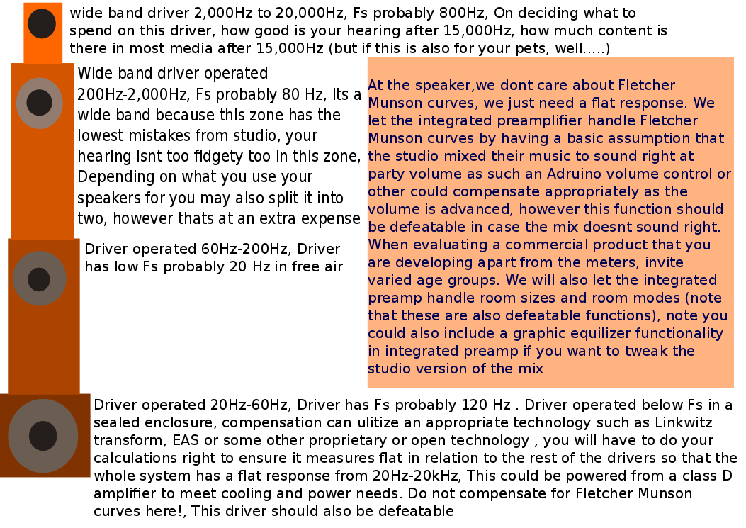

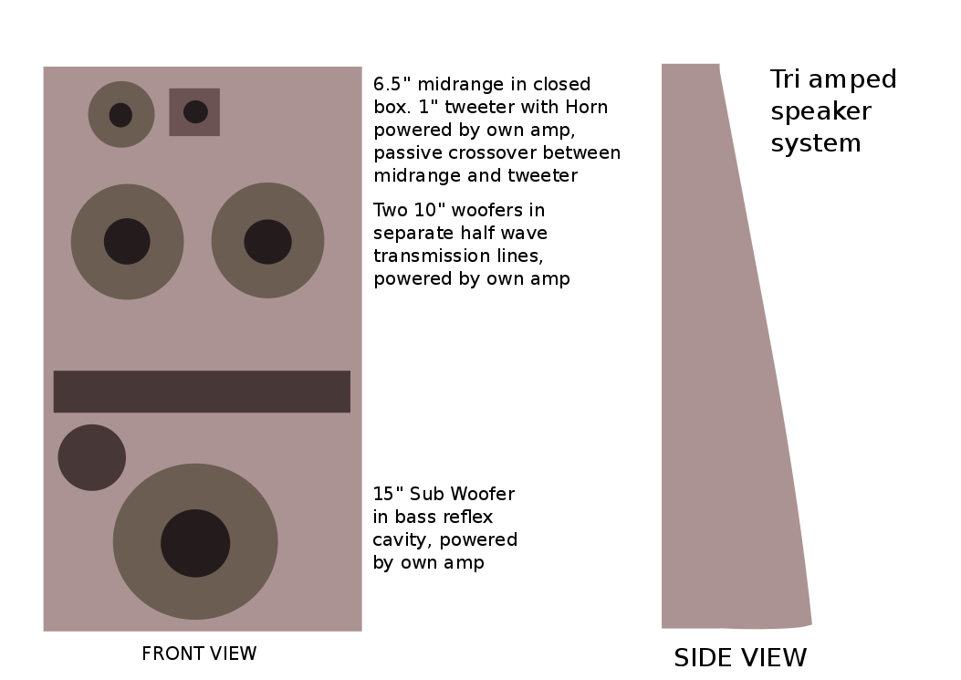

There are many philosophies out there, some are snake oil and some are not, one states that the final mix has vibrations captured by different membranes from different instruments and voices (how good was the copy? we capture not only the instrument but its reverb in 3D space), all this mixed together with or without electronic signals generated by a synth.
These electronic signals are ok while they are electronic signals IMD aside, once the sound specialist is done sculpting a final mix is produced. When its time to reanimate/free these signals at the speaker end as vibrations at the speaker end (how good is this membrane at recreation, will it keep up with the mix which is a collection of possibly a synth and combined vibrations generated by instruments and voices)These vibrations may be more free if released/reanimated on an appropriate membrane and cavity and not forced to exit on one membrane and cavity.
An extreme solution would be to release the signal on a membrane and cavity that resembles the original instrument, thus restoring the liveness/authenticity of the sound, think of the amplifier as the muscle that plays back the instrument for you, here the speaker is a virtualized instrument reanimating the vibrations from the original instrument.(ignoring anything to do with NFB and damping)
Attached is a frequency distribution chart (You may have a different version and some variances, feel free to post what you think is the standard chart) to show what gets reanimated where? http://www.guitarbuilding.org/wp-content/uploads/2014/06/Instrument-Sound-EQ-Chart.pdf
And some shapes for instruments http://www.classroomcapers.co.uk/me...7136e95/m/u/musical_instruments_l-500x500.jpg
