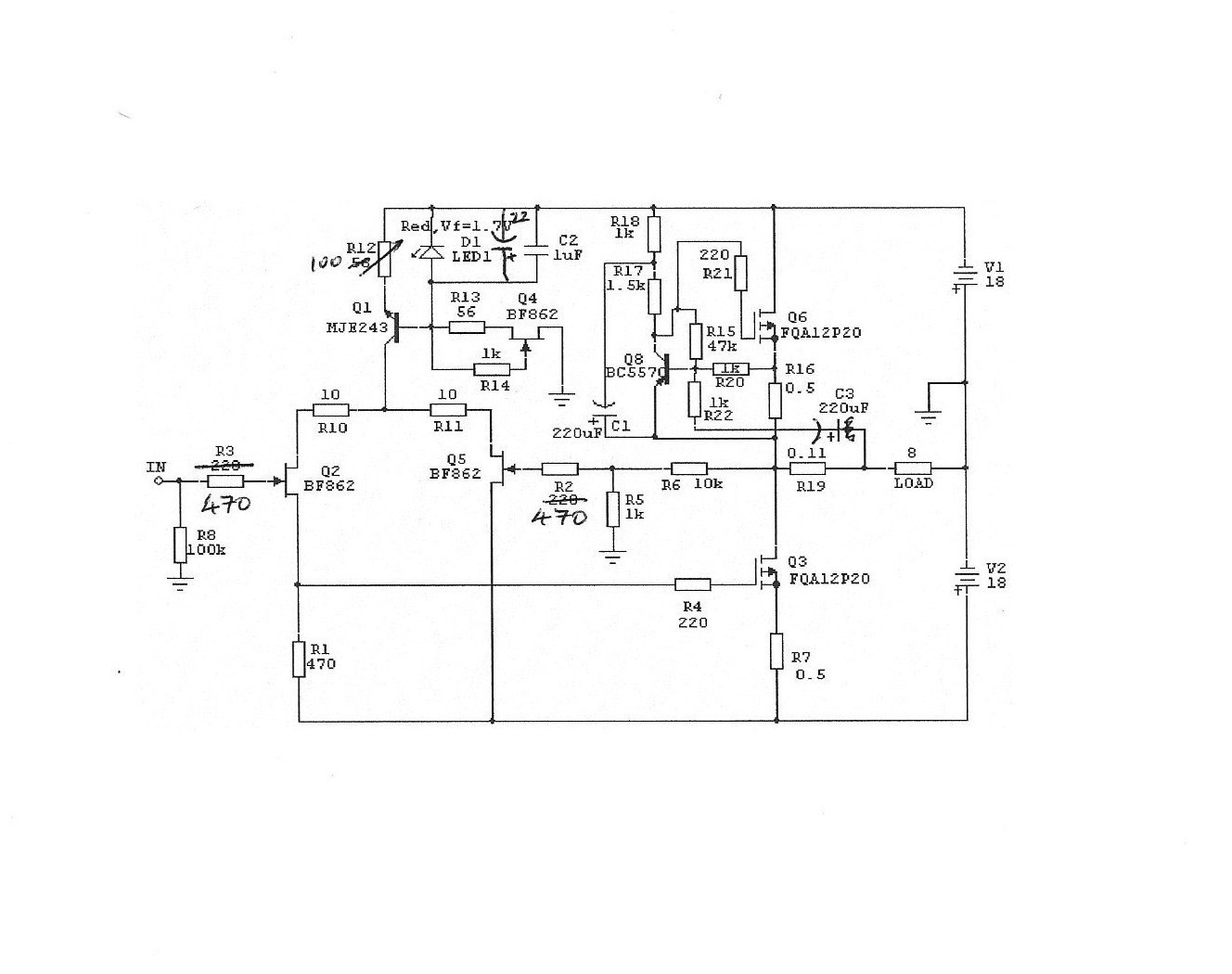

Possible rebuild
juma:
Last night I tracked down a strange noise in on channel, and found that
the little wire heatsinks I put on were pulling the tracks off the pcb. I've fixed the problem temporarily by putting a lighter wire on, but I am considering doing new boards, a little larger, and leaving copper areas on the gates that are large enough to dissipate the heat, so that the wires are not needed. If I decide to do this then I could take the opportunity and change some component values around, if I wished. So since you built the circuit with other values as you write above, closer to Nelson's values for the Aleph-J, I wanted to ask if you felt there was any particular advantage compared to your original circuit.

I've sketched a new layout for the boards, which gives a good more real estate to the gates on the jfets. I haven't written on it which comipoents are which, but the only change from the last one are the obvious big black "heatsink" blocks. Comments?

I wouldn't call it "my" circuit- I just modified well known Aleph-J in order to use BF862 in LTP. Some values used in 1st sch. are adjusted for lower PS voltage (+/-15V or so) but since you moved higher (was it +/-19V?), why not use what Mr. Pass uses - he surely tested them thoroughlyjuma:
....since you built the circuit with other values as you write above, closer to Nelson's values for the Aleph-J, I wanted to ask if you felt there was any particular advantage compared to your original circuit. ....
When it comes to LTP and its' CCS the changes were necessary to accommodate BF862.
Don't worry too much about it, it's OK the way it is now

Looks nice, just be sure to use good quality PCB board (cooler wires or not, tracks that peel off are sign of bad quality/too much messing with the board)

Thanks juma, maybe I'll do something a little closer to the second circuit (the one you built)...
Well, I'm stuck with using the quality of board I can get - I have nothing to compare it with to know whether it's bad or not... Tracks peeling off is probably more due to my messing around with the board than its quality, anyhow...

Here's an update for anyone following this...
I did the new boards, using the design I posted above, doing everything on the PCB from scratch, new jfets, matched them again and so on. I made some changes, specifically, 470R gate resistors on the LTP and a 22uF electrolytic in for C2 (actually in parallel with the 1uF MKT I had in before, so 23uF...), as per the circuit juma built. I was planning on altering the Aleph current source also, but a lack of 68k and 3.3k resistors in my parts box combined with a lack of energy to go out and buy some stopped that...
(juma: How did you choose the value of C2? There's a big difference between 1uF and 22uF, so I guess it can't be critical...)
Everything is back together and working well, without the wire heatsinks at present. I have been following the temperature on the copper patches on the boards, and it looks like the temperature of the gate soldering points stabilises at 60 deg. C. Since the datasheet for the BF862 says that the difference between junction and gate goes up at 200 deg./W, and the jfets are dissipating 190mW, that gives just short of 100 deg. C for junction temp, where the device is "safe" to 150 deg. C. I think this is probably OK, but a little too hot for comfort. Since the copper patches are mechanically much stronger than the traces I had before, I can probably put the wire heatsinks back on if necessary, without repeating the previous problems... but I am unsure whether it is worth it, especially since it makes the boards uglier (not very important) and difficult to manage when making component changes (somewhat more important)... Opinions?
Another small irritation is that the DC offset is "twitchy". When the amp is cold it is quite high (2OOmV or so, dropping fast) and settles to small (jumping around about +/- 10 - 15 mV) when hot. However, when trying to adjust it a very small adjustment in the trimpot makes the DC jump quite a bit, and not always the same way... After a little perserverance and things are OK, but I'd like to understand it better. Do other Aleph versions have this? Is it normal for SE designs? (The other amps I have done are all symmetrical designs like the F5). Is it possible that having different values for R7 and R16 makes this worse?
I also have a thump on turning the amp off (but not turning it on...) Watching this on a voltmeter shows about 1.2 Vdc coming through as a transient. It doesn't seem bad enough to damage the speakers I have at present, but might be an issue if I upgrade to something fancier.

solder some U shaped pieces of Cu tin on these big cooling islands - to keep temp down ...
then you'll see ( if you succeed in cooling down these little jfets ) are these offset troubles induced with too much of thermal difference from cold to hot in LTP , or in CCS which is feeding LTP

Well, things here are not so good...
Last night I cut out a couple of U shapes out of Cu sheet and tried to solder them on to the PCBs as ZM suggested. This was completely hopeless. I am sure the problem is the same as when juma suggested the fins - the little 25W soldering iron just wont heat the Cu and solder quickly enough, since the Cu dissipates the heat too quickly. My big soldering iron is a 120W monster with a round tip about 8mm in diameter, so it would be very difficult to use this on a tiny SMD PCB without destroying the components, so I gave up on the U shapes and went back to the wiggly-wire shapes. With the big Cu areas on the PCB to use it wasn't too hard to get five of the wires on each board, so I closed everything back up and went to see how it worked.
It's quite hard to get the probe very close to the gates with the wires mounted, but it appears that the gates get to 46-48 deg C. instead of the 60 deg C. they reached before, which is fine. However the amp is now distorting - the same odd distortion it did before, which is very odd indeed.... In post 68 the problem apparently was caused by changing power resistors in the Aleph current source; the problem in post 84 was bad contacts on the BF862s since a track was coming off the (old) PCB.....
This time I don't know what it is yet, but what these problems all have in common is that they happen when I have messed around with things...
In this case I am getting noise/distortion in either channel, which is even audible when the volume on that channel is zero. Note that this definitely didn't happen before I started playing with soldering Cu onto the PCB...
Here's some things I've observed.
1. It happens with two different preamps, and with two different DACs, so it's definitely the amp causing the problem.
2. It still happens when one heatsink is pulled off and placed farther from the other, so it isn't caused by one channel "picking up the other" inside the amp.
3. Listening to piano music (which is when it is most obvious) it varies with the volume; as the player hits the keys harder, you can hear the distortion. (And as I said above, you can hear it in the left channel, for instance, even when balance is all to the right).
Here's some questions.
1. Is there anything in this circuit that could be microphonic under normal operating conditions? (The answer surely should be no...)
2. Is there anything in the circuit that could be microphonic if damaged? (Perhaps by heat, from ham-fisted attempts to solder Cu sheet?)
3. How hard is it to damage SMD jfets through soldering heat? (I am presuming that the resistors are perfectly safe...)
I have also considered the possibility that soldering the Cu loosened one of the jfet soldering points, causing a dry joint (somehow...) I can redo all those joints without too much trouble, but somehow I doubt this is the problem.
Well, I'd be very grateful for any advice here...

you still have one jfet "reversed" ?
Yes, do you think that might be the problem? (It was OK before I messed things around...)
you must have same value resistors for R16 and R7 !
Well, I must have misunderstood something juma wrote, then... I thought I had queried this point.. I can certainly fix that...
Meanwhile:
give me voltages across :
R16
R7
R10
R11
R13
With input shorted, I used two DMMs to measure the voltages on the left channel. (Do you need values on the right also?)
R16: 0.571 0.568
R7: 0.476 0.475
R10: 0.103 0.104
R11: 0.108 0.109
R13: 0.394 0.394
The only thing I note is the differences for R10 and R11 - I realise current should be equal, so since these are 1% resistors these voltages should be closer to each other than that.... right?
Nigel
first make these output source resistors equal , then reset offset and bias
it will help if you put trimpot instead R15 - for fine bias adjustment
everything else looks good - even these voltages across jfet source resistors are well in tolerances
