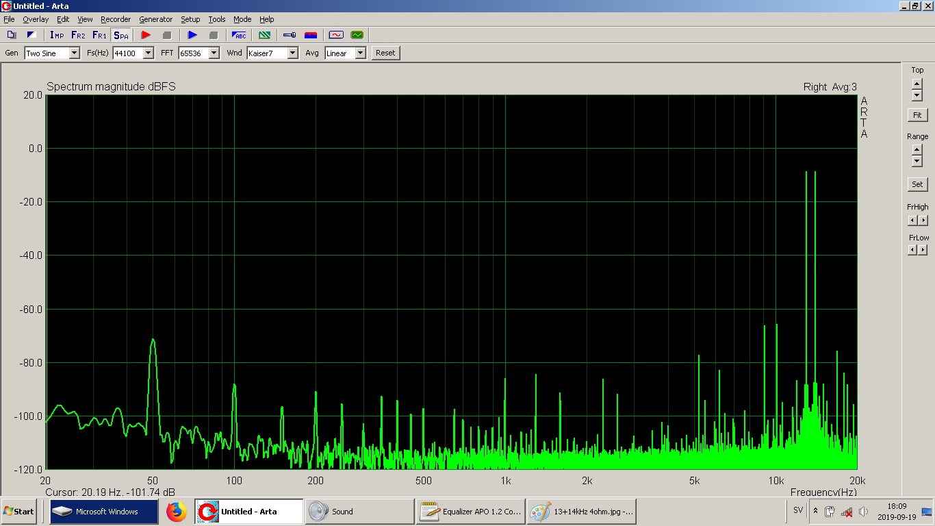

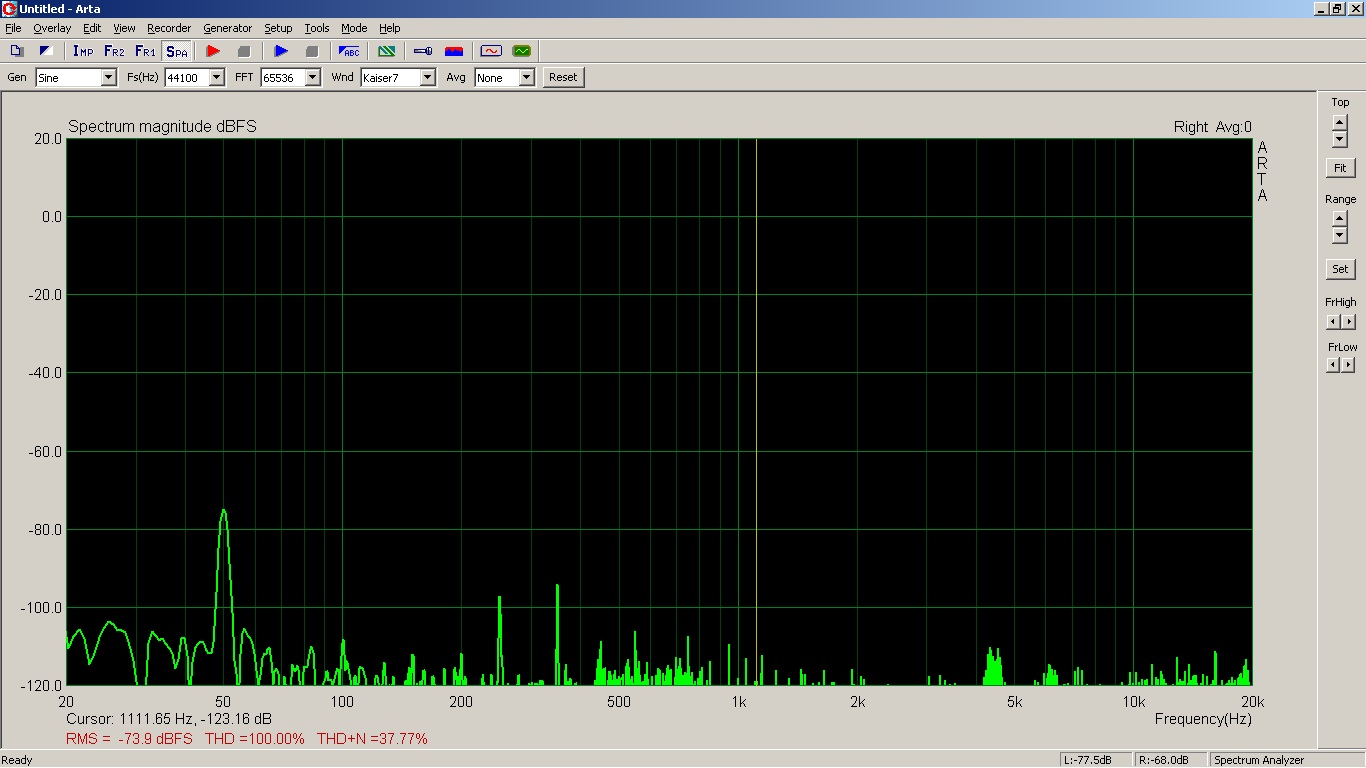

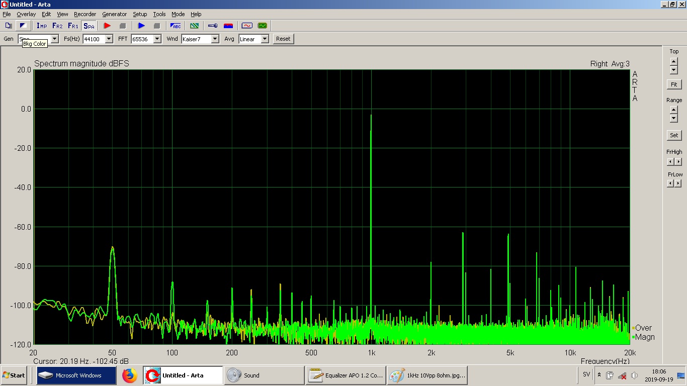

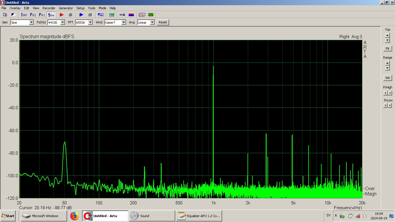

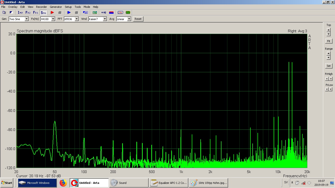

Distortion measurements LJM L15d-Pro
I took some distortion measurements and screenshots, so this is what I'm seeing, and possibly hearing? :(
See the filenames for details. The IMD measurements are taken with the same amplitude setting as the 20Vpp. I did not even bother to get a better sound card, since distortion is clearly visible even with the Behringer UCA222.
I tried adjusting the switching frequency with fft running, but saw absolutely no difference. Now it's around 400/425kHz per channel.
The screenshots don`t look that bad. Usual 50Hz noise. Maybe you could post some pictures of installation, power supply etc.

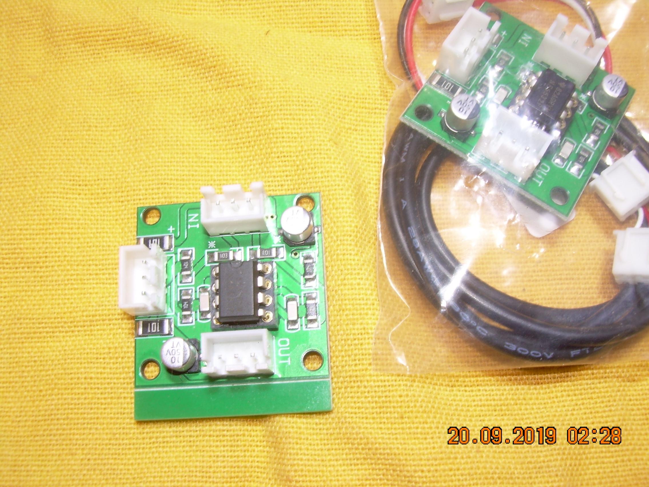

Many amps profit from a simple buffer, NE5532 will do, not to have one might be a "no go", as many amp´s input stages are extremely simplified.
There are many small, cheap PCB´s at eBay, Ali etc. that can be soldered directly at the input RCA. Change the OP amp for a real NE5532, as these are usually fake.
The pictured one is inverting (no problem) and has gain of 10x (has to be changed to 1x) Less than 2 Euro, you do not make the PCB for that money.

I don't worry about the 50Hz in the measurements, it's 'EMC problems' in my measurement setup/garage. However I'm not so impressed with all the spikes from harmonics in the measurements.

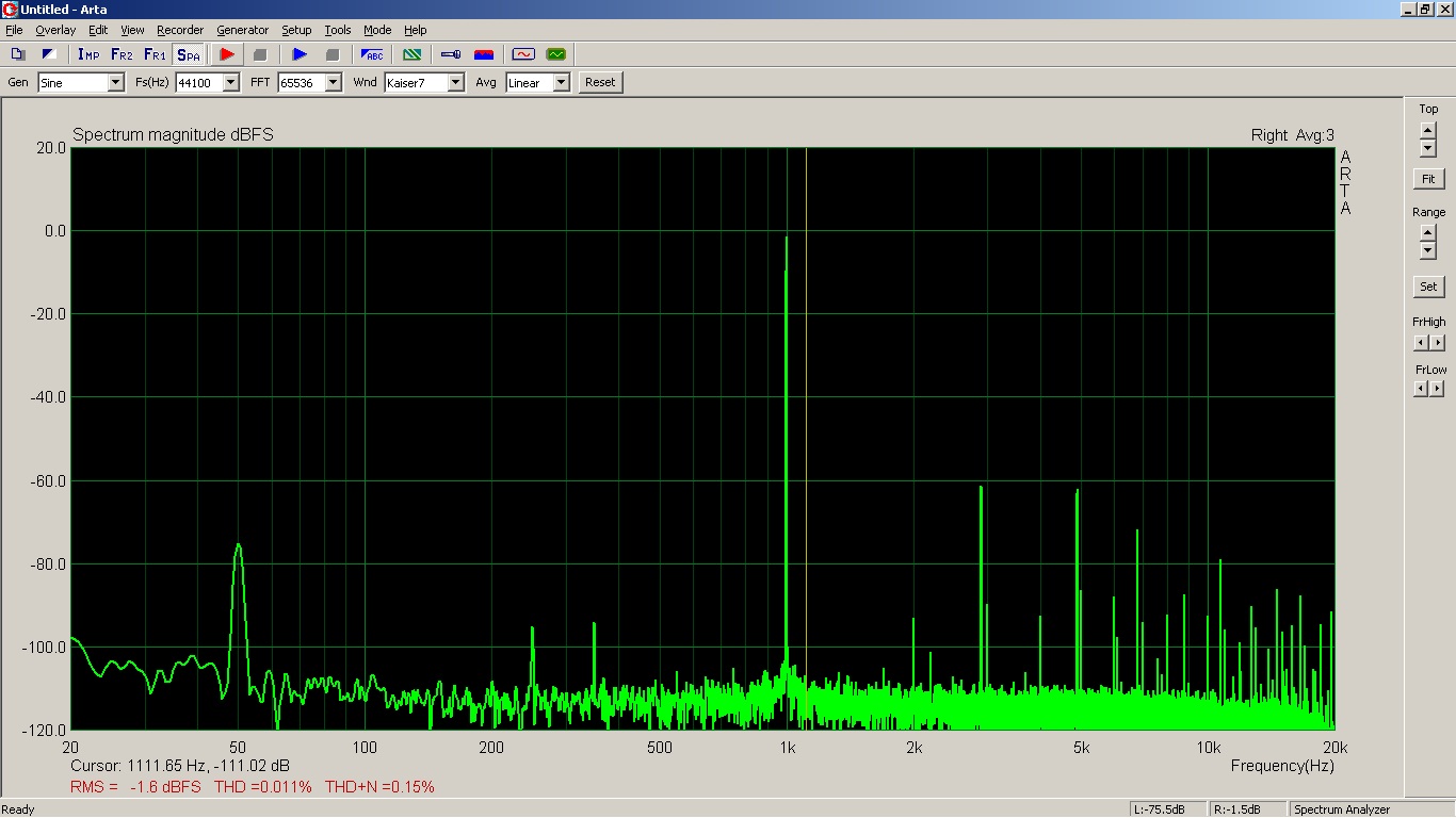

First I would like to 'cancel' my measurement results above! I redid the measurements with a better sound card, and now they look 'normal' and not so bad. Noise floor from the amp is a bit high though. I did not remember that the Behringer sound card was actually that bad for amp distortion measurements, I often use if for measuring speakers, and it's ok for that.
I also measured frequency response to 8 & 4 ohm. At 8ohm it's slightly peaking at 20kHz, and at 4ohm sligtly falling. Around 3dB differance between the two at 20kHz, no differance at 10kHz.

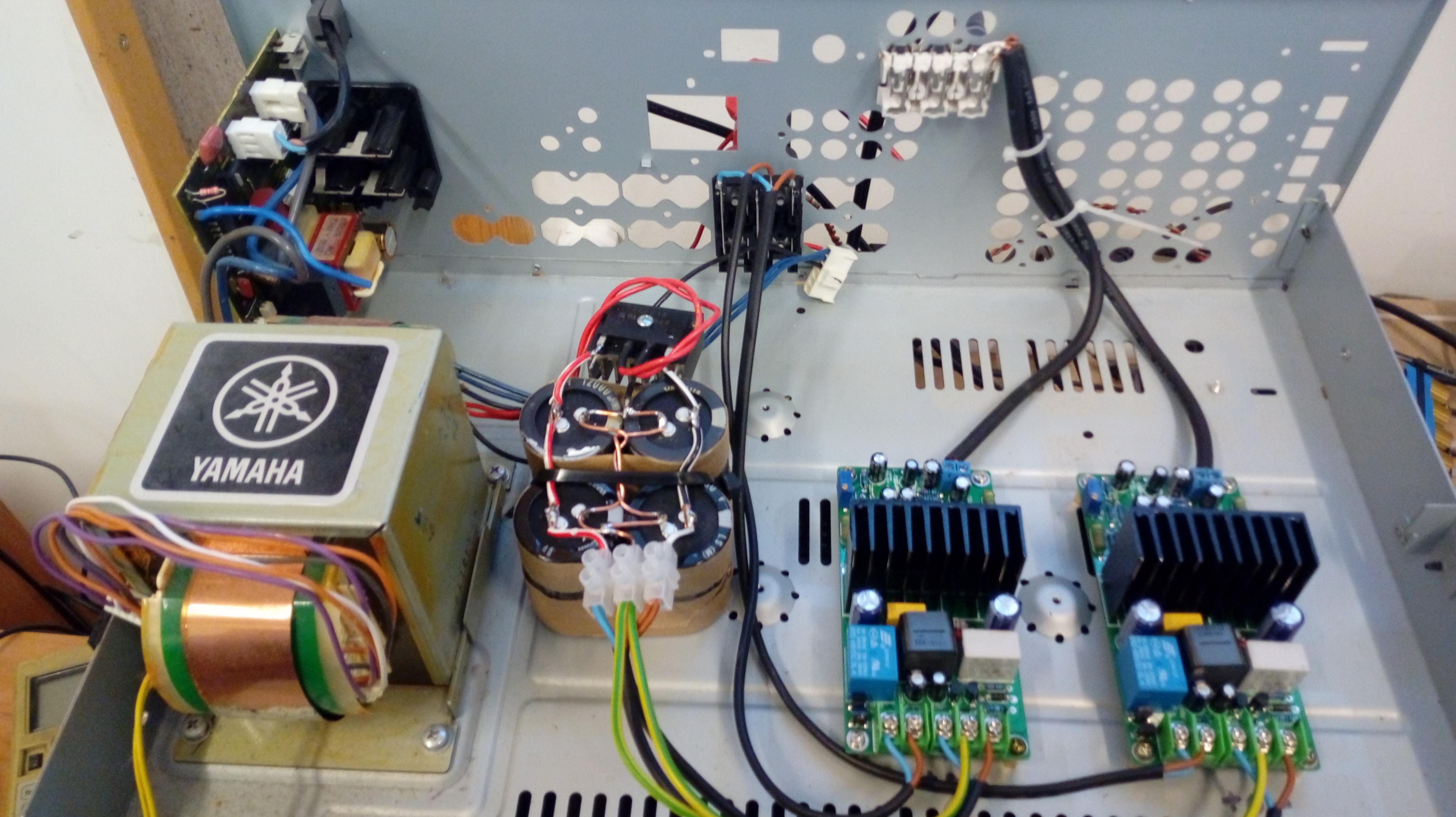

Picture of test setup attached as requested

Your test set up looks fine, but for a final installation I would take solid core (like your yellow/green), 3 for the power and 2 for speaker wires, in different colors. A wireless drill will turn them neatly together in no time. This will lower noise and radiation significantly at hardly no cost. I remove the outer insulation of 5x power line installation cable to harvest this "high end" material
Yes, for sure if I intend to use them in a 'permanent setup' I will use twisted for power and speaker cables. I tend to do that even with solid state amps.
