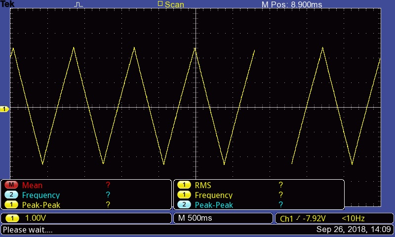

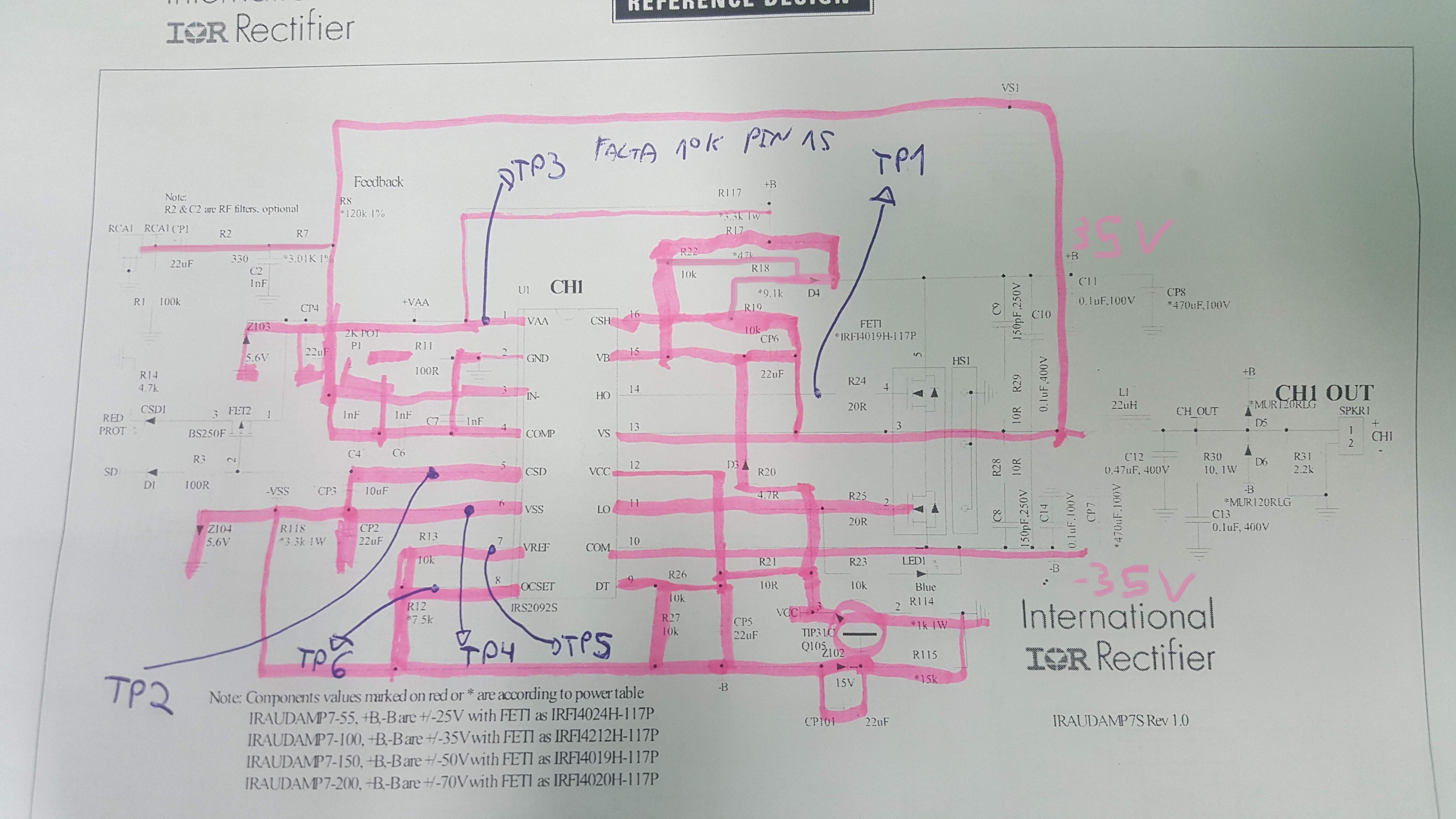

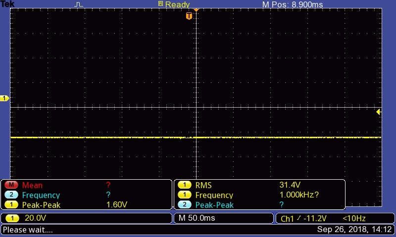

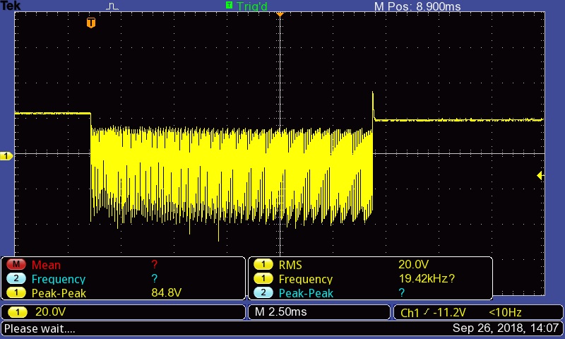

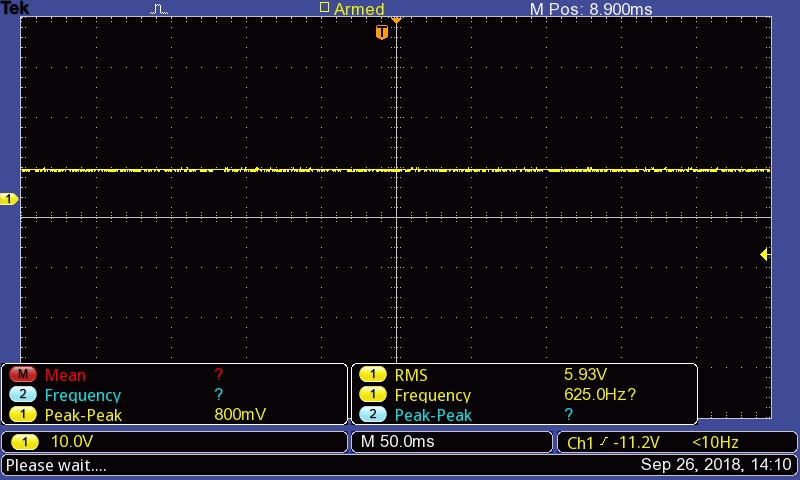

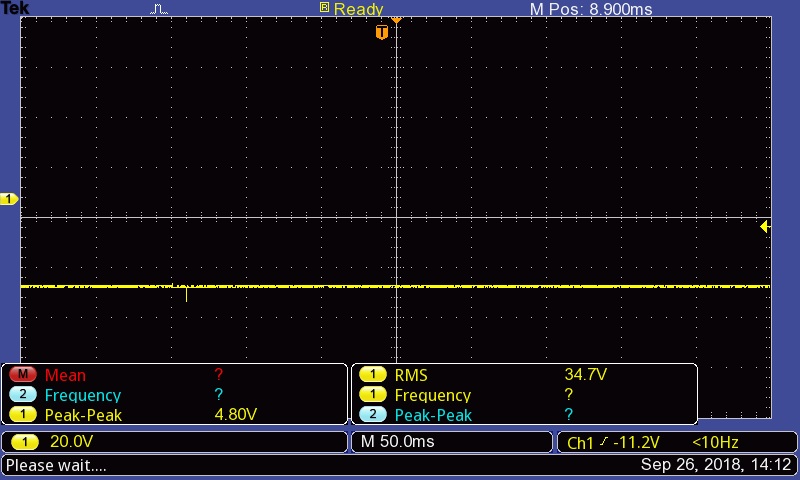

I'm really wanting to build a class d amplifier but it's not working. I set up this scheme.
and it does not work, does anyone have any that works or could you give me a help thanks.
Did you copy exactly the iraudamp7 and pcb layout ?
The irs2092 is very fussy about pcb layout, decoupling and over current settings.
Are power supplies ok to the 2092 ?
Does it oscillate ?
Don't use it without a load as sometimes they can just sit with output at +17VDC ! or ring like mad and blow up output capacitor.
What's in pink I rode. To see if there is mosfets switching.
Also the photos of the tps that are marking in the scheme.

I made a post with the part of the scheme that I set up to see if it works and so far the post was not. I'll cuddle a little and see if the post will go.
I realized with the circuit connected that the 35 + 35V fans will go to 49V when I put my finger on the audio input of the amplifier. should make the characteristic snore of 60hz plus he makes cracks in so many seconds. and do not have the pwm fixed on the gates of the mosfets.

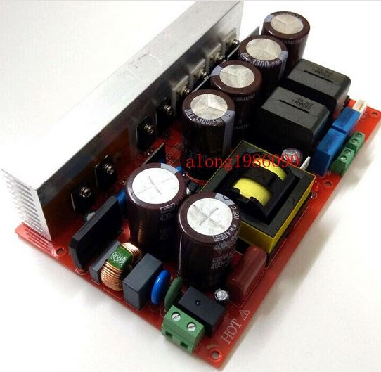

This product is designed in strict accordance with the high-fidelity line planning. The distortion is very low. Strong driving ability. Low frequency dive. Not turbid. The sound field is wide. The medium and high frequency is clear and natural. Rich in details.
It looks very compact with 2 amplifiers and a SMPS.
With such a great description who could resist !
