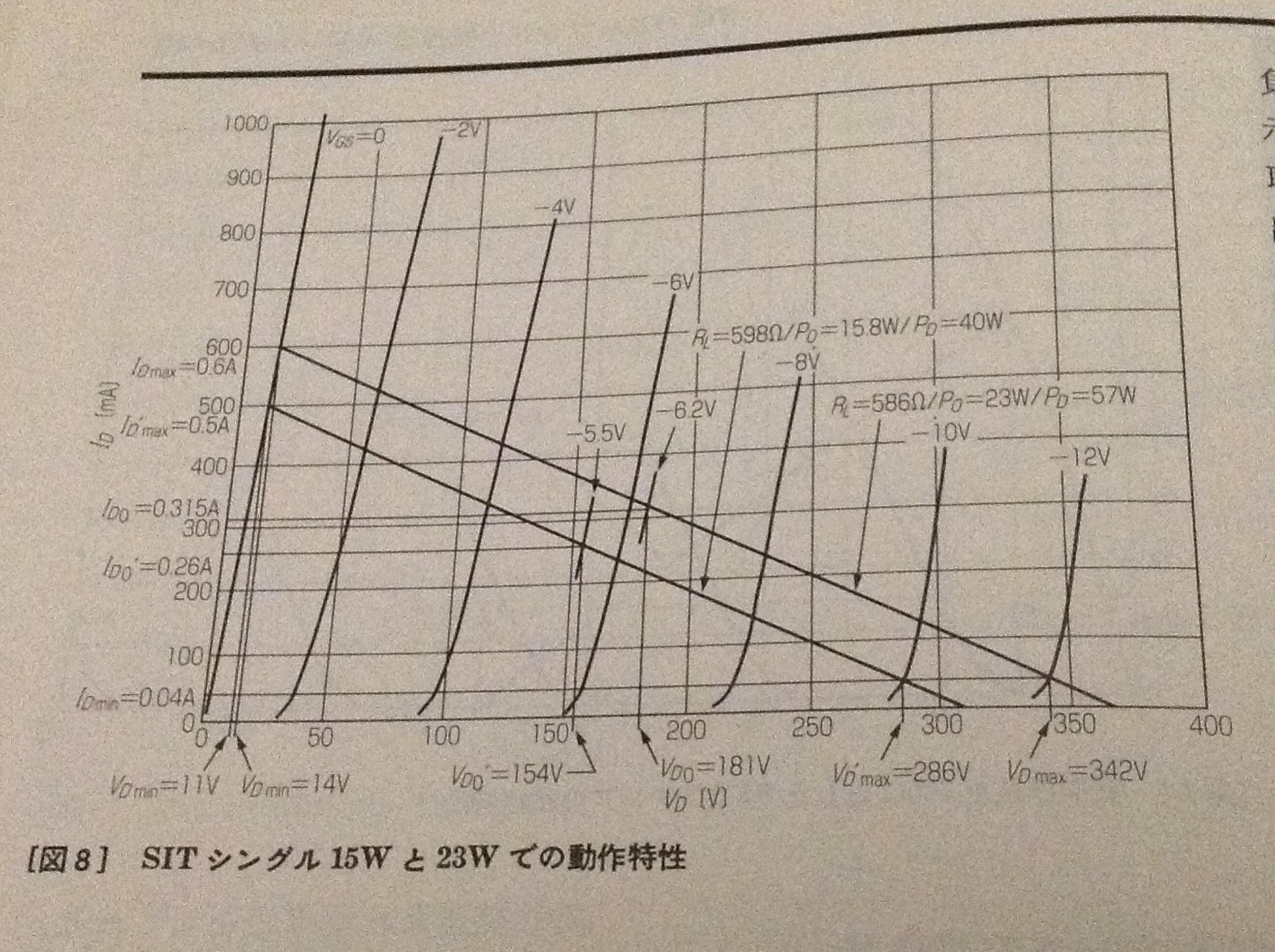

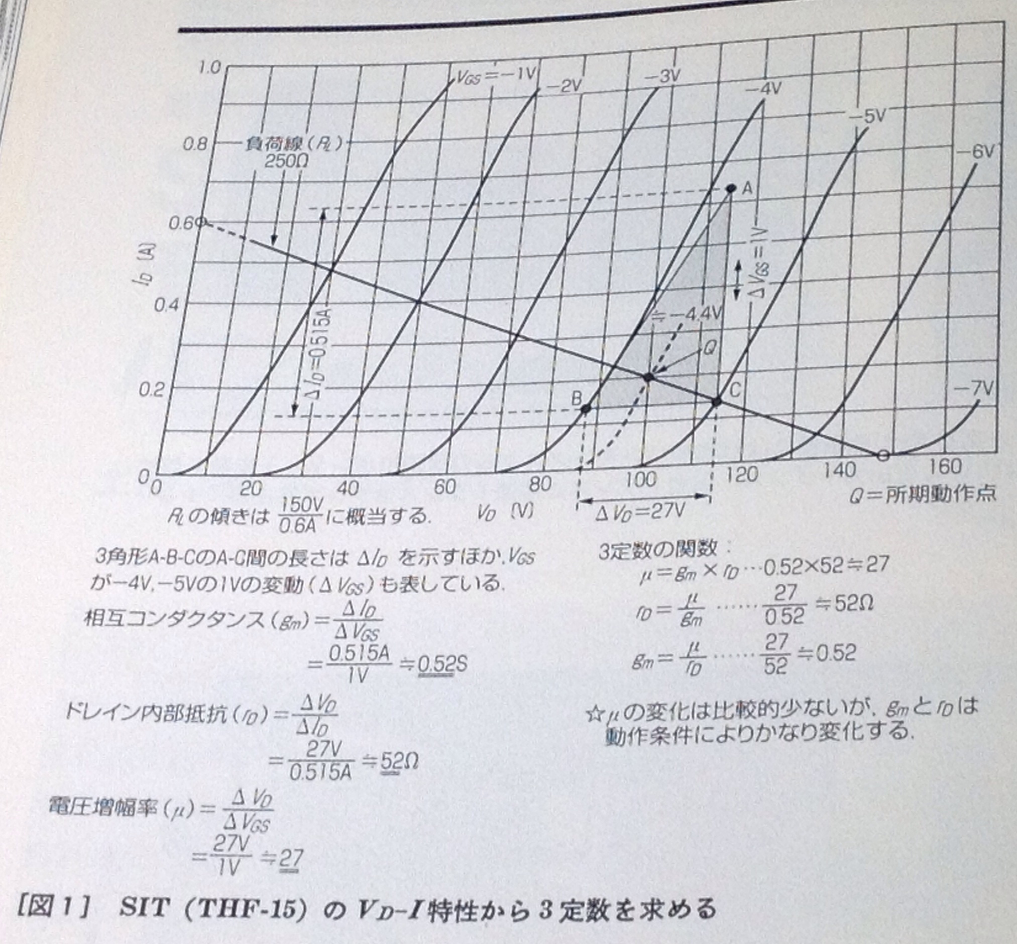

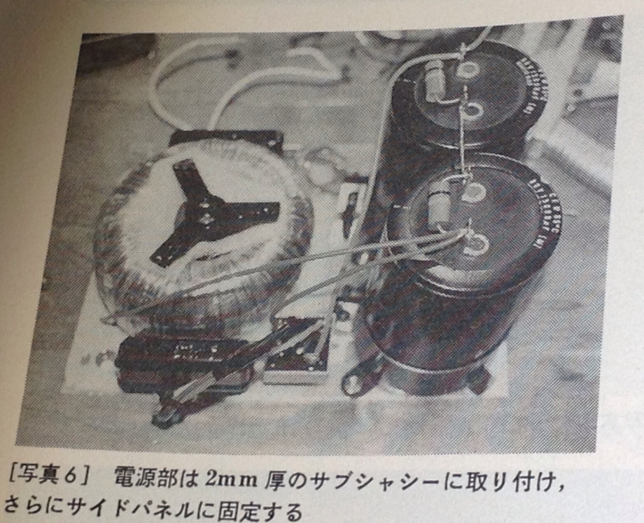

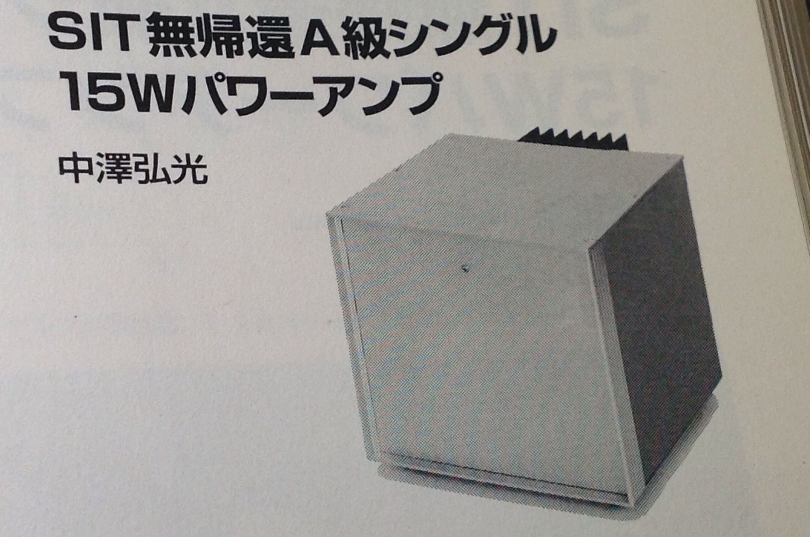

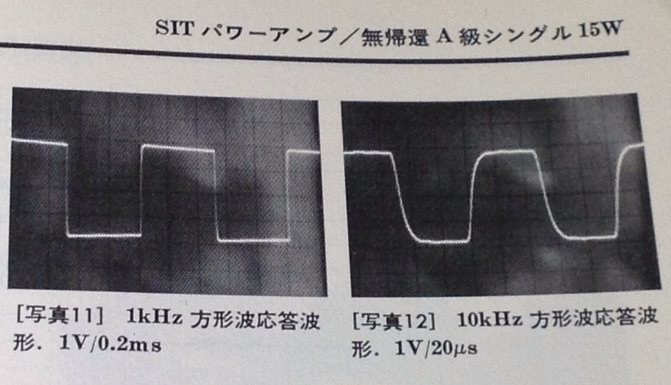

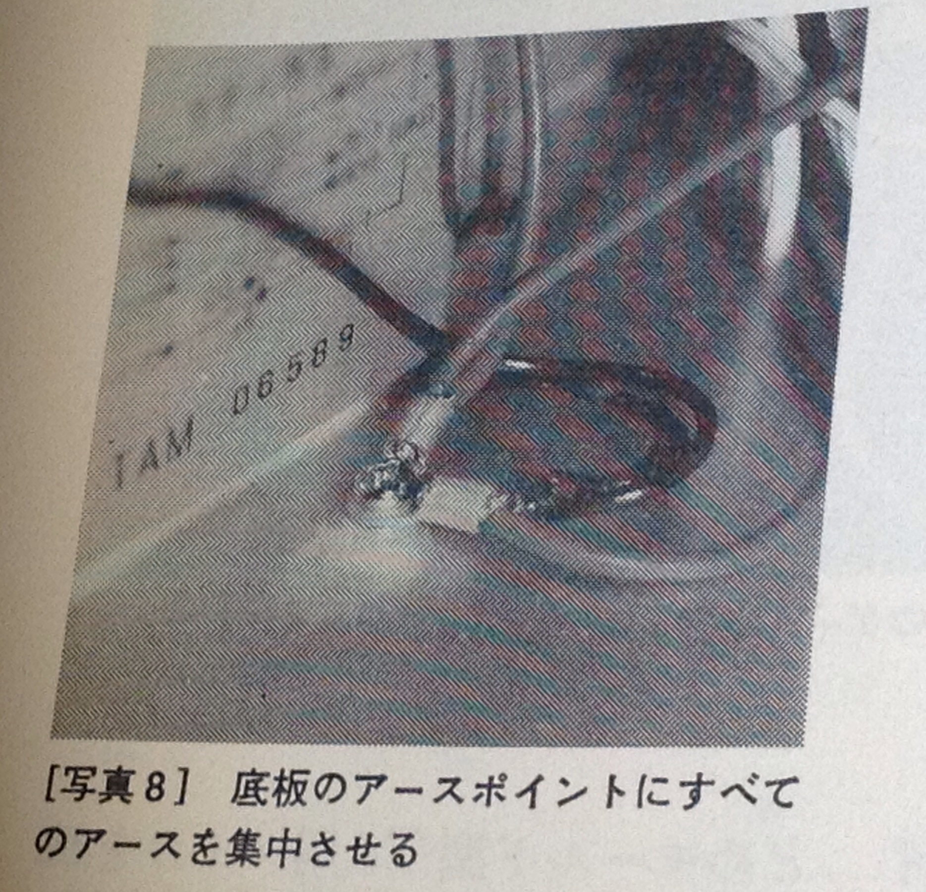

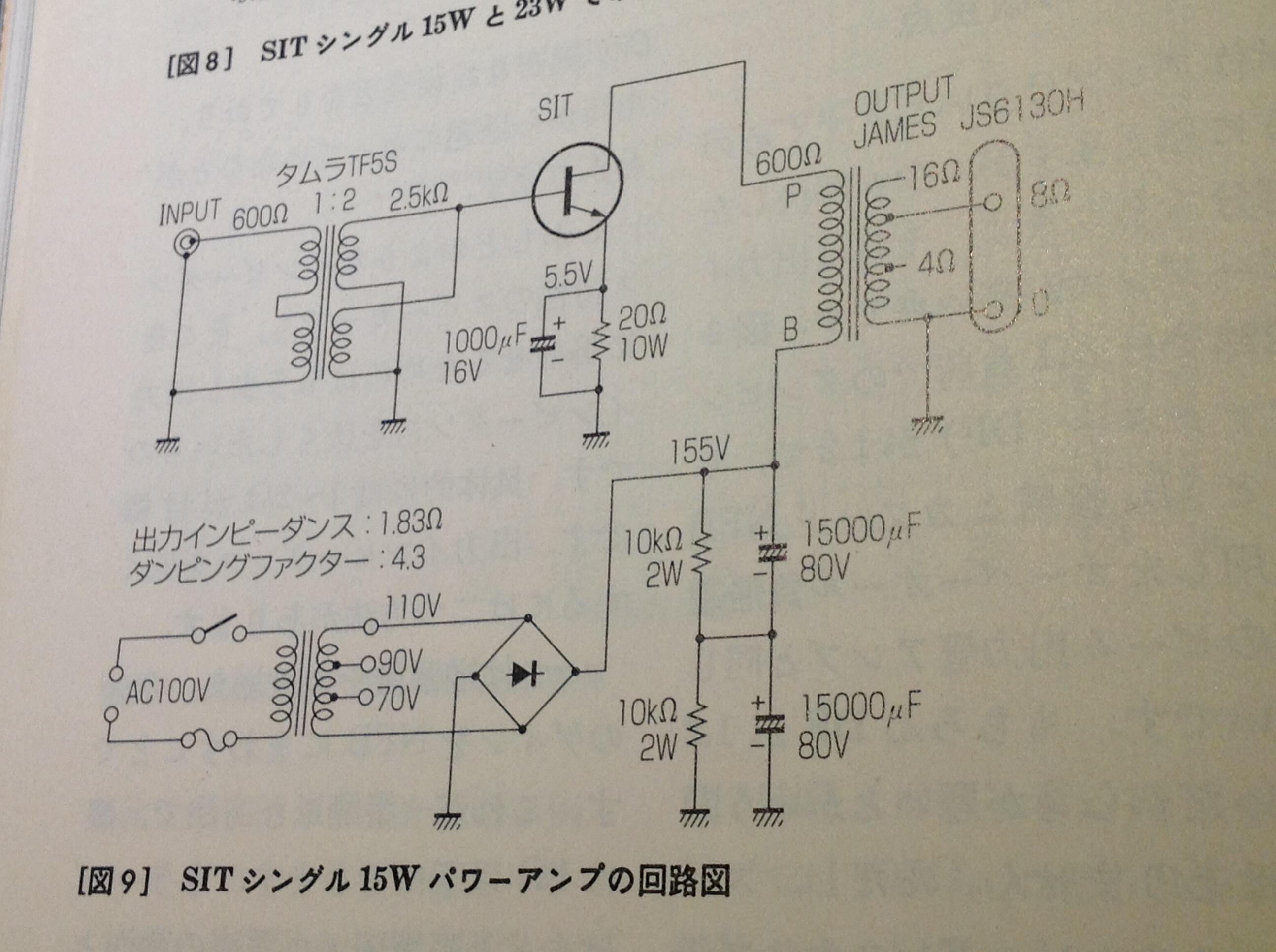

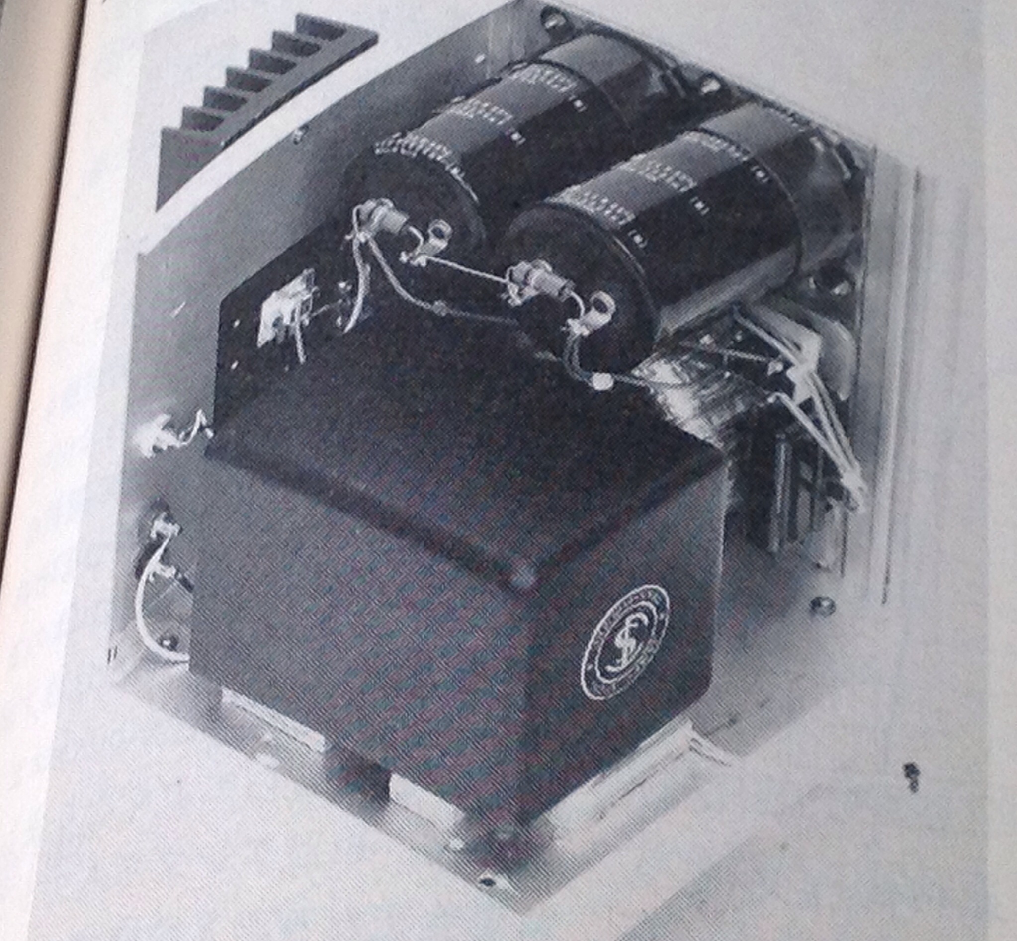

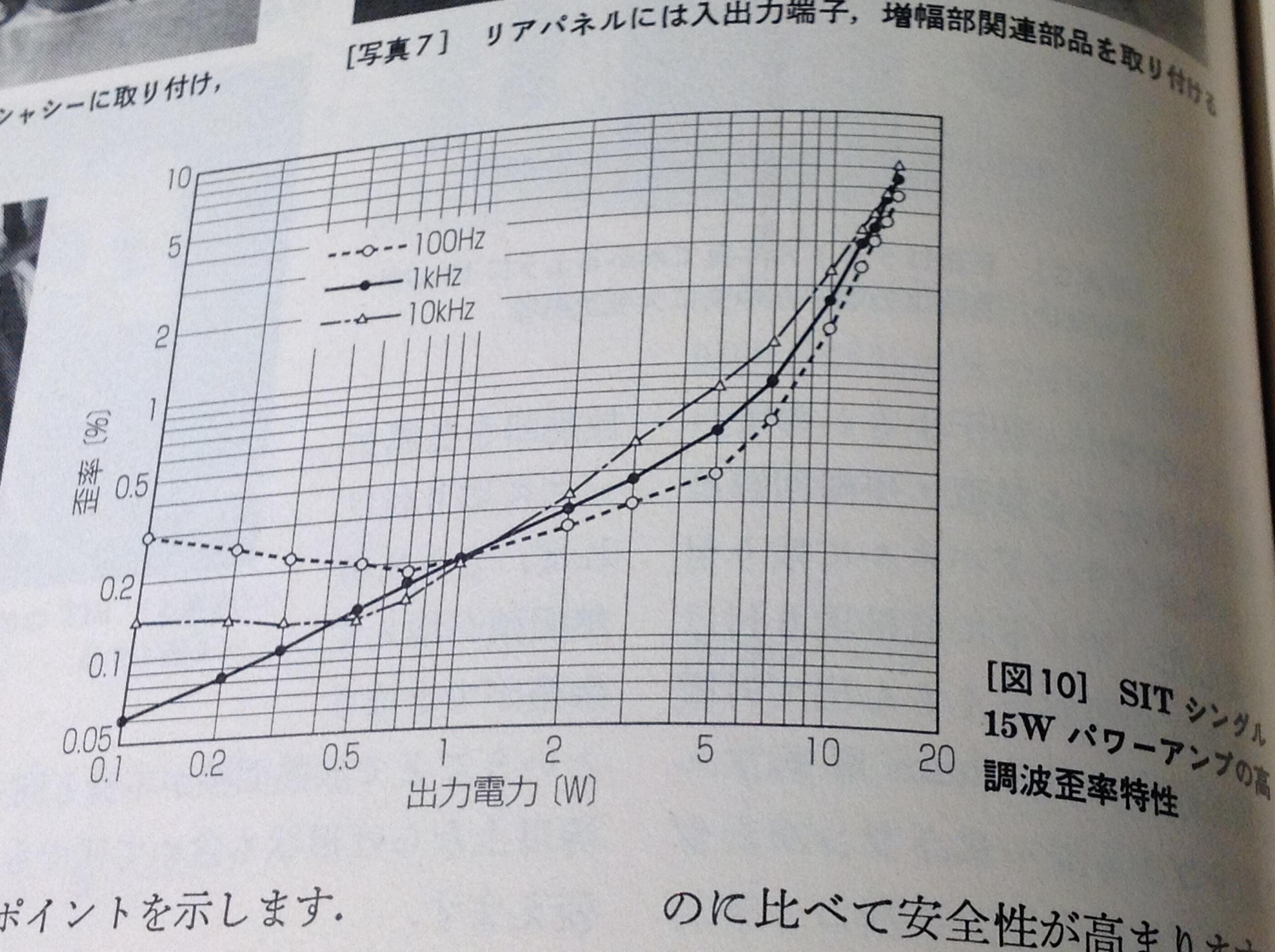

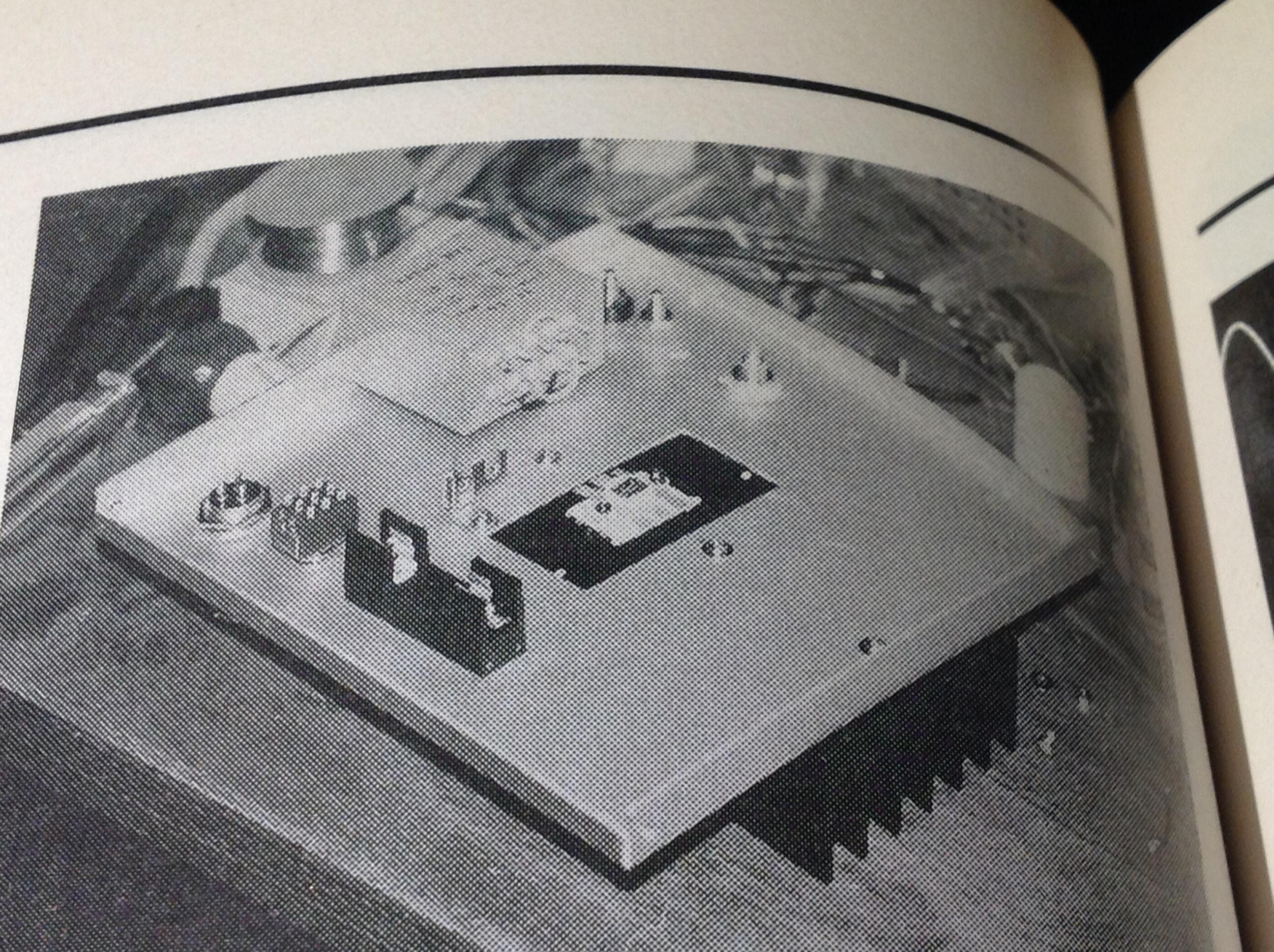

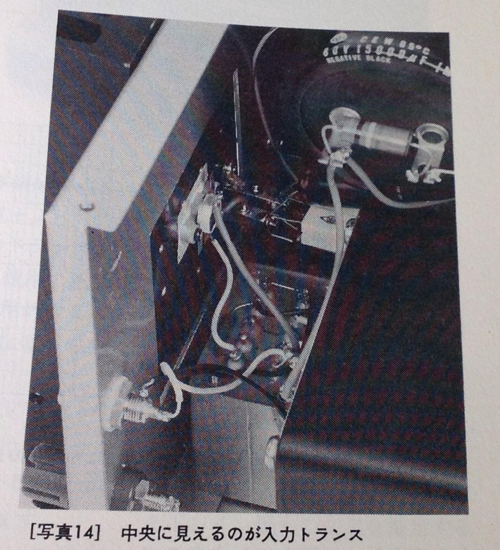

@ Diyers
Last findings about similar to Ironamp but from Japan Nakazawa Hiromitsu San who use THF-15 Tokin
More construction details

move chokes further from tone xformers
Thanks! I will....
