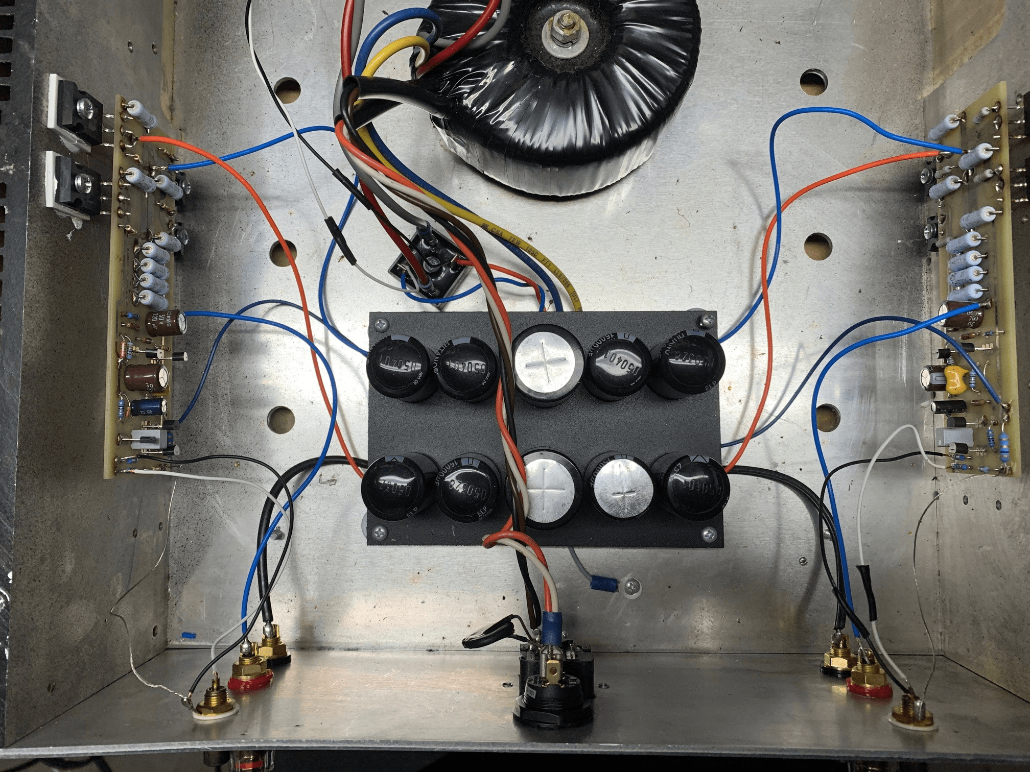

After a short hiatus I finally picked up the soldering iron again and made some progress.
For M102 / M202 I used IFR510 mosfets which according to the schematic. After installing then I began to wonder why I had some IFR540 mosfets in my parts bin for the IP. I then realized that the BOM for my version of the IP has the IFR540 for M102 / M202. Based on post #154 I assume that I am good if I leave the IFR510 mosfets in those positions.
