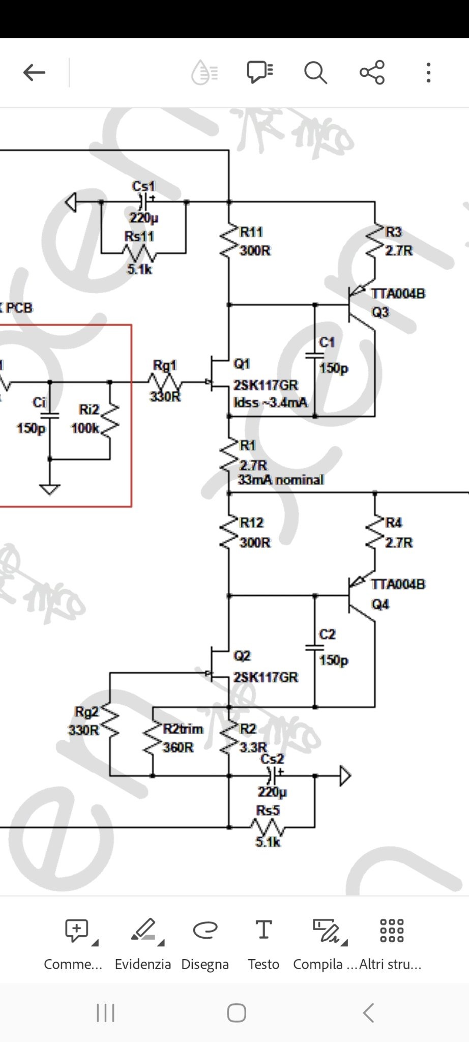

Hi! I have been reading up on the Iron Pumpkin, it seems like a great project! I have read different numbers of the input impedance, maybe with earlier / later iterations. I might have missed something in my reading quest. What would the input impedance of this vegetable animal be (roughly)? I would use it between my 250 ohm (30V) tubed phono pre and a DAC and a FW SIT 3 or 300b tube amplifiers.

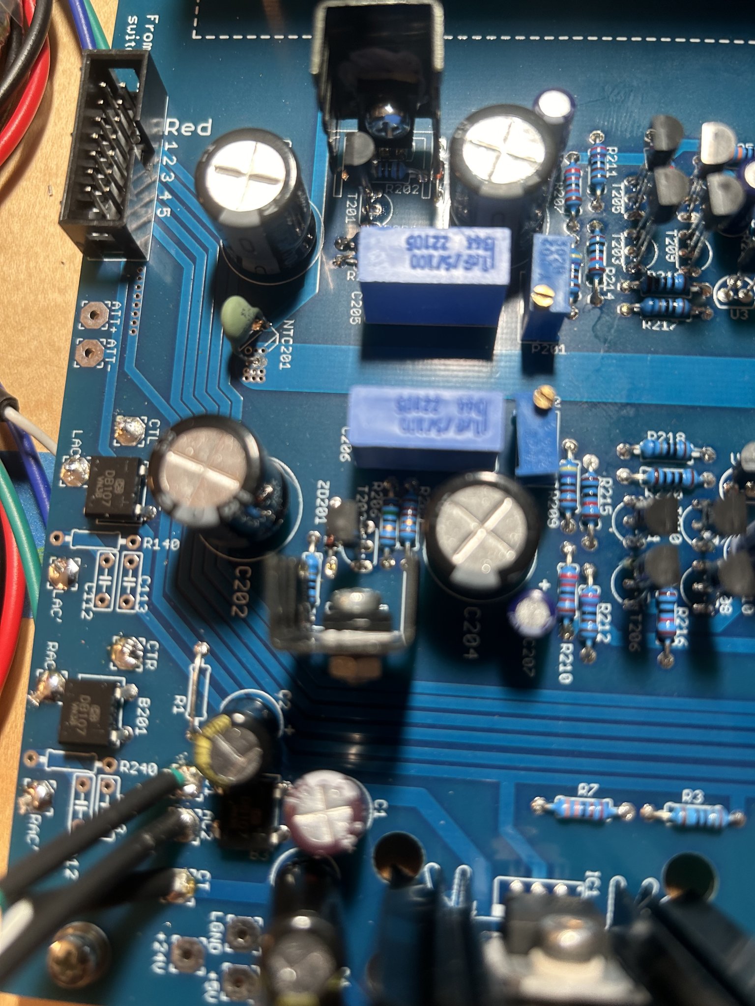

Quazi adapter for CT xformers. More than likely overkill but gives practice.

Rin is practically value of shunt resistor going from gate of input JFet to gnd
default 100K, can be altered to 220K with no worries ...... except worries about interconnect cable capacitances
:spin:
tnx to your remarks, I realized that I made omission with snubber arrangement
already edited for future IP Motherboards
again, not of much importance having snubbers, in this case
but, again, we like overkill

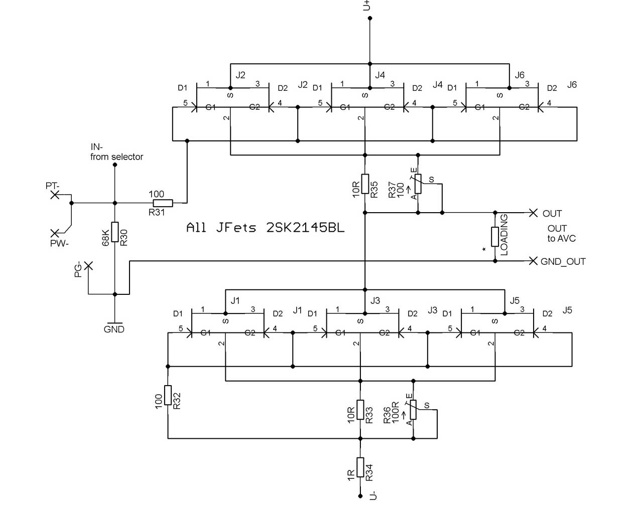

maybe a stupid question, but can the amount of gain influence the sound quality of the whole system depending on which power amp is used? I find for example that this vegetable, used with the M2x, sounds better with 8 dB gain than with just 2 dB, at the same volume, of course.

I believe that you can find complete measurements published in one of threads, done with AP One by my friend
There is difference of course, THD being higher with higher gain setting but - that difference being so small that I believe what you're hearing is not effect of Iron Pumpkin gain setting but rather difference in amp you're using
In fact, I don't believe that, I'm damn certain

in that case, you're able to hear diminutive increase in THD, and you like it
besides playing with gain setting, there is funny (shunt) resistor position on buffer output, designated "LOADING"
its role being exactly that - if you want some Sugar, introduce appropriate valued resistor there and stop changing value when you're happiest
use 1pin sockets, so easy to change
start with 2K2 and go down
leave gain setting where appropriate for system

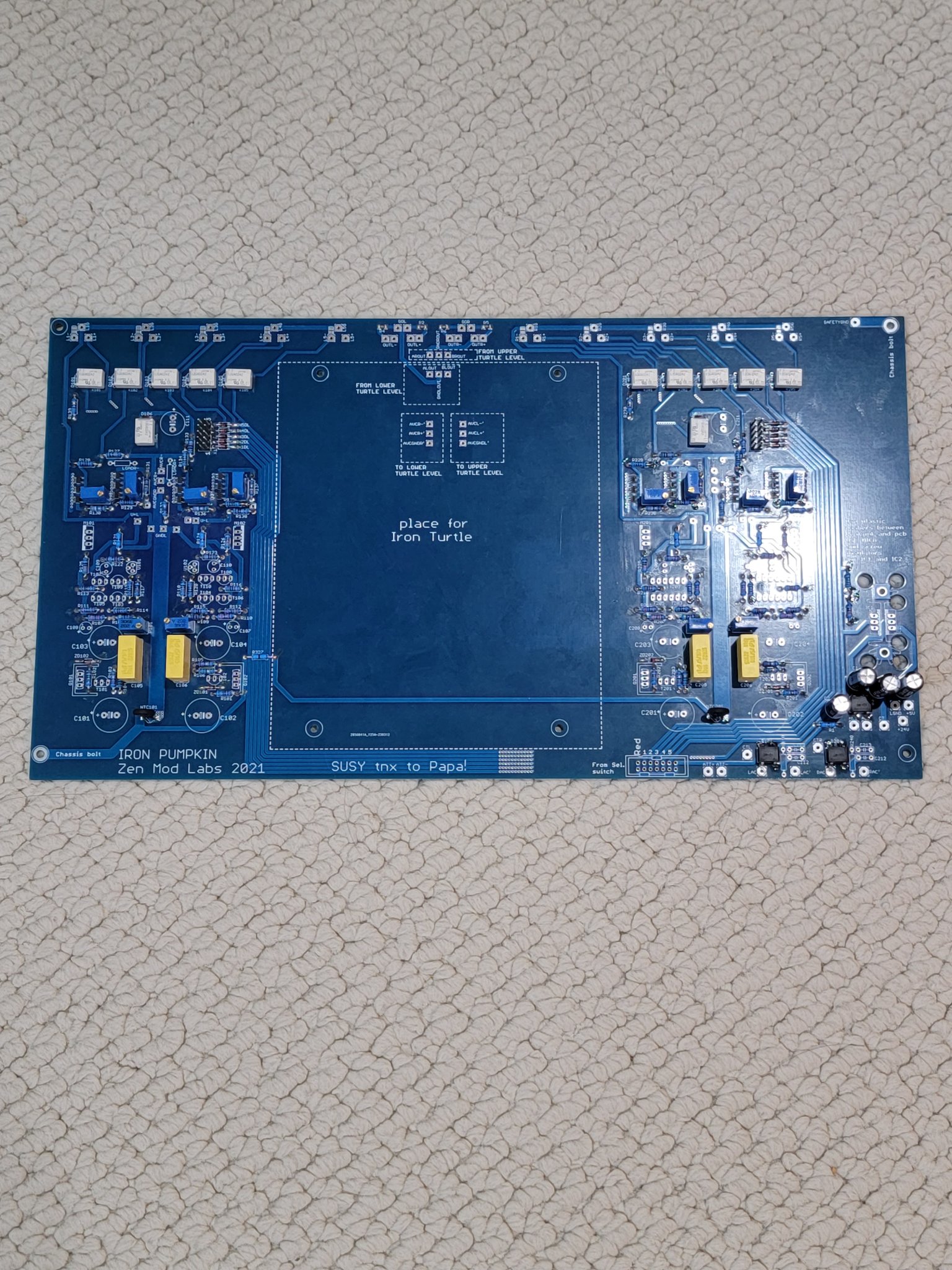

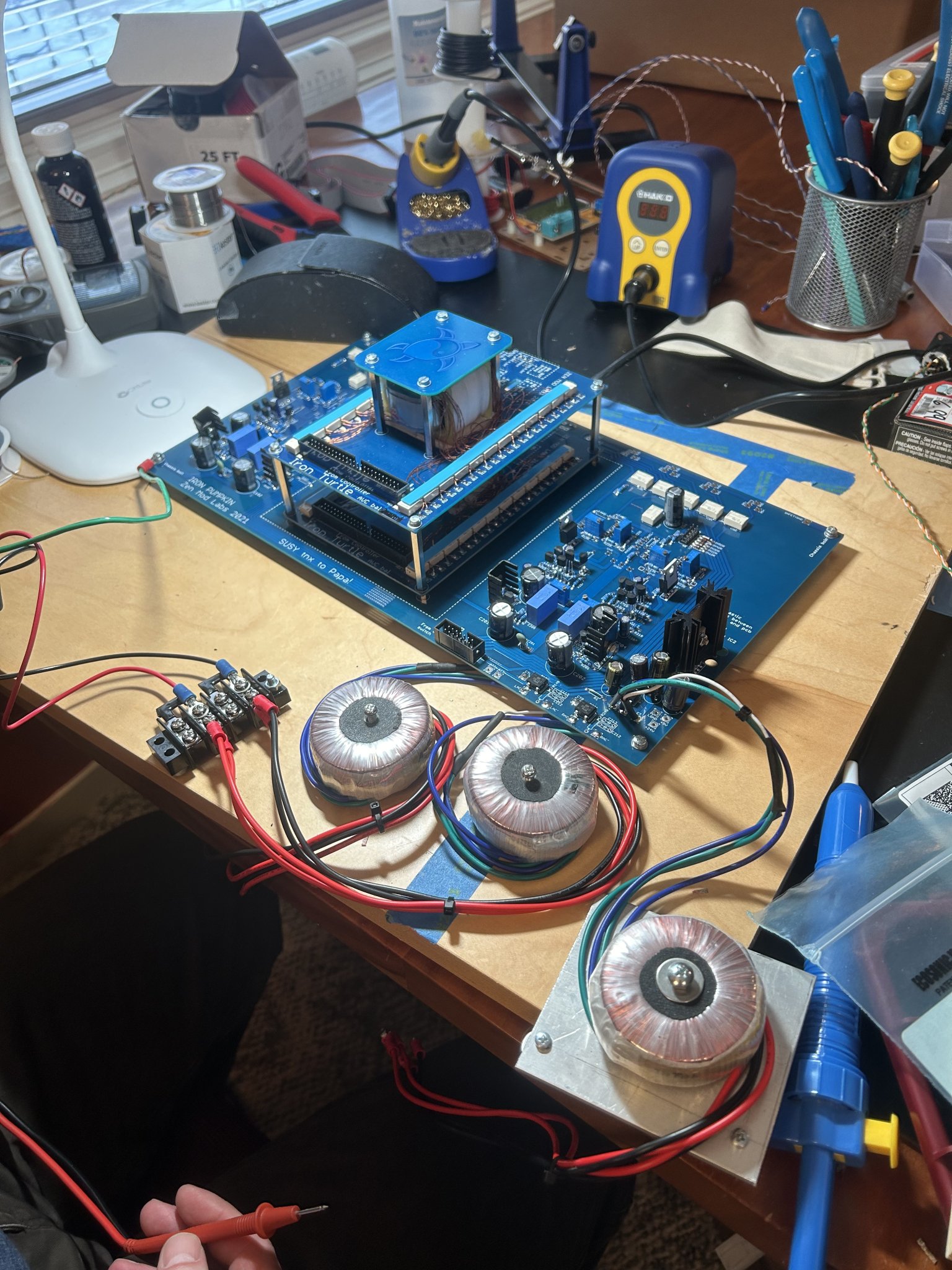

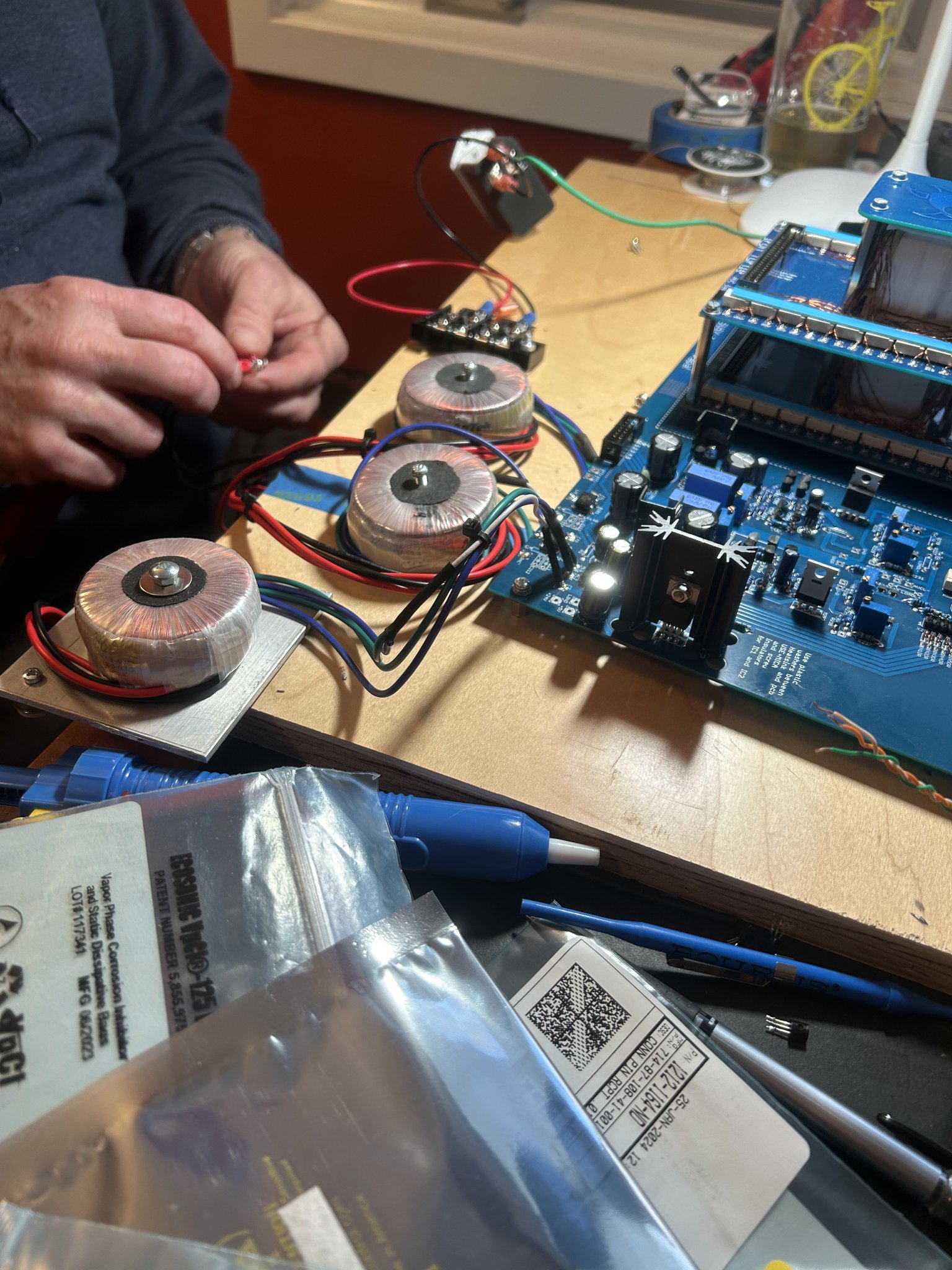

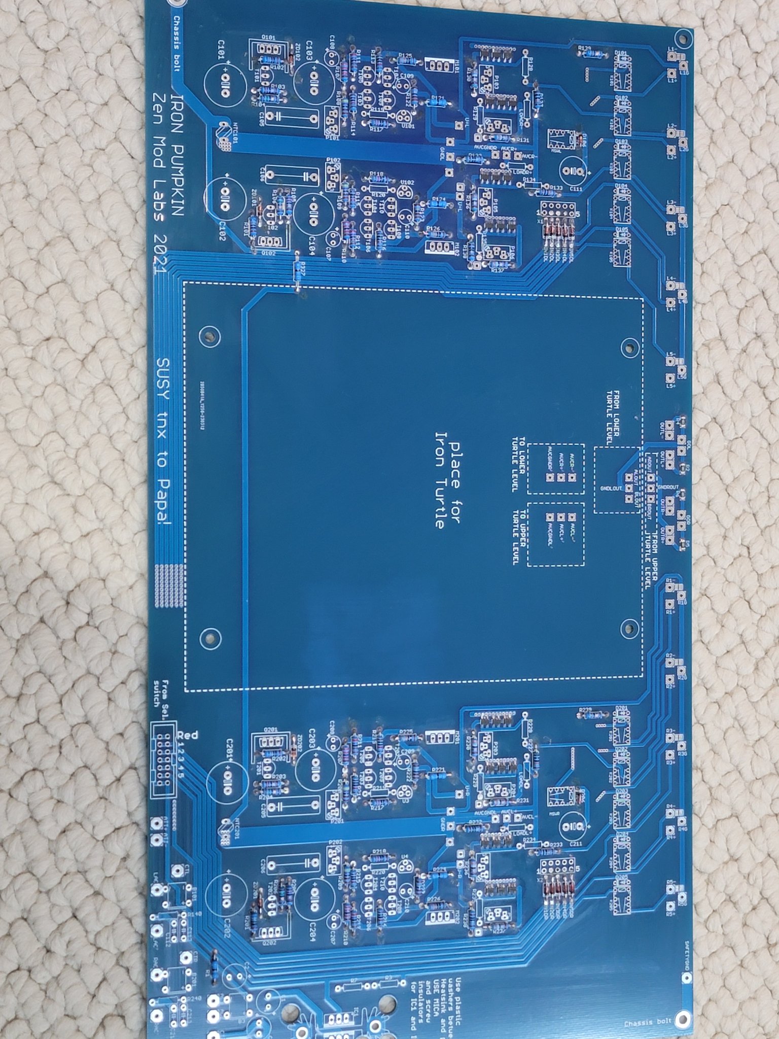

Joined 2007
I enjoyed going "hands on" with an Iron Pumpkin today. Even when my job was just to steady the board while @timkrone soldered some of TO-92 critters home. This has now forced me to actually read about the Pumpkin/Turtle...I think I kind of want one now. This design seems oddly familiar, like "Mighty One" on Groundhog Day or something to that effect.
