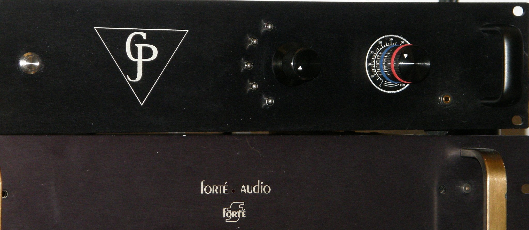

Now I realize that you bought the whole 'kit', I mean with the chassis done up and everything, but that doesn't force you to accept the toggle switch given for the job. It should have a rating of 3 amps or more just so you don't have to worry about it. I do not know, but it appears that the mounting hole for the switch is about 1/4" You can drill a larger hole with a step bit if needed and it is pretty easy since the front panel is aluminum. Many toggle switches have a set of nuts to adjust for thickness of the front panel.
In my build, I went another direction and chose a pushbutton switch. I think that they look better.

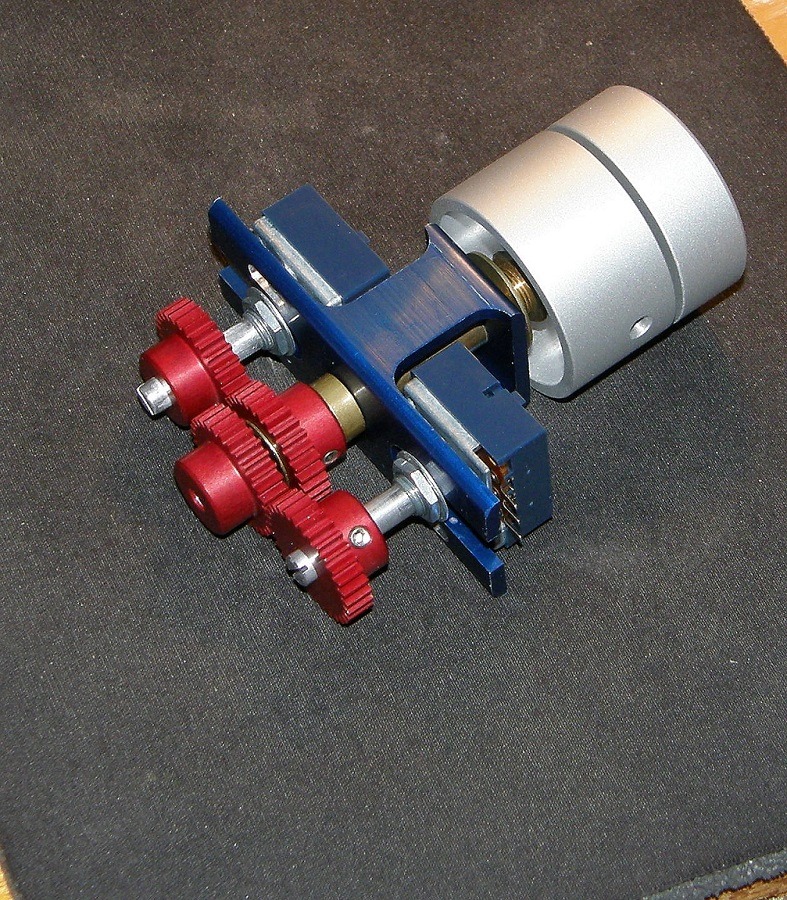

Got back into my unit to investigate what was causing an issue with volume balance. I guess that it should be no surprise that it was one of the mono pots. Crap. So I changed them both out for a new set and the problem is solved. This is an unusual stacked configuration that works perfectly. Changing pot is more complicated though, and this had better be the last time.
Thanks for reminding me this IS diy after all. I was searching for a basic spst on-off switch and not coming up with anything I wanted. I've since realized that I can loosen up a bit and just find something else to do the same job. I'm excited for this build... it's been a while.
You are welcome, of course. The beautiful thing about any art is the ability/choice to make it your own. There is nothing wrong either way though. I just enjoy being able to turn a corner here and there without drawing too much attention to it, yet a person will look at the difference, not quite knowing why they prefer its design.
