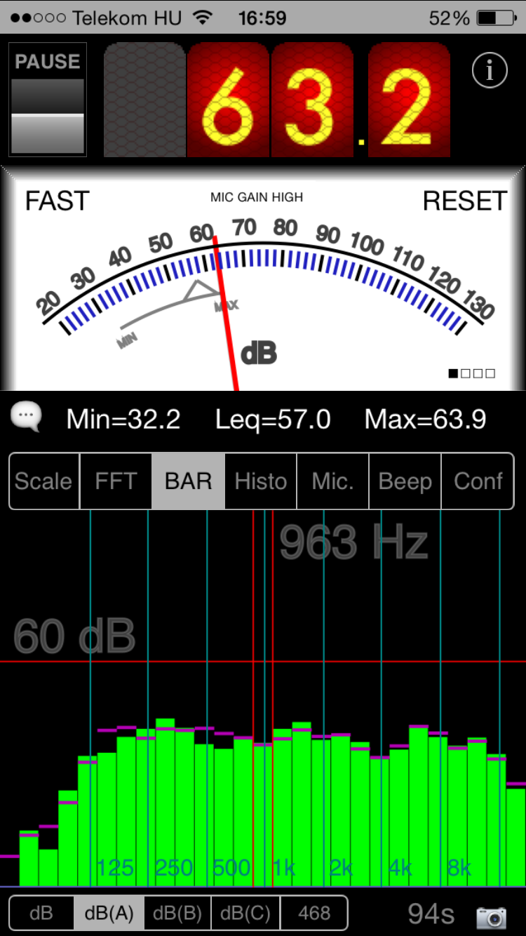

I have this app installed on my iPhone 4S. Im still unsure how to use it?
This was playing quite pink noise, with the phone right up against the speaker.

If your intention is to evaluate the frequency response of your loudspeaker, choose white noise and not pink (which is useless nowadays). With an iPhone 4S and iOS 6 or above, you should get something rather accurate.
Just activate left or right, not both. Turn upside down so that the microphone (bottom of the iPhone) targets the speaker.

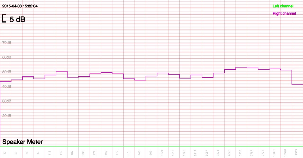

Hi!
Therefore all Apps including Speaker Meter bypass internal low pass filter

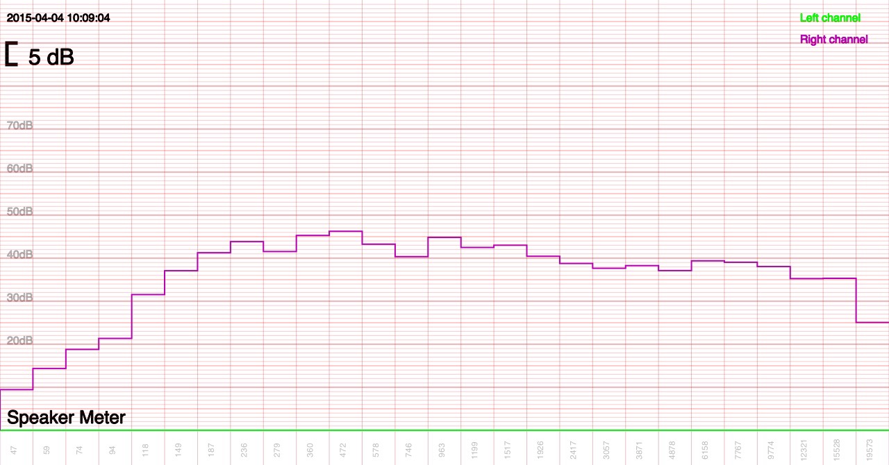

So, do you say ther is no low pass filter in the measurement way?
Than what is this? What did I wrong?
Greets:
Tyimo

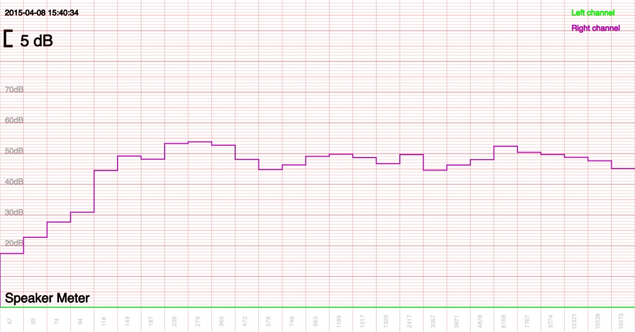

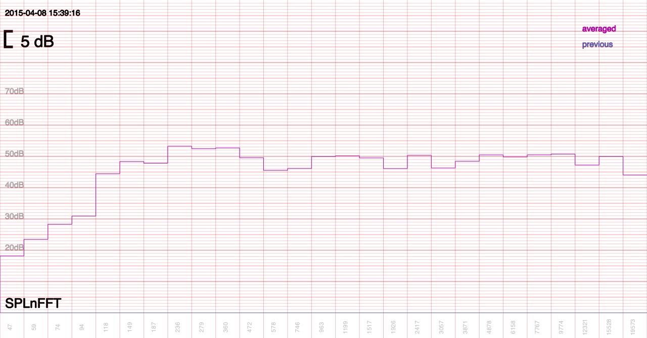

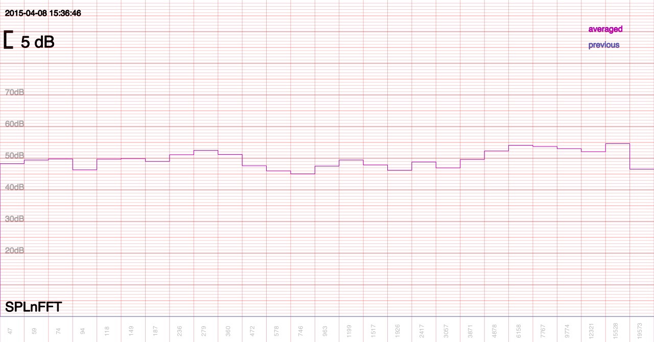

Hi!
Here is a fast try with both microphones.
I am confused. I don't know why the iMM6 is working so bad. Maybe it need the calibration file.
BTW.:Your apps has similar results.
Here are the garaphs:
The first 2 are done with the built in mic.
The last 2 are done with the the iMM6 mic.
Greets:
Tyimo

Hi!
Is measurement mode really activated ?
How sholud I activate it? I used the "mic. calibration" process in the SPLnFFT App.
It was done succesfull. The App see the iMM6 as a "headset mic".
the debug.plist file that is joined to the export mail you can generate in the App (SPLnFFT), provided you activate debug mode in 'i' page.
Sorry, but I don't understand this sentence.
