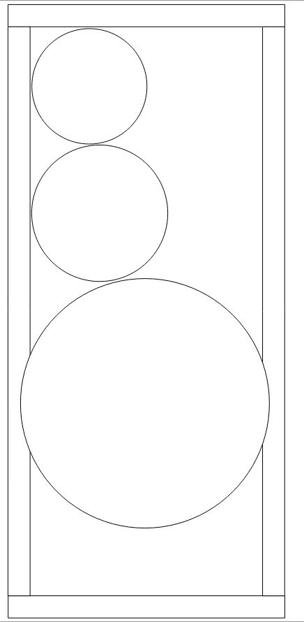

David, you are absolutely right, the baffle is 250mm wide.

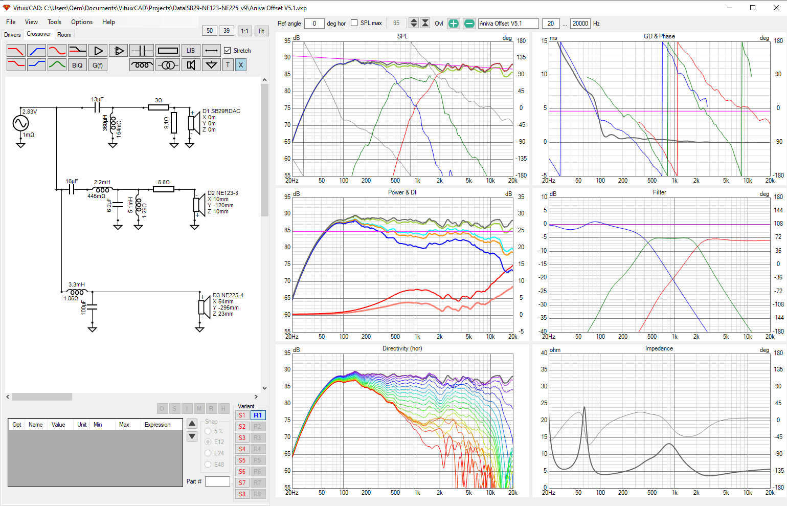

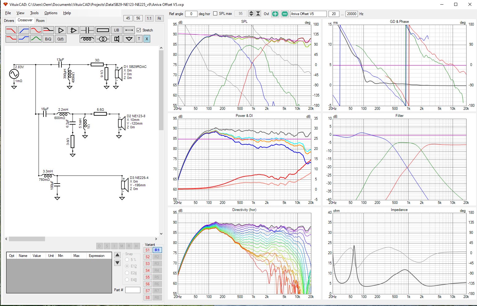

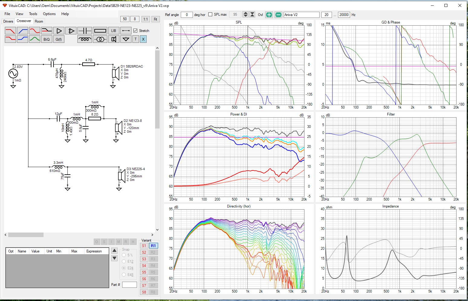

Have been having a play with this, and while I can get a proper HPF in for the mid and still keep the overall impedance above 4Ω, I'm not convinced that what I've got is particularly great in a few other aspects.
Couple of notes first - VituixCad is what I'm more familiar with, and in order to have a look at off axis as well as on axis response I used its diffraction simulator, so my basic freq responses may be slightly different than yours.
I assumed all drivers were horizontally centred on the baffle as that matched your raw curves the best, especially for the HF, but that does throw up a complication. Both the mid and HF acquire dips between 2k & 3kHz, which means getting a smooth crossover there seems to need pushing the XO up over 3kHz. That tends to result in a bit of a dip in the off axis responses at & just above the crossover. If you were able to make up a new baffle for your box with the mid & HF offset towards the side, that area smooths out a lot, potentially allowing a lower XO and smoother off axis response.
Other areas I'm not totally happy with are the phase between drivers (I haven't improved that over your version at all) and the use of some pretty hefty components in the low and mid filters, 75uF in the Low and 10mH in the mid are going to be expensive unfortunately.
Anyhoo, this seems to be the best I can do at my current skill level, sorry it's not better news.
Couldn't resist playing with offset drivers a bit, I think the midrange is a lot smoother on axis, DI is a bit smoother from 1k to 10kHz (less narrowing at the mid-high crossover), and a few components have moved to more affordable values too.

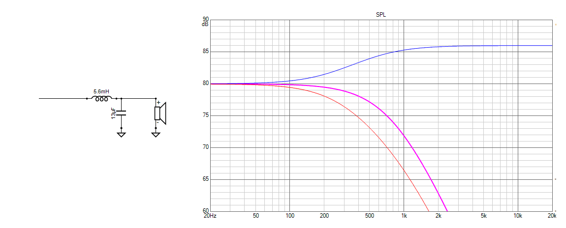

Sometimes you should use the BSC circuit, I'll show when and why. (2 posts)but seems not using extra BSC
Here, the baffle step (the blue trace) is around 500Hz . You are trying for a 2nd order crossover at 800Hz (the pink trace).
With the standard component values, the baffle response lifts the combined response too high. So I've increased the capacitor and inductor values to give the correct response.
To illustrate this, if not for the baffle step these chosen larger values would look like the red trace. If you combine the red with the blue, the result is the correct pink trace.

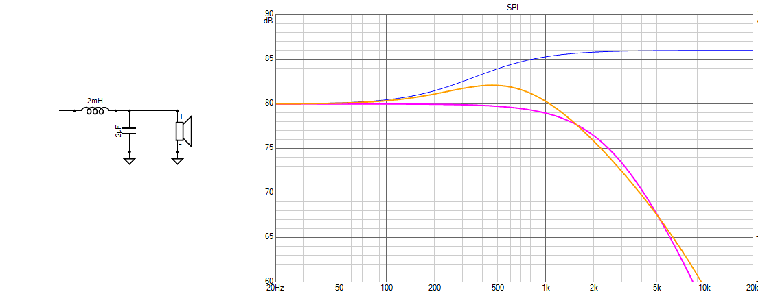

Now, look what happens when we try to use the same 2nd order type of filter, but this time the baffle step is at 500Hz and the crossover is at 2,800Hz. The crossover falls across the range of the baffle response and is kinked both up and back again.
Since the shape is wrong, the orange trace is the best you can get with this circuit. The more complex shape needs a more complex circuit.

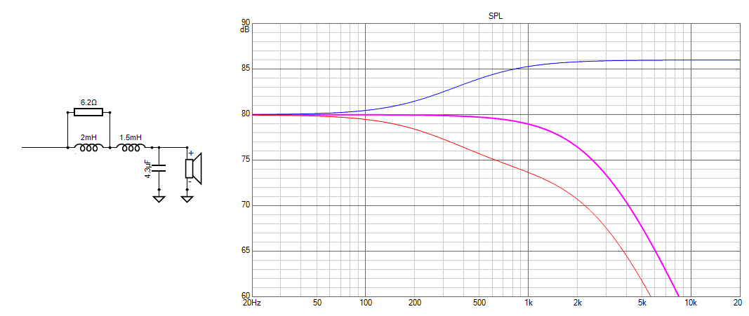

Now, add the BSC circuit... Perfect.
Again, the red response shows what the filter looks like on its own before the baffle response imposes itself. The red trace has the opposite kinks in it and the final pink response is correct.

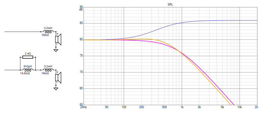

Now for a first order filter. Otherwise this is the same 500Hz baffle frequency and 800Hz cross.
The orange trace is the simple filter. It is not possible to get the response right above and below the knee of the rolloff (say, roughly 1kHz), at the same time. The extra two components help give exactly the wanted pink response.

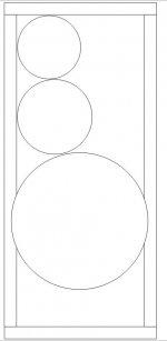

I have been thinking and finally decided to try to build new speaker cabinets. As you mentioned above it has some benefits if we offset drivers and so on. I also like that you shift mid by 120mm and woofer(295mm) relatively to tweeter. I thought about that but was not sure if it has significant impact.
Sorry I was away and missed your messages.
I really appreciate your calculations! I will study them more carefully on weekend.
Hi Aniva, those vertical offset values simply reflect the positions of the drivers on the baffle, in real life they obviously can't all be at 0,0,0 as they can't all occupy the same space. In this case, all of the modelling was done with what I believe is VituixCAD's default "measurement" distance of 3m from speaker to the simulated mic position, so even the bass driver is only <6o off axis, so it won't make more than a few tenths of a dB difference to the overall modelled response.
No worries.
In VituixCAD, the depth is set with the Z axis, so as modelled that assumes all the actual diaphragm surfaces are aligned in a flat plane.
Practically, you'd need a stepped baffle a la Troels G to achieve that, as the woofer is deeper than the mid which is in turn deeper than the HF.
If built flat, that does worsen the phase behaviour a bit (Depths assumed, based on ~0.5x the depth of each cone, don't take this as gospel!):
