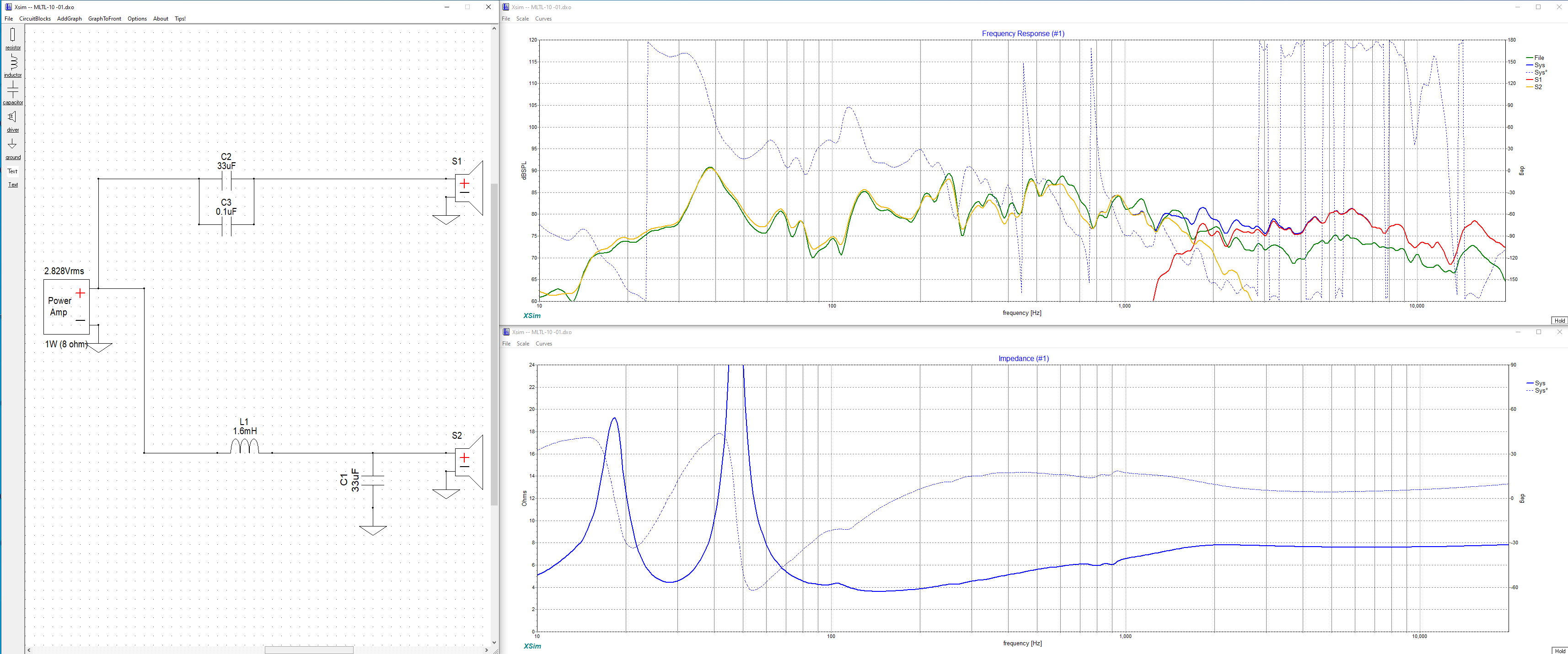

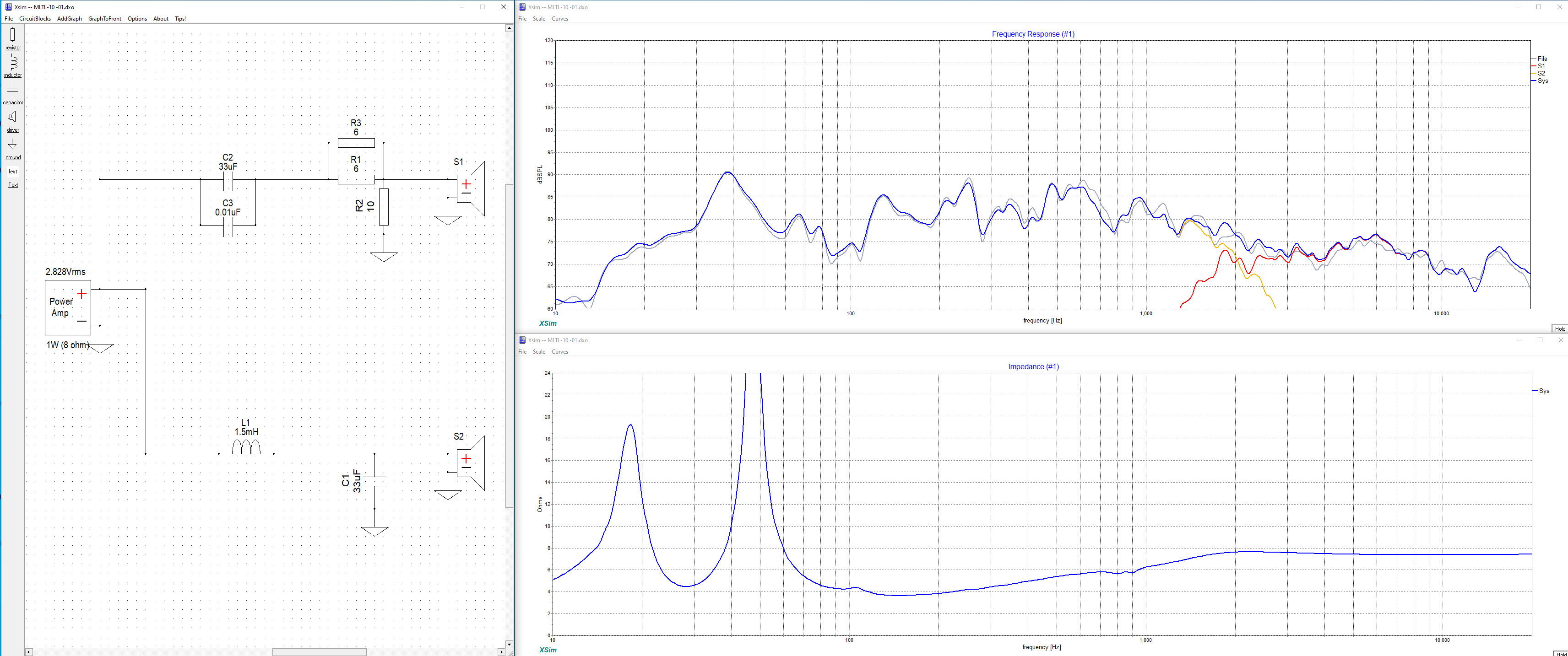

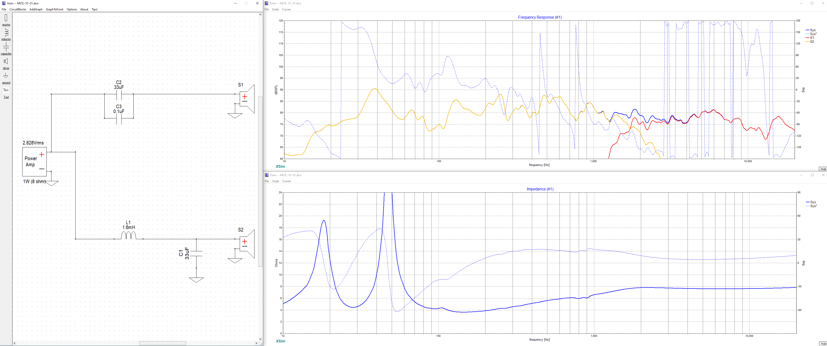

Okay, things are looking better - I took new measurements, both the ZMA and the FRD. The former were essentially unchanged, but the latter were quite different, as I took them for both drivers with the mic in the same location about 3' away on the listening axis. And the crossover is simpler - 1st order on the tweeter (basically to prevent low frequencies from hitting the tweeter) and 2nd order on the woofer. Three parts for the basic components, with a fourth being a bypass cap on the tweeter.
I also measured the drivers with the digital active crossover, as well as the speaker system, and this was helpful as a guide for balancing the response in XSim. The acoustic crossover point is ~1.7kHz.
Edit: I was visually comparing these - and then I realized I could import the FRD of the speaker into XSim, and the digital XO is rolling off the tweeter more, so I will look at adding a coil or resistor on the tweeter to adjust it. See the second image, and the green trace.
I will be ordering Audyn A4 33uF caps, and the 1.6mH inductor will be ERSE. I will get Sonicap 0.1uF for the bypass.
I will add a 6 ohm 12W Mills resistor on the tweeter, to bring the tweeter down to just a *touch* louder than it is with the digital XO. I will order a 7 ohm, for our friend Justin Case. These will work for up to about 40W at the amp which is at least 100dB and about 10W heat dissipation from the resistor.

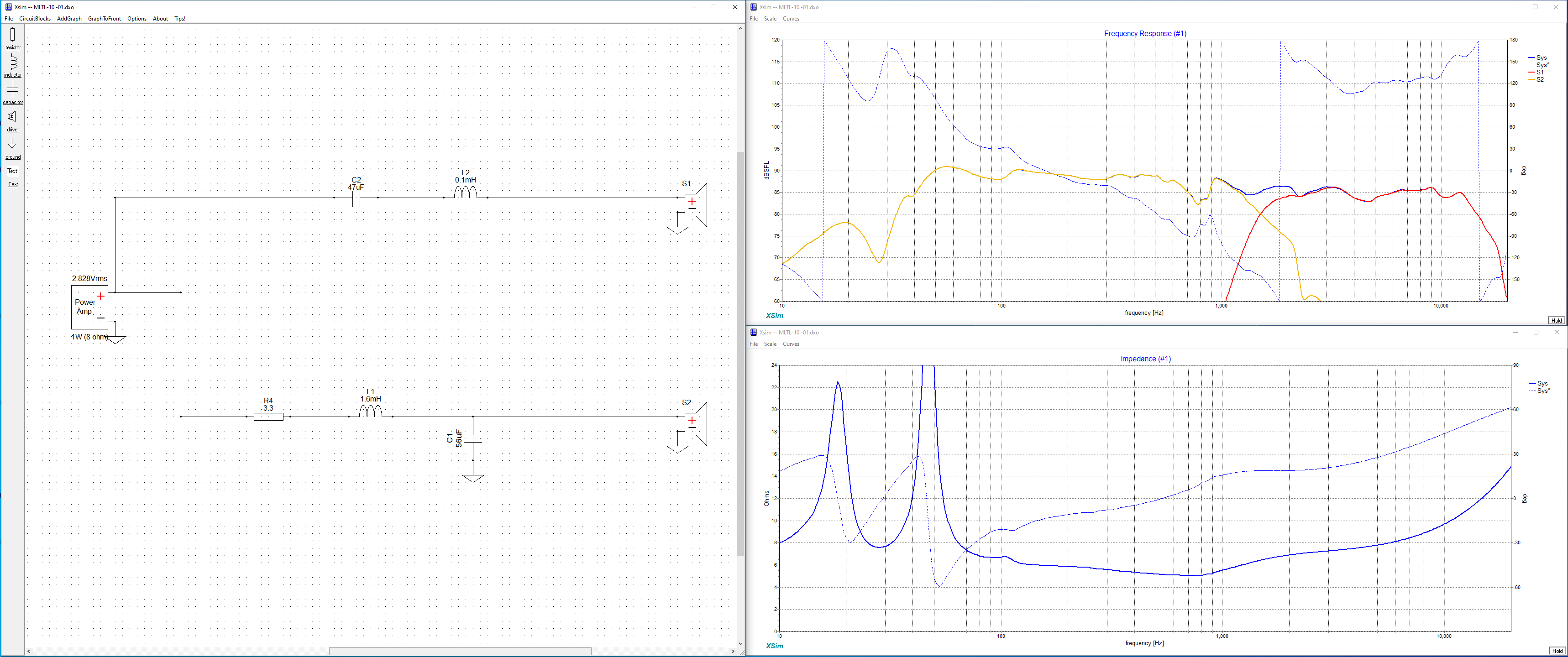

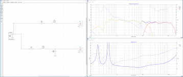

Hi Allen, the ERSE 14ga coil has a DCR rating of 0.278 ohm - is that the value to use in the ESR? If so, it makes a small change. Here's what I am going to go with - the gray trace is the speaker system with the digital XO that I measured from the exact same mic position as the driver FRD measurements.
Thanks Danny, I just checked and it looks good and proper.
I think that possibly the reason the tweeter level looks low, is that it is a dipole? So, in the room, there is 2X the energy, maybe?
These are *really* close so I am going to go ahead and order the parts - my very first analog crossover! Woo hoo!

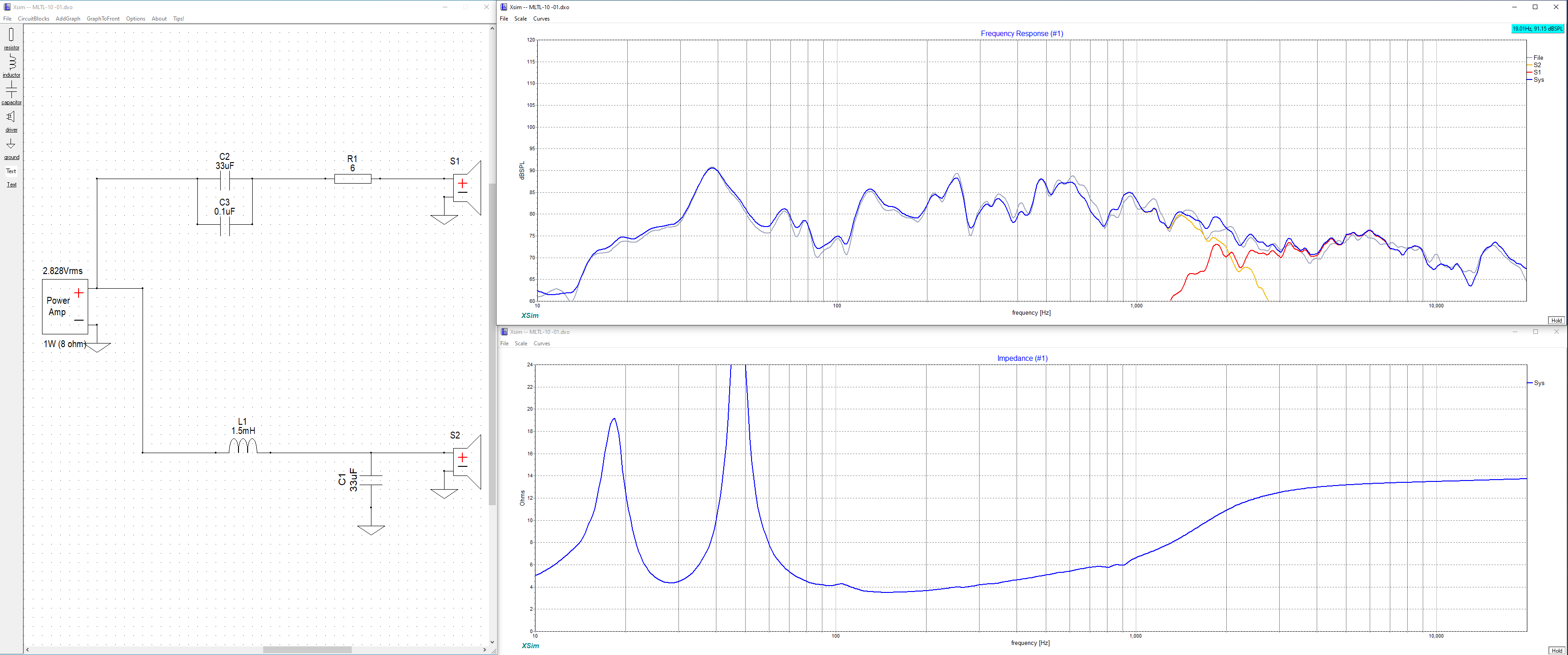

I realized that the impedance above 1kHz could be improved with an L-pad - luckily a second 6 ohm in parallel with the first, and a 10 ohm to ground drops the impedance to essentially the same as the tweeter itself; about 7.5 ohms.
Minimum impedance is ~3.6 ohms at ~150Hz, and between about 110Hz - 230Hz is below 4 ohms. I am not sure, but does this look like the nominal impedance is about 5 ohms, or maybe 6 ohms?

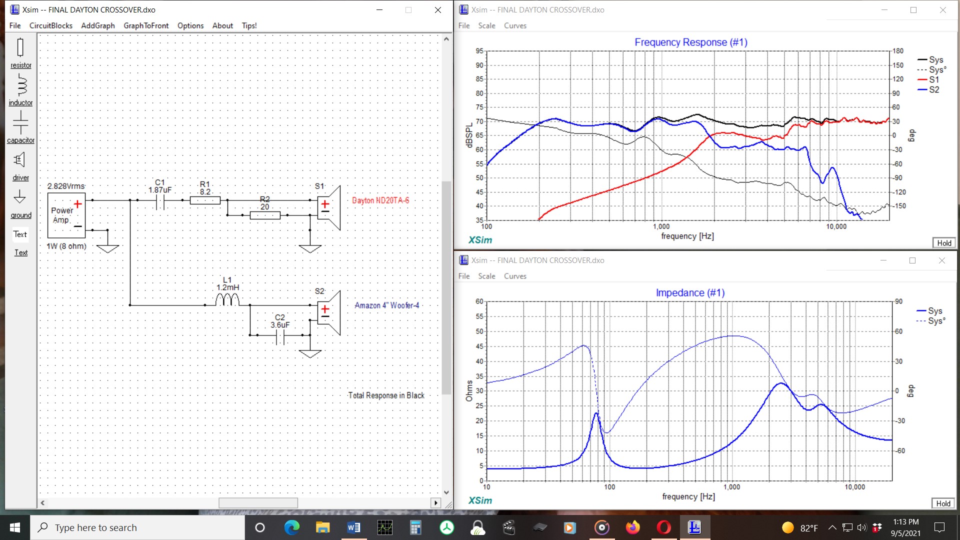

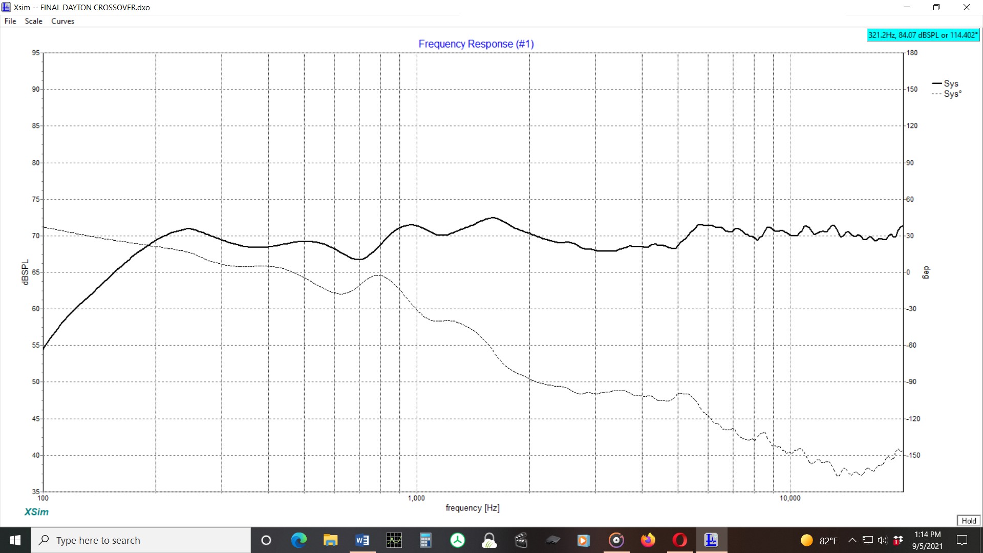

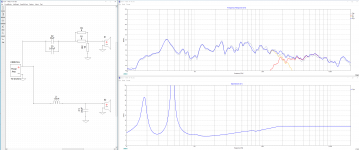

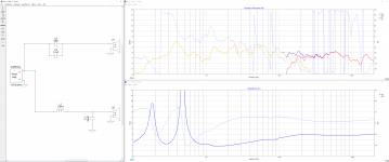

Designing a new crossover for a low powered (20W/Ch) Amazon bluetooth setup model R28BTUS. First graphic is stock 1” 8 ohm tweeter w/ 2.2uF cap and 4” 4 ohm woofer running free. Second graphic is the same speaker with the Dayton ND-20TA-6 and proposed revised crossover. Third graphic is the same, but showing only total response for clarity. XSim dxo file seems to large to upload.
Would appreciate a “sanity check” and any comments/thoughts on my proposed crossover.

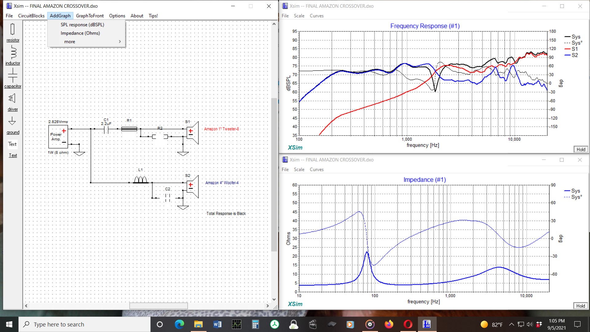

I am far from an expert, but the 1-2kHz region seems to be a bit higher than ideal. Maybe a different (lower?) cap value on the tweeter would roll it off a bit more / higher up to reduce the summed response through there?
Also, maybe adjust the R2 value to lower the impedance of the tweeter and/or adjust the C2 value to roll the woofer off a bit quicker? The overlap region seems wider than what I would think is ideal.
