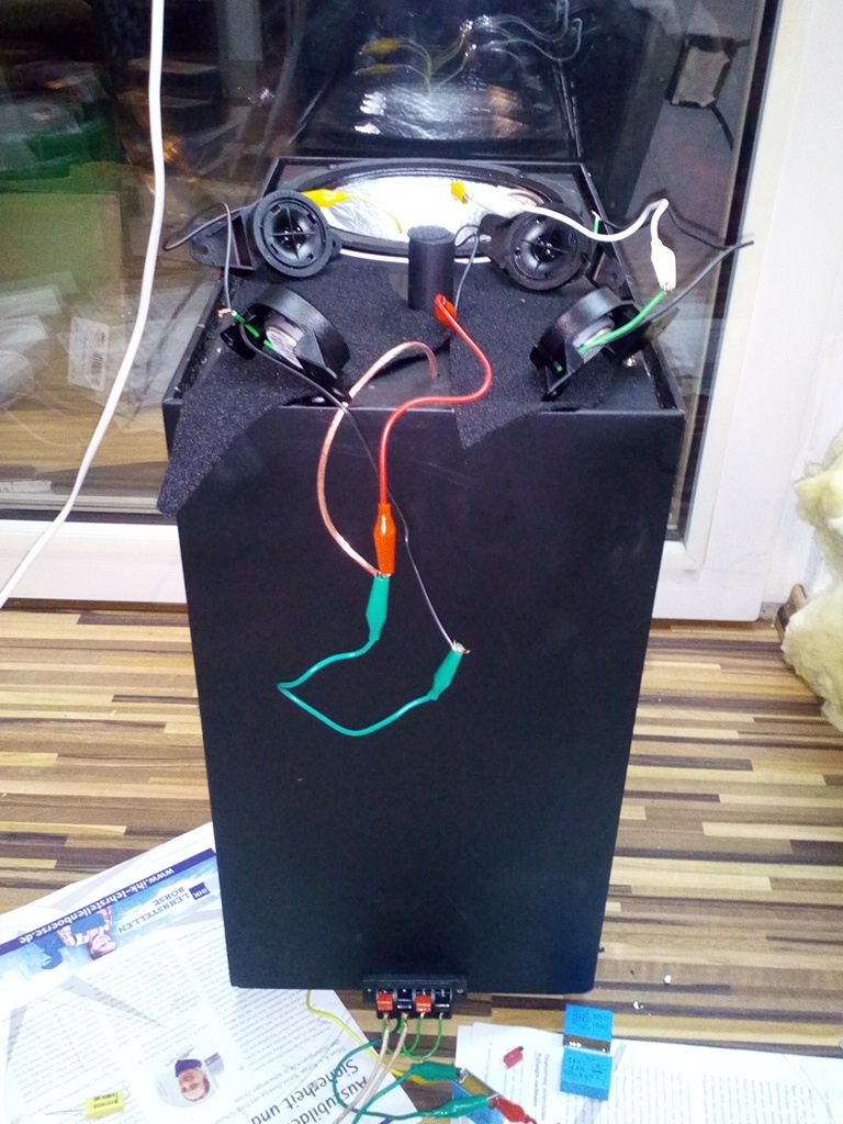

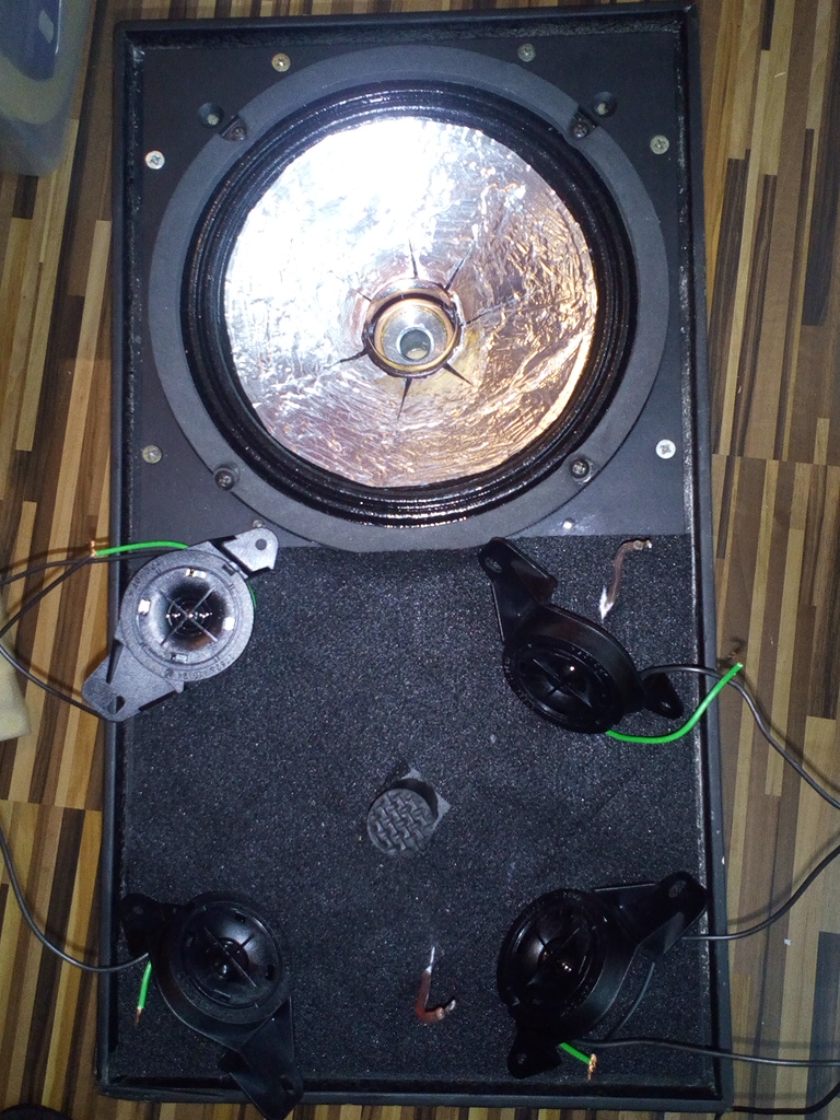

Audax tweeter for easy construction without measurements
I really like to use in loudspeaker projects Tweeters which can be found in cars and are produced in thousands for the industry.
The copy of the classical Audax Tweeter - a mix of dome and cone which functions very fine with just one capacitor and nothing else.
You can see the combination of a fullrange driver with 0,75mh induction of the voice coil and natural decline beyond 4khz in combination with this type of Audax Tweeters in this project:
The Advantages of Floor Coupled Up-Firing Speakers
I optimized impedance of the tweeter array and the capacitor (foil type) only by listening as this sort of in - room optimized loudspeaker with surround sounding qualities are far from easy to measure.
In this case listening is more important than measuring!

diyAudio Moderator
Joined 2008
When you trade off slope and frequency, there comes a point where it becomes clear there is a limit to what you can do.
When you are crossing this way you rely on hearing when the tweeter is being pushed too far. You want to hear the mechanical limits and hope, as is often the case, that this comes before reaching the electrical limits. To be honest it is rare that I damage tweeters but I also do not play them where they are distorting. You need to take more care when you are doing something unusual like you have suggested here.
When testing keep in mind that broadly speaking, playing drivers close to their limit for some time can build up heat. Similar to the process of soldering... within reason you can go a little hotter if only for a short time.

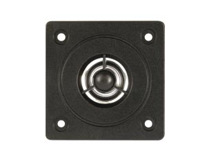

Hello Wik,
If you want to make a complicated filter - no problem, I could measure everything. I recommended this Audax type tweeter (see foto) because it really works well with just one capacitor. It is built for that. So it is much easier to build with these tweeters a loudspeaker without measurement capabilities.
I really appreciate the sound of these tweeters if used with a foil type capacitor.
Hello Allen B,
you are quite right in stating that a 6db filter can damage a tweeter if there are too many watt input.
This audax alike tweeter has ferrofluid which helps a lot to get some more headroom when driving the speaker hard. If you use multiple tweeters like in this example of a Sonab loudspeaker copy then the tweeters can take more wattage.

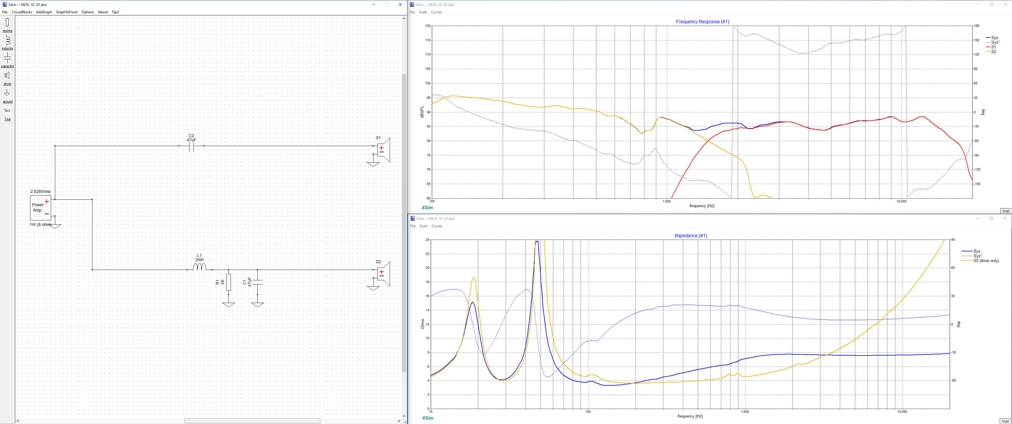

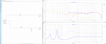

This is my first attempt at designing a crossover - I am using XSim, and I measured the impedance / phase with my DATS v3, and the response sweeps were done using REW. The woofer was installed in the mass loaded transmission line cabinet, and the tweeter is a Linaeum ET-8 dipole mounted on the top of the cabinet (tweeter made by Radio Shack).
Here's my crossover design, and the predicted response.
I am wondering if the dip centered at ~800Hz is a resonance of the woofer? There is a small impedance ripple at that frequency. Maybe this will get better with some more use of the speaker? I will keep using them, and remeasure them later to see if this changes anything.
I am playing them initially with an active crossover (miniDSP 2x4 HD). With that unit, I have set the crossover to be 2nd order, at 1100Hz for the woofer and 1200 for the tweeter - but the tweeter's response naturally rolls off starting at about 1600 or so, I see now with the measurements.
It sounds very good with the active crossover. I am also surprised at how much higher the woofer keeps responding - and it seems to be out of phase above 2kHz. How would I add a steeper slope up at 2kHz to try to reduce the woofer's output up there?
Edit: in the active crossover, I am lowering the tweeter output by 3.5dB, so I am surprised that I don't seem to need to do this with the analog crossover? Maybe my response measurements where not done correctly? I had the mic at the same distance from each driver, and obviously I kept the volume the same. I did move the mic vertically to be in the center of each driver - maybe I need to pick one position a bit farther away, and measure both at the same point?

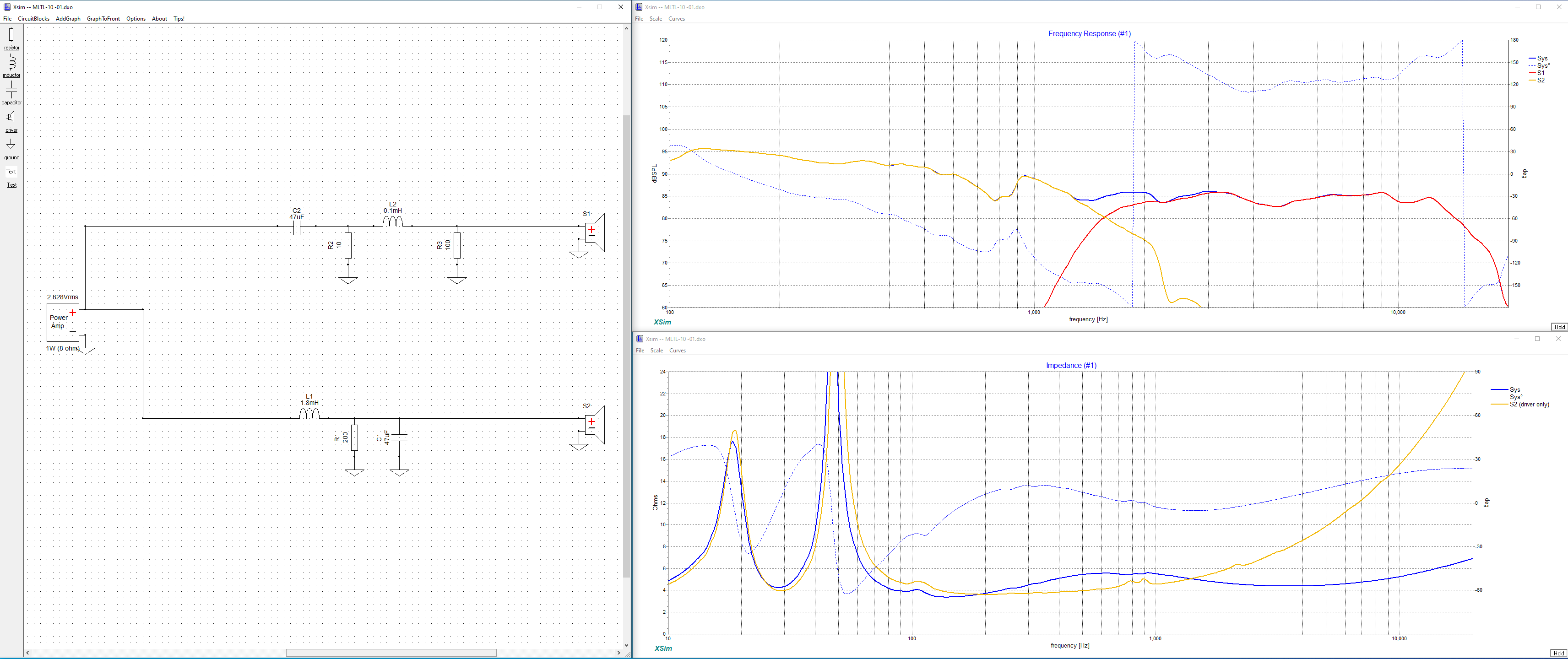

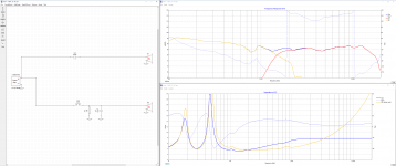

Some further trial and error nets me a small positive change, I think? Made the woofer a 2nd order (kinda' obvious?) and got rid of most of the upper end of the woofer.
I am still concerned about the tweeter's rise starting at ~5kHz. Maybe I can do something for this - I did try a few things already? I will be trying this out on the outside of the cabinet (it has two pairs of binding posts) so maybe it can be changed later?

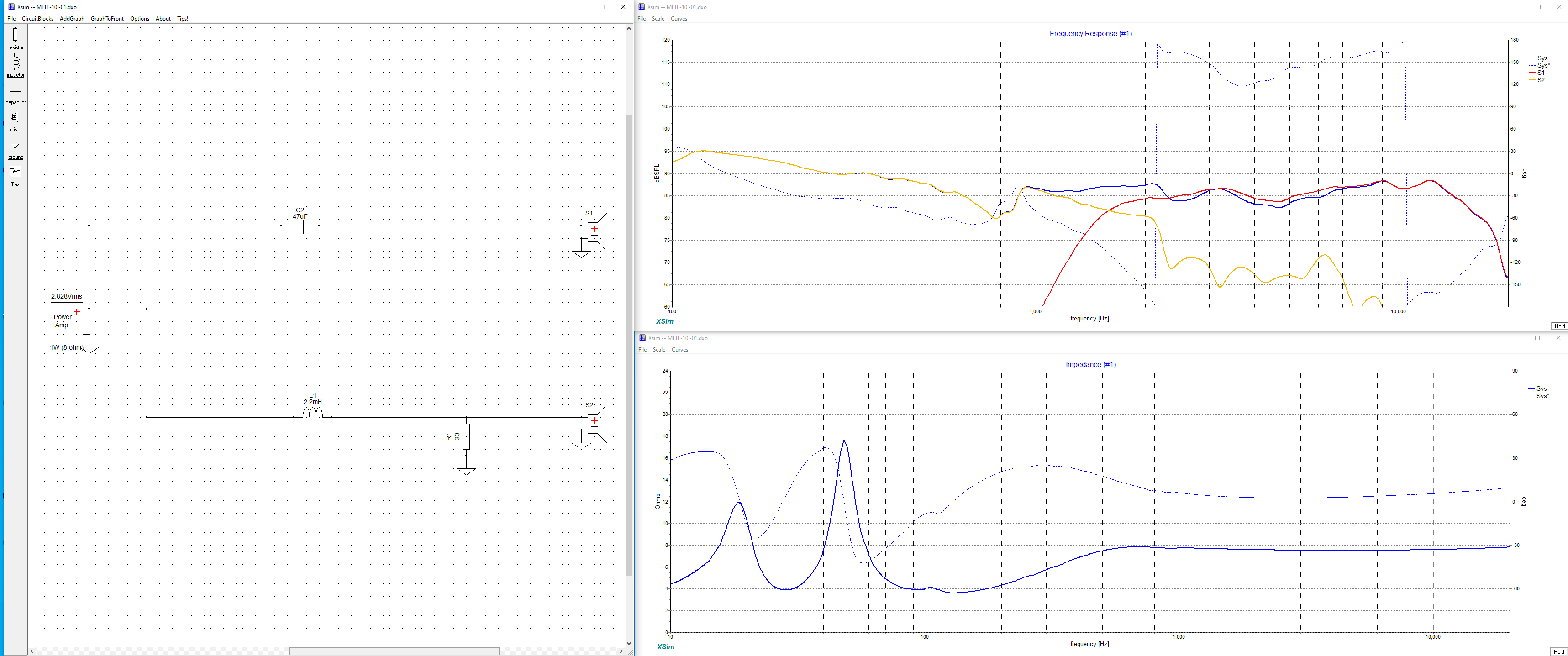

And I have a third version, that makes the tweeter also 2nd order. I want a "house curve" but this may be a bit more of the shelf down than I need?

diyAudio Moderator
Joined 2008
If you are not confident in your measurements then that might be a place to start. Have your mic at half the room height. Don't go too far back just yet, that makes it harder to exclude the room.. and that's my next question. Are you doing that with REW?
