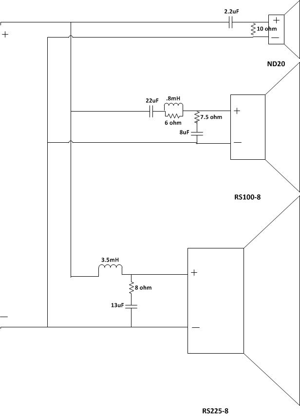

Hi All,
This is my first post on this thread, so let me start by thanking AllenB! This is one of the best and greatest threads on DIYAudio, especially for a beginner like me.
Using information in this thread and some online crossover calculators, I came up with a three-way crossover setup that works very nicely with the speakers I designed using Martin King's computer models. I have included the crossover details below, but my question has to do with the attached pictures.
What if any difference would you think there might be by connecting the tweeter the way it is connected in parallel with the other speakers in picture A vs the way it is connected after the mid x-over in picture B?
Thanks in advance!
-----------------Woofer-----------------------------
3.677 mH 600hz Lowpass Filter
Rz 7.93 [ohms] Cz 13.22 [uF] Zobel Network to manage impedance
-----------------Midrange---------------------------
22uF 600hz Highpass Filter - erse
0.8 [mH] Rbsc 6.0 [ohms] Baffel Step Correction circuit Lbsc
Rz 7.562 [ohms] Cz 8.39 [uF] Zobel Network to manage impedance
-----------------Tweeter----------------------------
2.2uF cap in series Highpass Filter
10 Ohm Resister (Flatten the impedance)

The capacitor feeding the tweeter is now in series with the resistor across the baffle network, so this capacitor doesm't need to be as large as before. The tweeter will be more quiet due to this resistor.
The mid will be in parallel with the tweeter above the tweeter crossover frequency. Below this the capacitor makes for a higher impedance and the tweeter portion disappears from the circuit.
Up where they are in parallel you'll want to expect your baffle network to become more effective at reducing the level of sound produced (may not be a concern here though.) The mid capacitor should be ok.
Is there something you like about doing it this way?

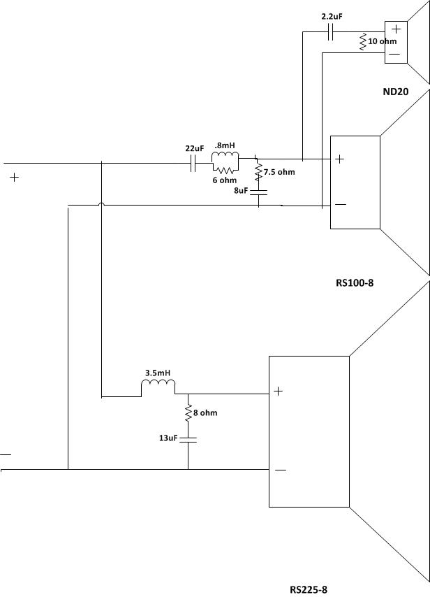

Joined 2011
Does the crossover point change with the capacitor being in series with the resistor?
Will it roll off at a specific rate, say 6db, or does it drop more suddenly (toggle in and out) at a certain impedance? Mid to high is audibly smooth with all kinds of music to my ear and to others who have heard the speakers in this configuration - Maybe I just got lucky!
Does that mean the BSC is ineffective with the wiring in configuration B?
I designed Configuration A with some slightly different component values, but Configuration B just sort of happened as I was tinkering with the system - swapping out parts to suite my auditory taste in a trial and error process.
I built a crossover board for the low and mid and for some reason I put the tweeter crossover parts right onto the tweeter itself and plugged that into the mid when I wired the system. The mid and tweeter are physically close together, so that was convenient. I have included a picture.
I love the way the system ended up sounding in Configuration B, so I am leery about changing it now. I don't currently have any way to measure the system, but I will probably break down and buy a mic and some software - any recommendations?
Thanks! -Glen
diyAudio Moderator
Joined 2008
Yes, for example where the resistor equals the tweeter, the frequency will be halved and the level will go down 6dB.
Lowering the impedance by adding other loads doesn't change the response on its own. In this case the mid crossover is working into the tweeter at the same time (the impedance is lowered after the mid crossover). The series components are going to share the available signal with this load so that is how the difference comes about.
Will it make a difference? The question is how much.. For starters, with the tweeter in parallel with the mid the impedance at that point would be half that of a single driver. The tweeter is in series with its capacitor which add to its impedance, and that doesn't need to rise too much before the total impedance across the mid is closer to what it is on its own.
The maximum effect will be around the 6dB mark, but only if you have a large series resistance so in practice it will be less.. and it will happen around the region where the mid is being attenuated anyway.
The effect of the mid capacitor is too far away in frequency to be significantly affected. The BSC won't be ineffective, just slightly different in a place where it matters less and could be tweaked back anyway.

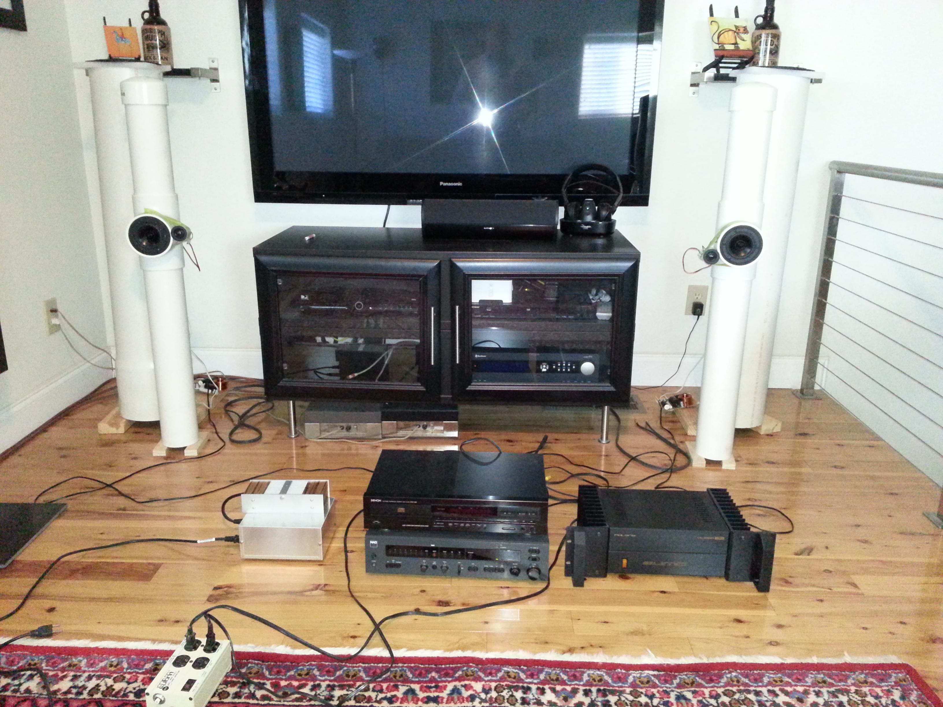

BTW, those are interesting, do you have a front photo of them?
Joined 2011
Here's a better picture from the front. I was trying them out with different amplifiers. They sound best with my gainclone.
These are older pictures with the first set of stuffed bass pipes I made. The project started out as a 4" full range setup. The first thing I did was add the super tweeter, then the bass pipes came later. After the success I had with the sound of this first small set of bass pipes I messed around in Mathcad some more and came up with really tall stuffed bass pipes that sound thunderous but smooth, and they blend in well with the mid-tweeter setup at all volumes.
The up-firing woofer crossed at 600hz works very well in the pipes. They aren't at all boomy and they have an openness about them. I have tried them in several rooms with different characteristics (live, dead, large, small, etc...) and they always sound great.
I have them in pieces at the moment because I am finishing them, but I hope to have them back together soon.
Thanks for your interest in them!

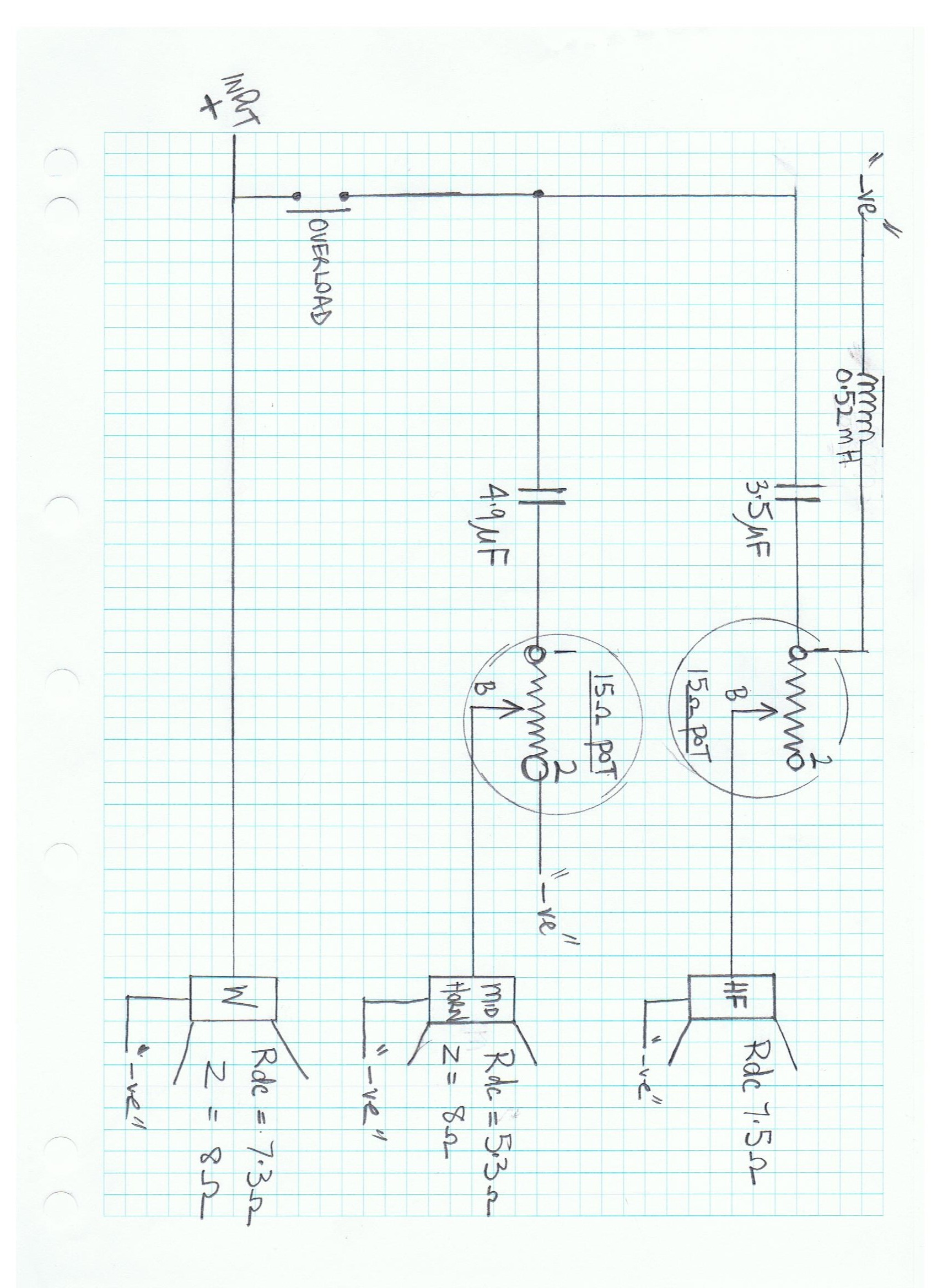

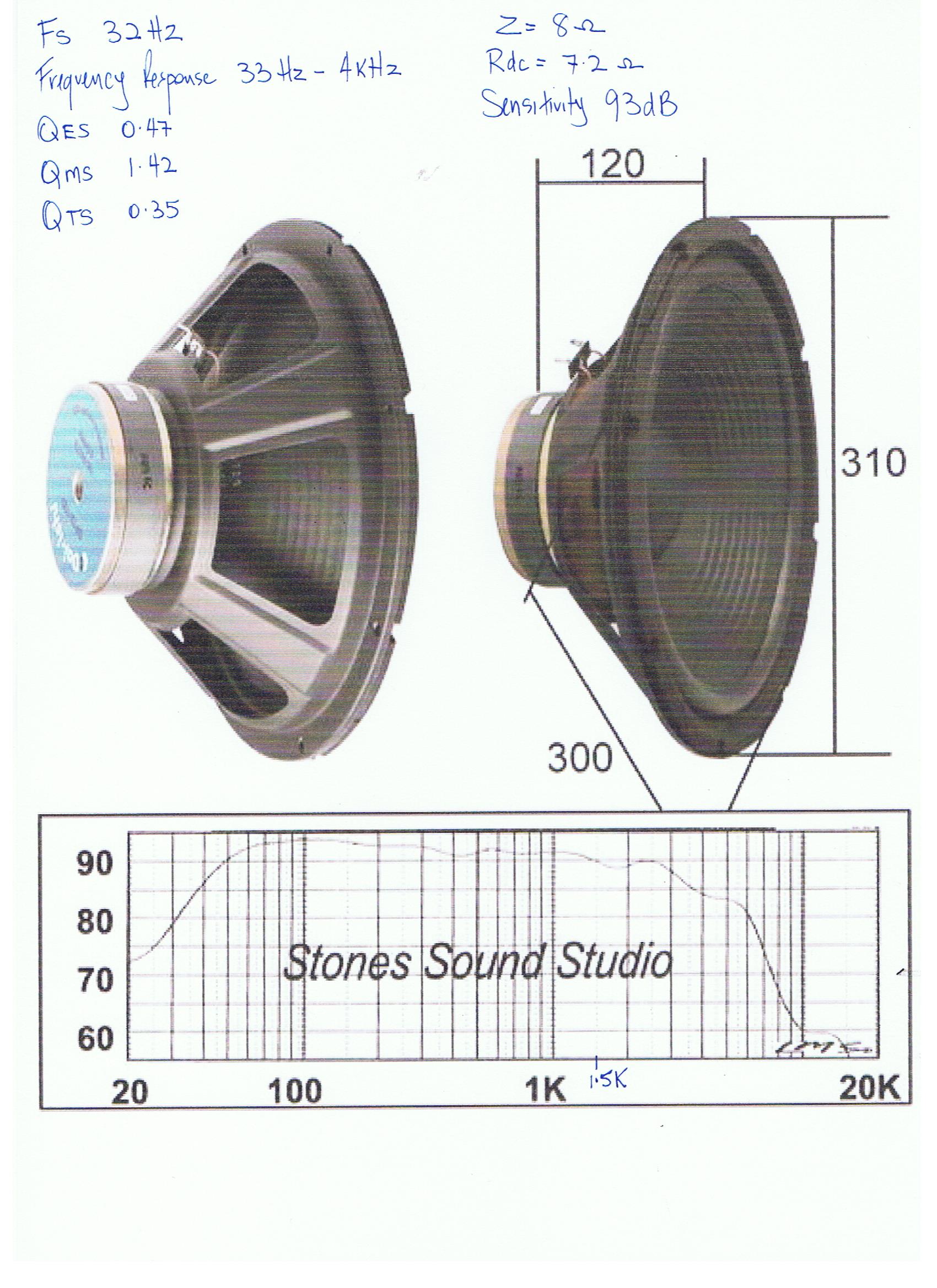

Hi Allen
Firstly thanks for the knowledge that you have taken the time to share and present.
I came across this site shortly after commencing a speaker restoration.

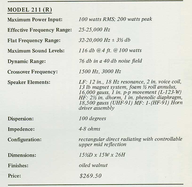

Speakers are Cerwin Vega 211R ( see Spec sheet )
I have conducted the appropriate calculations as per the method presented here which i will post in the next couple days
In the mean time.. was wondering whats your thoughts were on the factory crossover.
Looking at what you have presented here the factory looks a little too basic.
Thanks again

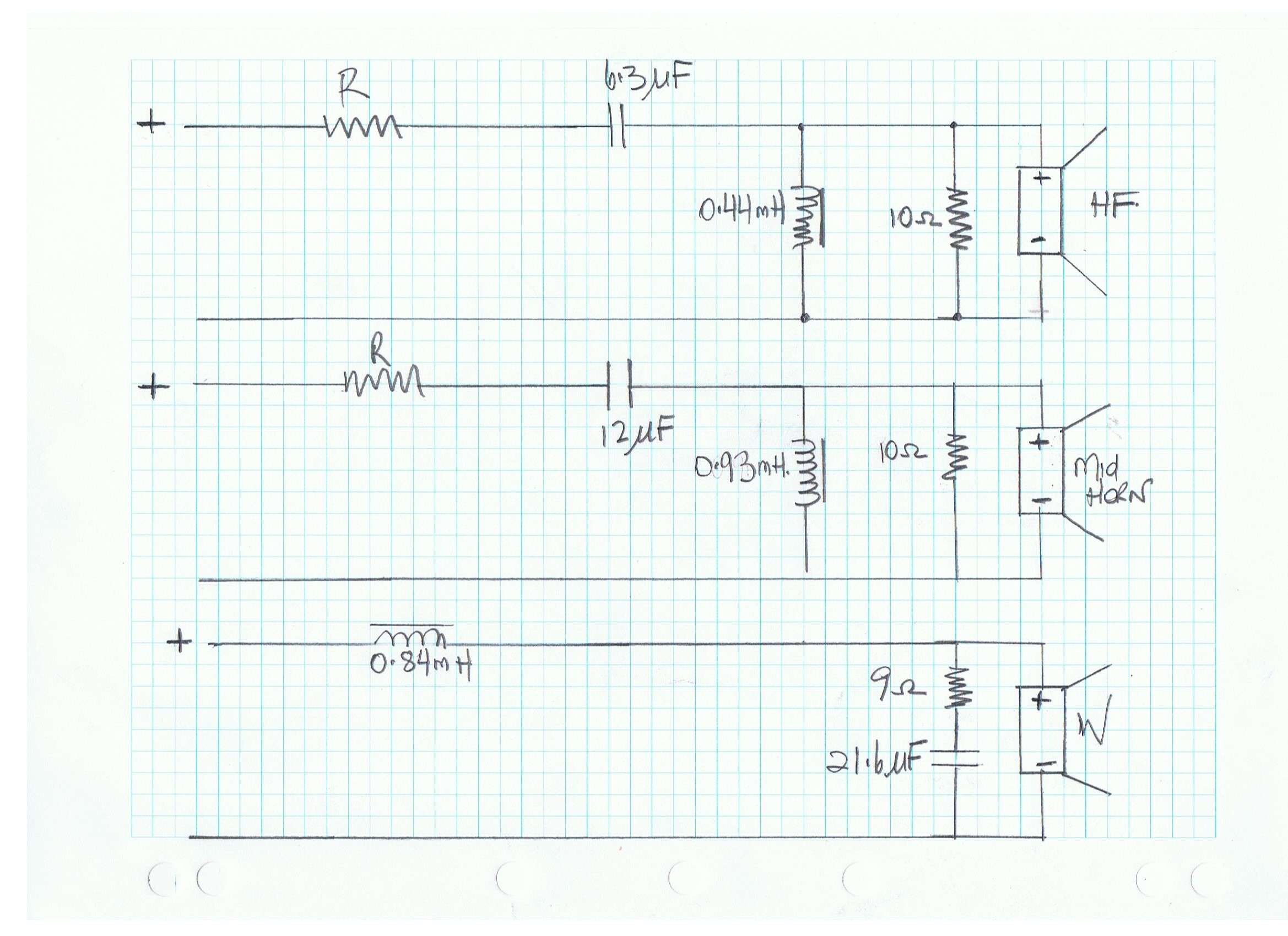

Hi Allen
Here is a diagram of crossover i have calculated as per instructions presented here.
Some notes:
All available information i have in relation to speaker impedance and speaker resistances are shown on post #351.
Will start with 10 ohm resistors on the Mid range and tweeter to flatten the impedance
Where you see "R" will utilize the 15 ohm pots
Will use factory crossover settings as shown on speaker spec sheet, 1500 Hz for the woofer looks ideal, unfortunately do not have any graphs for the tweeter and mid horn.
Have dismantled and cleaned pots with 600 grit and applied dielectric grease, they work like new now!
Have also fitted brand new diaphragms to mid horns as the originals were not identical ( 1 read 8 ohms the other 14 ohms)
Woofer and tweeters measured identical.
Not sure if i have the mid horn part right, i applied the calculations as if it were a tweeter.
Any thoughts?
