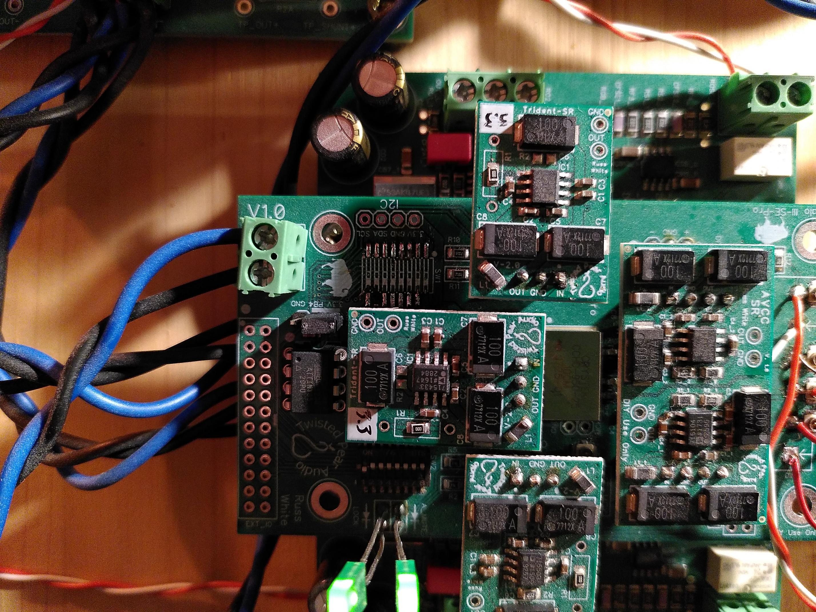

Hey everyone,
I decided to switch to an USB input through an Amanero-Hermes-Cronus to feed my BuffaloIIIsePro38. Unfortunately, after connceting everything as described in the first post I get no sound and the lock led of the Buffalo shows no light. So, here are a couple of questions:
1) I ordered the Amanero from TP. Does it already have the right firmware and configuration (slave mode) to run it with the Hermes and Cronus?
2) I only have access to a Linux machine. Does the Amanero work out of the box with Linux or are there any known issues?
3) I attached a picture of my wiring of the Cronus and the Buffalo. Are there any obvious flaws?
4) Any advice what I could test to check the correct functionality of the Cronus? Anything I could measure? I already had problems to make it run with a BBB-Hermes combination and I start believing the problem might lay in the Cronus (Problems with BBB-Hermes-Cronus for Buffalo-IIIsePro38 build.)
5) Is it possible to shortwire the Cronus to check if everything else works fine?
Cheers

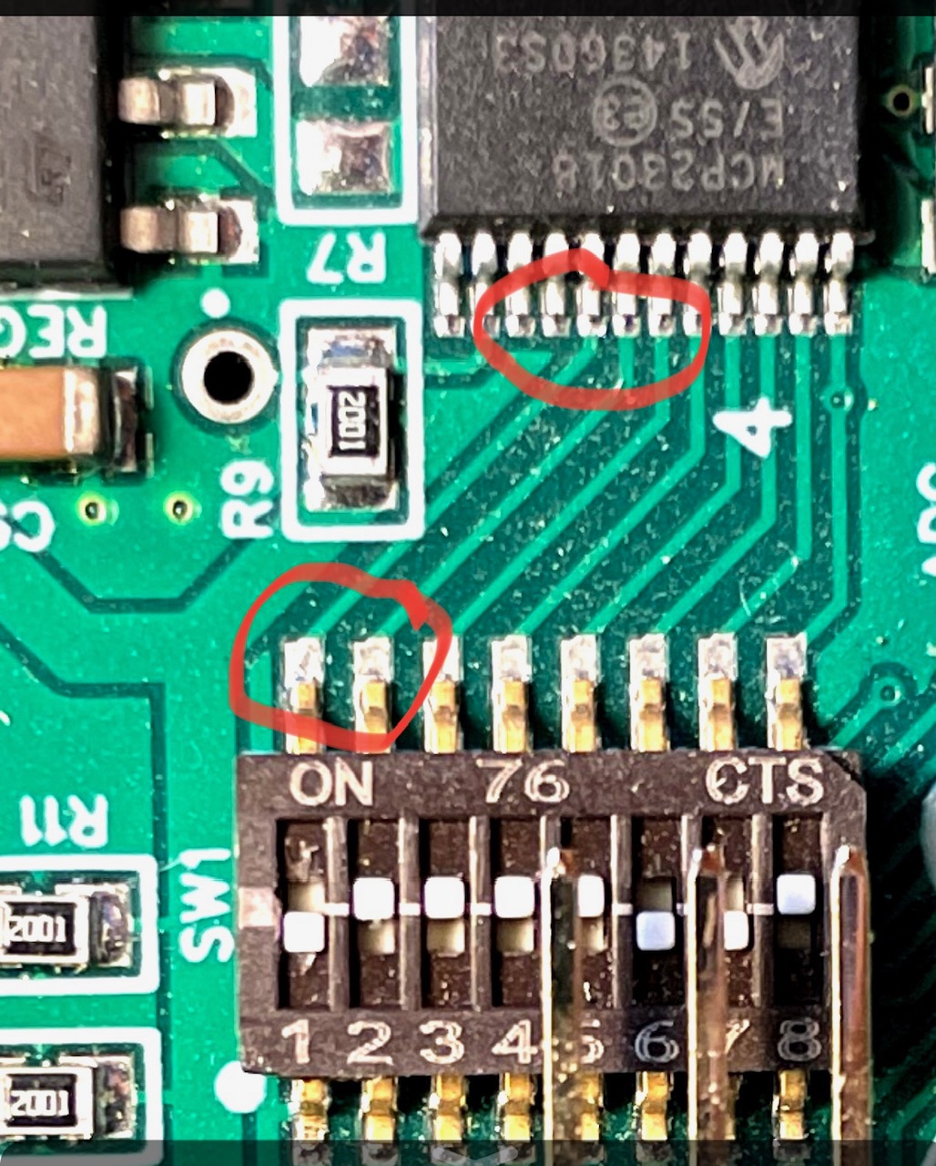

Had some time again to work on my Buffalo build and here goes the next chapter of my Odyssey...
Still, SPDIF input works fine. Then, I want to change switch 1 position 1 to Off to enable SERIAL(PCM/DSD). My switch 1 was broken from the beginning and I replaced it, but when I controlled it with a multimeter the contacts of position 1 where always connected no matter how the dip switch was placed. In my despair I even removed the switch again and the contacts of position 1 are still connected (my multimeter shows a connection). Also, SPIDF input still works indicating that position 1 is connected. That might have been my problem all along why SERIAL(PCM/DSD) never worked for me...
Is there a way how position 1 could be shortwired even without a switch? Is there another possibiliy to disable it and to switch from SPDIF to SERIAL(PCM/DSD)?
I am glad for any helpful comment.
The switch circuit is on the top layer, and when a switch is 'on' it connects the MCP23018 i/o interface pin to ground. You want to look for any abnormal connection between the interface pin and ground, and the two areas I circled are probably most likely. Any excess or small blob of solder between pins and/or a pin mis-alignment could cause what you're seeing. If you suspect a short on the side of an interface pin you might try carefully cleaning between the pins, perhaps with an Xacto knife, etc...
[BTW, photo below is a screen shot from the very useful 'magnifying glass' utility in my iPhone - useful if you don't have a better way to scrutinize the surface of the board.]
Good luck!
