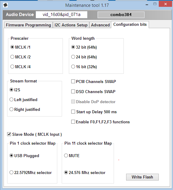

I am currently (and strongly recommend) using the following configuration.
Cronus:
45/49Mhz clock with Hermes clock output set to 1:2 - this means the Amanereo is sourced with 22/24Mhz - while the clock for reclocking (and optionally the DAC) is 45/49Mhz.
Amanero:
CPLD Firmware = "Slave_For_1080"
CPU Firmware = "firmware_1096c" or "firmware_1095b" - but do not use "firmware_1095c" as it is broken.

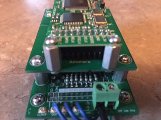

Hardware setup is very simple - just connect the appropriate headers and stack the Amanero with the Hermes (either on top or bottom depends on your needs) Then stack the Hermes (once again either top or bottom) on the Cronus. This makes the interface very clean and short - and at the critical point (the Cronus outputs) everything is time aligned with the Cronus master clock.
I have tested this combination in Windows using Foobar and on my MacBook Pro using Vox and other players.
PCM and DSD both work fantastically and play lists that move between sample rates and DSD/PCM types work as expected with no pops (using a B3SE) or any other nastiness. The highest sample rates work perfectly (352/384khz) with the firmware indicated above.

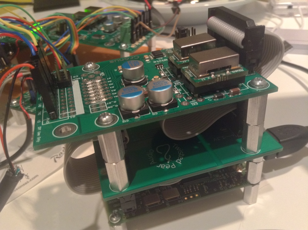

After finishing setup of Hermes-BBB/Cronus boards for my B3SE and B3, I assembled Hermes-Amanero boards with 45/49 clocks as shown in the picture and found this combination could be the best solution for playing music via USB connection.

Were the ribbon cables used instead of stacking connectors for experimentation flexibility?
Well, the Amanero used here is years-old after soldering header pins. So I couldn't stack the board in the same way as indicated by Russ. This is why I chose ribbon cables.
BTW, I have two other old, already-pin-soldered Amaneros. So I ordered additional Hermes boards for them and am waiting for shipment. :)
