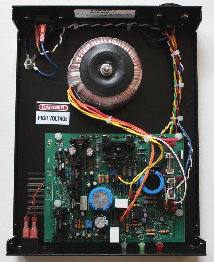

Beautiful inside.
Maybe, with a RFI/EMI Schaffner FN 9244B filter 1A it would still be better.
Thanks! The RF line filter is not a bad idea at all. It looks like there might be a fused version that even fits exactly in the existing chassis cutout, for about $16 US. I suspect those line filters are more often used to prevent RFI from getting out of an electronic instrument rather than in, but it would work both ways of course. Maybe I'll offer than as an option.
Scott
Trust me, it is a very good idea. And cheap!
I have a terrible mains (230V/50Hz), with more RFI/EMI, ripple and DC (I measure 3 Vdc !!!). I have gradually gone attenuating the noises / interference with Schaffner filters, RFI Würth 150 kHz ferrites and my loved DC & Ripple Blocker x4 ME (aka Maty Edition).
And voltage more near to 240V than 230V (for solving still: maybe a variac or new amp).
