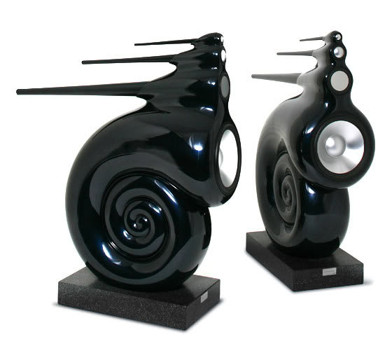

And when British engineers decide to minimize reflections they end up with something like this
