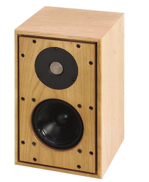

Sreten has put his finger on something interesting about cabinets in the "BBC" tradition, however. They do voices and midrange extremely well, while bass problems pile up around 100Hz. His "stereophile" spectral decay plot for the Harbeth three way shows this. It may be that since room acoustics issues also pile up around 100Hz, that you can get away with this. Personally, I don't get over excited about huge bass. Hire a concert hall if you want that. Waste of time in a regular room. :D
We should at least be able to "Spot the BBC influence" by now, as in this Harbeth small monitor:

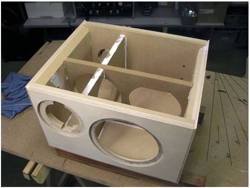

This SEAS CURV project by Troels has elements too, particularly in the polycone woofer and crossover, but not in the cabinet braces. Bit of a hybrid really.

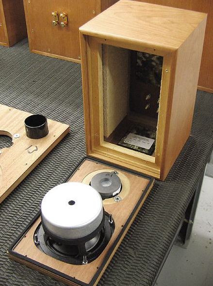

Putting the woofer on the back of the panel is mechanically a good solution. Phase needs attention though, and may not always work nicely.

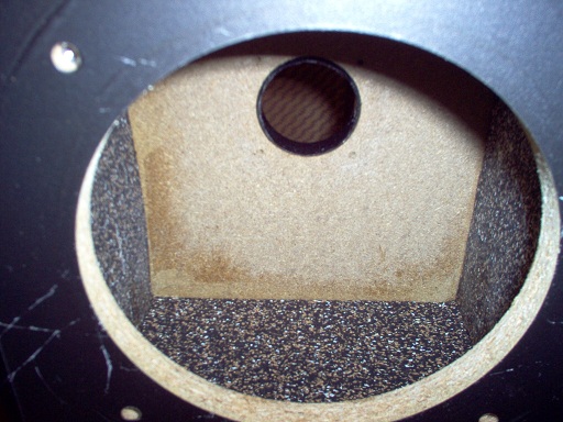

Battening is really for mechanical strength in BBC designs IMO. It's placed to do as little harm to the sound as possible and not necessarily butted closely. Removable panels are the "cracked bell" idea, and seem important. Damping pads were a surprise to me. They go on the smaller panels, in fact if you want to add more you double the thickness on the smallest panel. This creates a knuckle test that takes the smaller panels down in frequency to match the undamped big panels. Stuffing is kept to a minimum, which makes for an open sound, but maybe good cabinet ratios become important then.

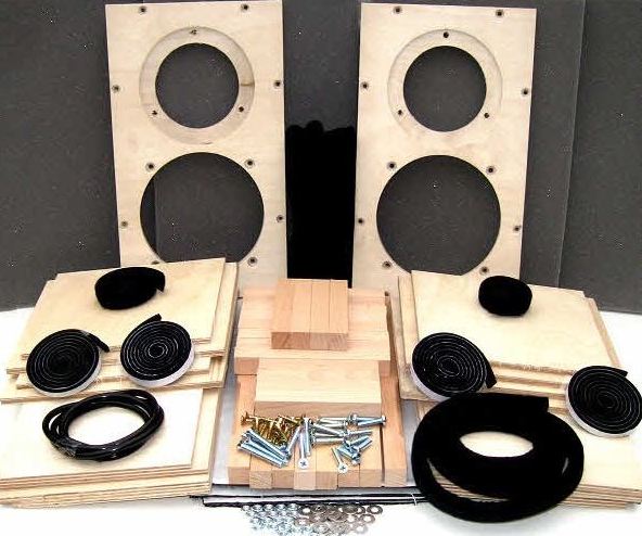

Falcon Acoustics do a 5L BBC-type cabinet kit that might save you some woodwork too. Not hard to redo the baffle to taste.
LS3/5a cabinet complete kit. All parts, hand-finished birch ply/beech battens to BBC specification. Easy to assemble.
