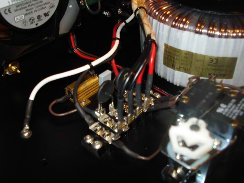

I was refering to Zenmod's answer to where the two CL-60 hookup.....he said to the same spot....I didnt know if they should be seperate or not, your info about 2 star grounds has me thinking, but Master ZenMod says they should go to same spot, sounds like you've come to same conclusion. Now I feel better about putting mine in.......for about a year now I've listened to this sucker without the CL-60s and power cords alligator clipped into position. What a lazy *** I am!Yeah, I answered it. I'm pretty confident 2 CL-60s go to one point on the chassis.

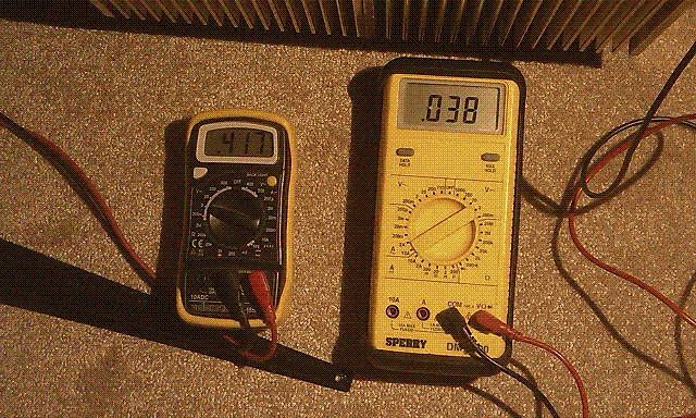

Well, the problem just went from bad to worse.
There are wild swings on DC output. Anywhere from -7v to +7v or more.
It won't stay put. On starting the amp cold across R12 it reads .29v and 7.xV.
With lid on, it warms up after 1.5 or 2 hours and the reading goes to .50+ and .250mV.
DC doesn't come down very fast. It takes the full 2 hours. This could be bad on speakers to have that much DC, correct?
This circuit doesn't use protection or thermal circuit. Maybe it's time to put it in?

Guess what I learned today? Lifting the PCB ground will make adjustment impossible.
I put the PCB grounds back at 0V on the PS. The output DC is stable now. The bias is stable too. I set it to .40 and will let it warm up.

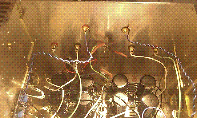

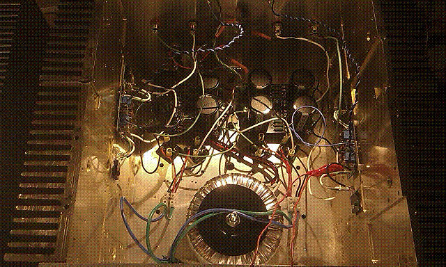

Lead dressing, and grounding
Although I'm relatively new to Class A audio, my DIY experience in scratch-building linear RF amps (tube and solid-state) really taught me lessons about lead dressing and proper grounding. I'd agree--some of your construction may be leading to your current problems. Best of luck. It's always tougher to run down a problem in a chassis that's "kinda messy".
Here's part of my F5 build, FYI. Yeah. It took a little time, but consider it an investment.

You guys are probably sick of me by now, but there's another development.
I stopped by Radio Shack and picked up a $17 ground loop isolator. I was hoping it would work and it actually does work...well. The sound did not degrade, in fact there is some extra bit of resolution due to a more quite background.
I'd rather not use it and use better cables, but it is a mental life saver.
Will also try to lift one shield as suggested earlier.

Are the cathcode or antode connected together without the thermistors? Is this safe?connect them using two diode back to back to earth ground
The cathode of one diode is tie to the anode of the other diode. In other word the two should be tie with the anode and the cathode together. This is save because diodes when conducting the voltage across the diodes would be only .5 volts to ground. This is better than the CL60. The CL60 should be use to delay the voltage between the rectifier and the capacitors. I had the same problem with my LM3886. When connecting the earth ground to chassis and the PS ground it is start the humming. I read this method in this web side so I decide to it try and it is worked. Some recommended also a capacitor across the diodes. Just try it as a test.
