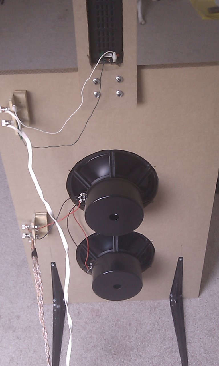

I have a 2-way system with a F5 powering BG Neo8 PDR planar tweeters.
The Dayton woofers are powered by a mini-Aleph. I have a hum in both lows and highs. The hum is always the same loudness, no matter how high the preamp is turned up.
In another thread Mr Pass suggested lifting the ground on the signal to chassis ground...I think. Did this on both channels on the F5. The sound now is fantastic; sound stage and depth goes on for days! I don't want to lose this! It's better than before, but the hum is still there.
The F5 and Mini-A do not hum when powering speakers without the active XO.
Before lifting the ground this evening, yesterday I unplugged one RCA plug from the F5, the hum went away in the other tweeter. Guess that broke up the loop? After lifting the board ground and unplugging 1 RCA plug, the hum is still there.
The active XO is a MOX II and all its RCA jacks are isolated. The F5 and the the BOZ-J also have isolated jacks.
I think the hum is between the amps and the Active XO, but I don't know what to do about it. I don't want to do anything unsafe. Any suggestions?

There are no caps on the open baffles speaker. The BG Neo8 is 8 Ohm, pure resistance. Do you think it needs a large capacitor on the tweeter?

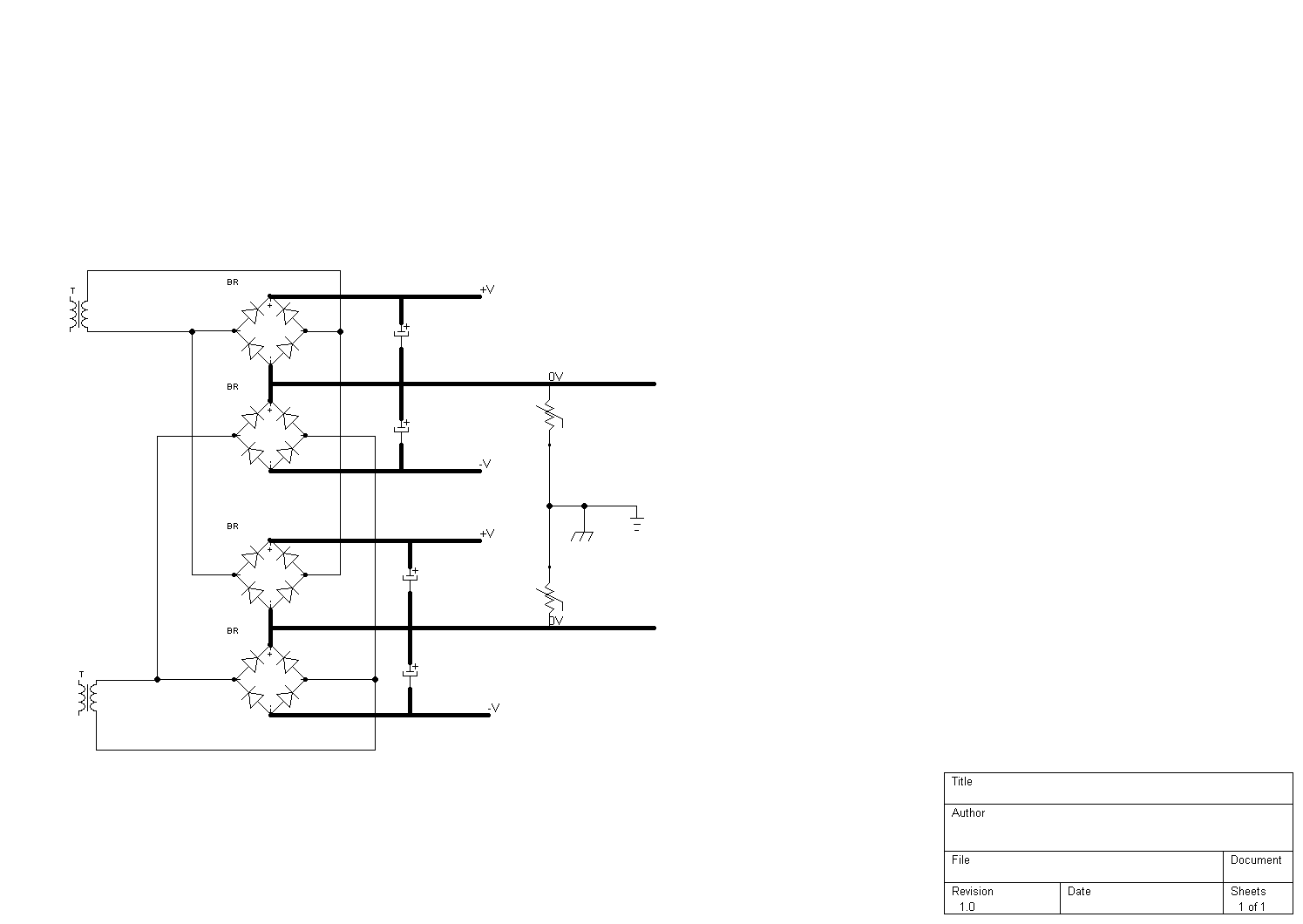

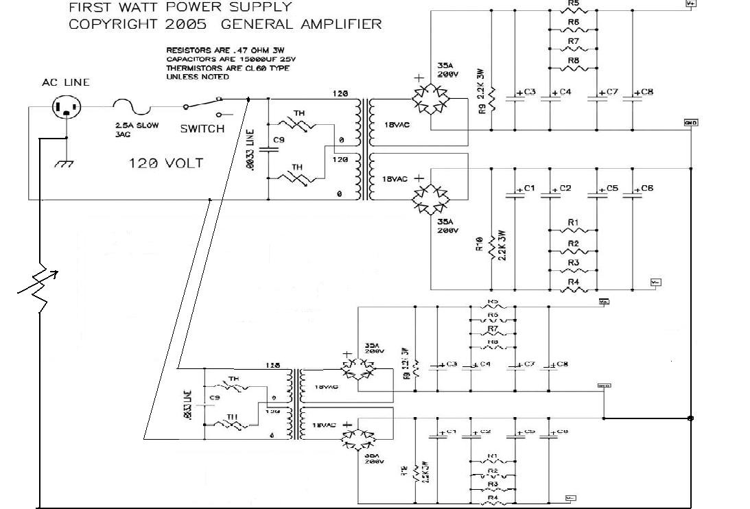

PS Wiring
I take it your PSU looks like this
Not even close as far as the bridge setup goes...
It's like the attachd jpeg, but with a thermistor for each channel.
Thought this was the recommended PS...
BTW- I also found a bad RCA jack late last night. If I shake the signal lead from inside the case, the hum gets worse.
Also, if I grab the twisted input leads to the F5 PCB, the hum gets worse as if I'm disrupting the field around the wirin..

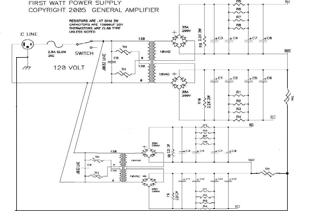

I see the problem, both 0V are connected together, remove the link to return it to dual mono construction. Discounting the source, the only link between them should be via the CL60 thermistors. I have edited your drawing to show this.

you have 2 Cl-60s to connect to ground, put them the same place
I've had it as you described all along. It's got to be the cheapo RCAs I used.
Anyone see a problem with sending all grounds (RCA shield, input ground, PCB ground and speaker ground to the 0V of the power supply board, then one wire running the power supply board 0V to each thermistor on the chassis?
