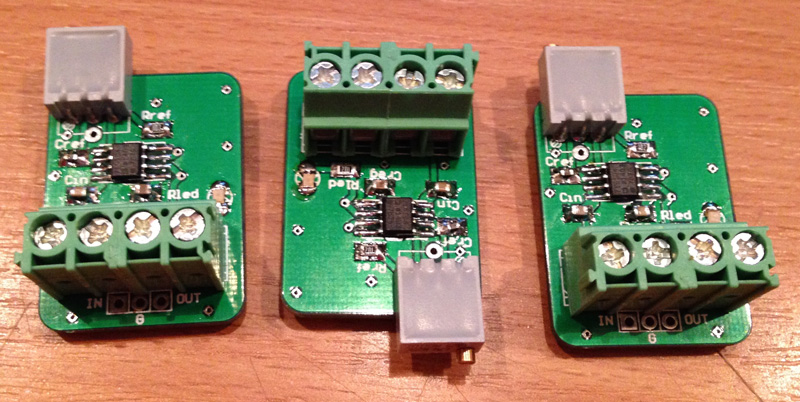

I have built two of these boards now. One of them is a ADM7150 with a fixed output of 3.3V and using a 100uF tantalum bypass capacitor. The other is a variable voltage version with a Rref of 10k and a 25k pot. The bypass capacitor in this one is a 1000uF, 6.3V tantalum. I am using the fixed 3.3V version for the Digital supplies for my ES9018 DAC and the variable one set at 3.8V for the Avcc.
My impression is that these are better than the TPA7S4700 regulators that they replaced. The improvement is subtle (like most power supply improvements are), not a big tonal change that might occur with say swapping opamps in the IV stage. I think the biggest difference is in the bass performance. This might be due to the very large bypass capacitor bringing low frequency noise to very low levels.

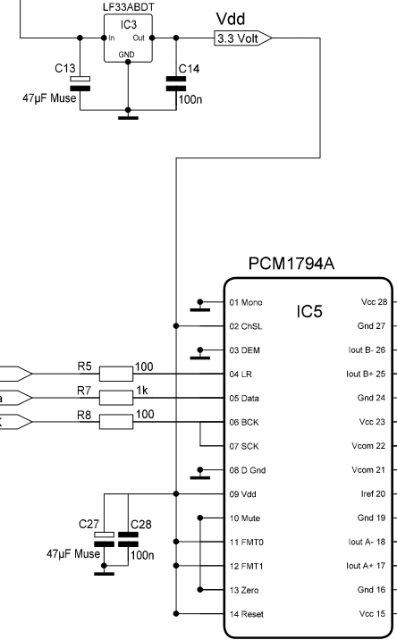

I was planning to use mine to replace a LF33ABDT in Doede's PCM1794 dac that is supplying vdd. The LF33 is setup up with 47uF lytic by passed by a 100nF film caps at its input and at its output. Should I leave those caps in place and just change the regs? Or should I remove any of the caps, at the input or output?
The lytics are nichicons, if I keep them I will replace the output lytic with an oscon most likely (it goes straight to the vdd pin of the dac chip).

Thanks Nikitas and themystical. I only have one board and provided my own regs, so it wasn't that expensive, but it's not cheap either!
I've attached a portion of the schematic for one board. I was originally thinking of removing c13/c14 but keeping c27/c28, but changing c27 to the same value oscon. But I will remove both sets of caps and put just the reg and see how it sounds. I'll report what I find!
I wouldn't remove C14 and C28 as they are decoupling capacitors at the pins of the IC's. I think you will find that the datasheet specifies these to be used to keep RF out of the chips and keep things stable. Personally I wouldn't remove the 47uF ones either unless there were some stability issues with your reg.
