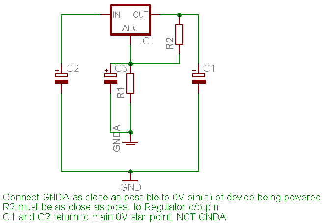

Why use such a high-tech (and high price) regulator and then destroy its performance by using a 3-pin connection ?
You right. This kind of design is a compromise to make it more accessible by replacing a standard 3 pins regulator. The chip it perform better when is used just close the the target circuit, with GND plane around traces, and so on. But then it will be accessible only to those who will use the whole assembly. Definitely not so popular...

What I'd be worried about here is that :
- The switching PSU generates, say 50 mV ripple @ 30 kHz
- The capacitor on the reg board... say 100µF... has an impedance of 60 mOhm at this freq, let's add the impedance of wires, round it up to 0.1 ohm.
- Therefore, with 50mV ripple, a ripple current of 0.5 amps will go through the capacitor... and through the GND pin of the regulator
- With, say, 10 mOhm contact resistance (if you use a socket) or even 1 mOhm (soldered) a voltage much larger than the regulator noise will be added to its ground reference, and thus to its output voltage
Therefore the main problem with the 3-pin format is not the regulator ground current (which is very low) but the capacitors. This makes the regulator PSRR irrelevant. So the input caps should be on the main board.
3 pin format only works if the GND pin carries no current ! This means the IN and OUT current are the same. No capacitors allowed.
The same could be said for the output caps,if the load draws a variable current...
If the output caps are on the reg module, then they can't be on the main board, which is a problem. So IMO it is better to leave the caps on the main board.

There are not filtering caps on the regulator board (at least in my design). But the caps recommended by the producer for decoupling the in/out of the chip
There are input/output caps on the regulator module, so the ground pin of the 3 terminal connection will carry AC currents from the PSU ripple and load current,. This will corrupt the ground reference, and the performance of this regulator will not be better than a LM317 (it could actually be worse), unless the load draws a constant current and the incoming power supply is already very well filtered, in which case, one has to wonder why using an expensive regulator with such high PSRR and low noise...
What do you mean by "main board"?
The board the regulator is powering, like a DAC for instance?
Yes. Decoupling caps are always located electrically close to the load... the inductance of a properly mounted hand-solderable SMD ceramic is lower than 1nH. The black-box POSCAPs that Coris used, again when properly mounted, are about 1.5 to 2.5 nH, that's equivalent to a wire loop of about 1 to 1.5 mm2 area... putting them on a daughterboard with a 3 pin connection will add 10-50x more inductance, it is a waste of a good capacitor, you could use a noname electrolytic, the load wouldn't see any difference.
The regulator module should only have the reference bypass caps, so that almost no current flows in the ground pin. If this makes the regulator unstable, you need shorter connections.
If you want to extract the full performance of this reg while putting it on a daughterboard, you will need at least 2 ground pins, one for current and one for sensing. 2 output pins (current and sense) are also a plus.
It's not that hard :D Peufeu explained exceptionally well, maybe just a picture for better understanding
