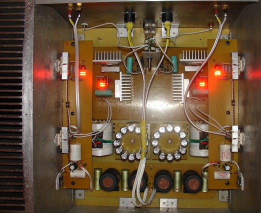

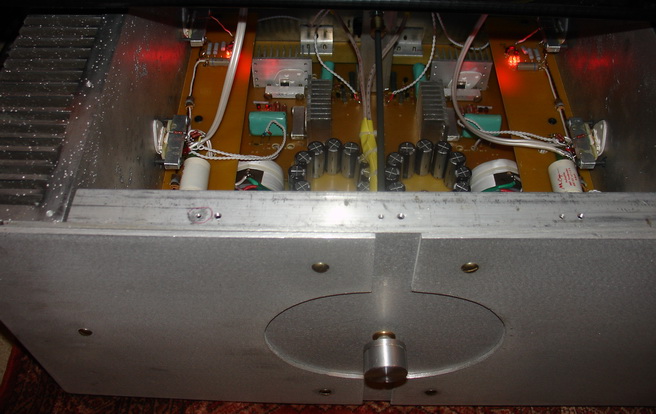

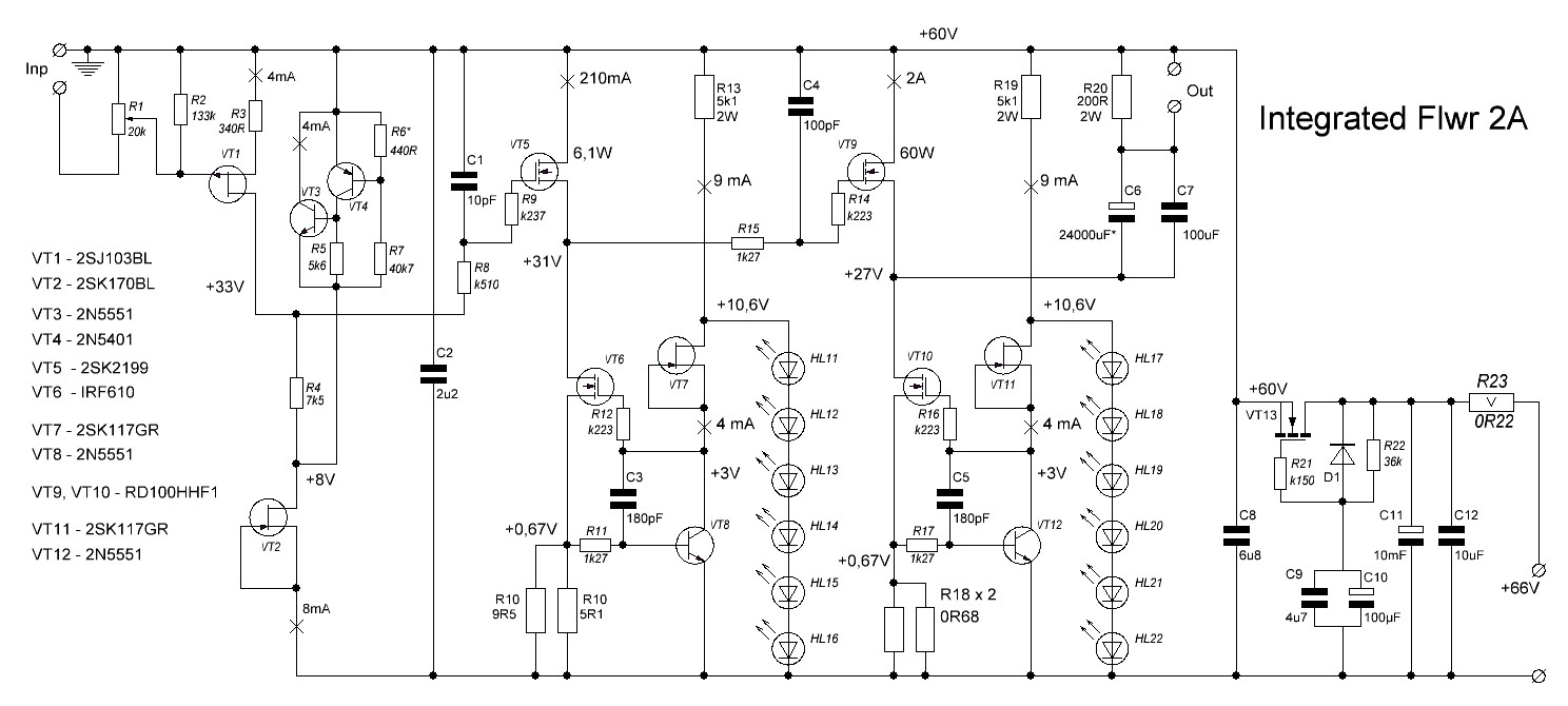

Here is almost completed integrated amp, which unifies No NFB headphone amp/preamp with the Modified Follower. As expected, sounds exellently.
Output "cap" is a ring-like cluster of 1000uF low-ESR caps (SamWha WL) with 100uF polypropylene shunt (Solen).
Current was decreased to 2A, since with 60V power rail power dissipation goes to high for a single transistor.

Some years ago I was inspired by Nelson Pass for building Zen4 and Zen9, then I wanted more and more power from them, and this has ended up by ordering of 6 big custom made (machined) heatsinks. Since that time, only Zen9 (4,8A current, disconnected CS modulation) is living still, another two pairs of heatsinks have travelled to follower-based designs.
Now the Son of Follower is being breaking in. Pass's style has touched a bit this creation.
I would also like to mention, that VT9 and VT10 can be easily replaced by more obtanible MOSFETs, since output impedance of the driver stage is nearly 2 Ohms (it is possibly a record value). I used to connect the driver stage directly to loudspeakers, and sound was quite listenable.

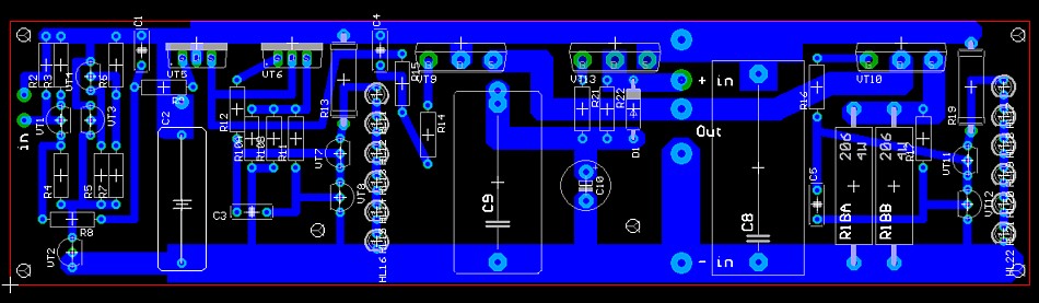

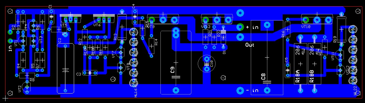

PCB
A possible PCB for the power amp.
The board is not include the large capacitors and two resistors: C6,7, 11, and 12, the resistors R20, 23 and R1 the potentiometer.
The size is 17.8x4.5 cm (7x1.8 inch).

Since getting HF transistors is not an easy task, I would propose using K1530 as VT9, VT10. At this, R15 and C4 could be decreased for preserving the passband of the amp.
Also, now I can state that the Low-ESR SamWha WL 1000uFx63V, in the cluster arrangement, give very good result for the output cap. Of course, one could test also Nichikon KZ or Elna Silmic II, for instance. With 100uF polypropylene shunt, sound easily competes and outperforms that of a good tube SE amp, at all frequencies.

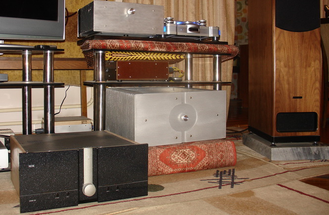

Testing of the Son of Follower goes on, the reference is a high-end tube 300B SE amp from NEM (Novosibirsk), also integrated amp.
The tube amp needed nearly 200 hours for burning in, while the S of F - only 20 hours. There is no frequency range, which is better performed by the tube amp.
Looking good.
Seems the 300B amp as big as your Son of Follower.
Why the difference in the burning in times?
Looking good.
The 300B amp belongs to the family that got several prises at Las Vegas, High-End cathegory. Its weight is 65kg, and output trafos are big and designed for 4 Ohms load. Also, PS includes vacuum rectifier, big choke and Black Gate caps. Output impedance is 0,6 Ohms.
Long burning-in time, I guess, is usual for trafo-based devices. Capacitors and solder joints are much easier in this respect.
With the follower-like designs, by improving output cap, one can really achieve all that tube SE excellence.
