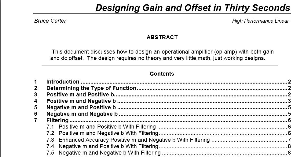

Mooly,
y = mx+c is the standard equation for a straight line function.
m = slope or gradient or "gain"
c = offset from origin.
Using an op amp, m is defined by gain ratio -Rf/Rin etc, and c can be an addition fixed input summed to the output.
AFAIR (a LONG time ago!) this will need two stages, the first setting the gain, the second adding the constant. Polarities will be tricky, even more so with only a V+ supply.

Sounds like OP-AMP 101, using an operational amplifier to solve an equation?
A good 'ole analogue computer from way back when
