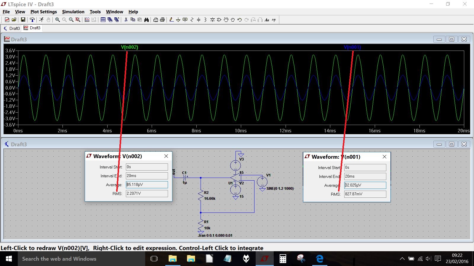

amplify signal of mv to +5V, with high accuracy, stability and sensitivity

Well that's a really low gain which means any common opamp will work.
Next you have to decide whether the amp it to be inverting of overall phase or not, and then based on that calculate the basic value of the gain setting resistors.
Now you've shown that you can use LTspice so I'm not going to do all the hard work for you (and you won't learn anything)
Fig #1 in this document shows non inverting and figure #2 shows inverting. Calculate the resistor values you need and put them into a real (well a simulated) circuit and prove you have them correct.

I tried this way also, but rather then becoming an amplifier it becomes voltage follower. I read some where with such low input voltage, op amps gives a max voltage of 3.5 and not more then that.
That circuit is OK but you don't at this stage need to add an offset to the input voltage. Your gain calculates out at exactly 2.666 and LT confirms that. If you divide the rms value of the output voltage by the input as shown by LT you get 2.66599
Opamps can give gains of many hundreds, many thousands even.
Do you want it to have an offset ?
If the amplifier is to amplify any offset present (because then the offset is a valid part of the signal) then it needs to be a DC coupled amp running on dual supplies.
If you want to ignore the offset then you need to AC couple the input (and then you can use the single supply).
