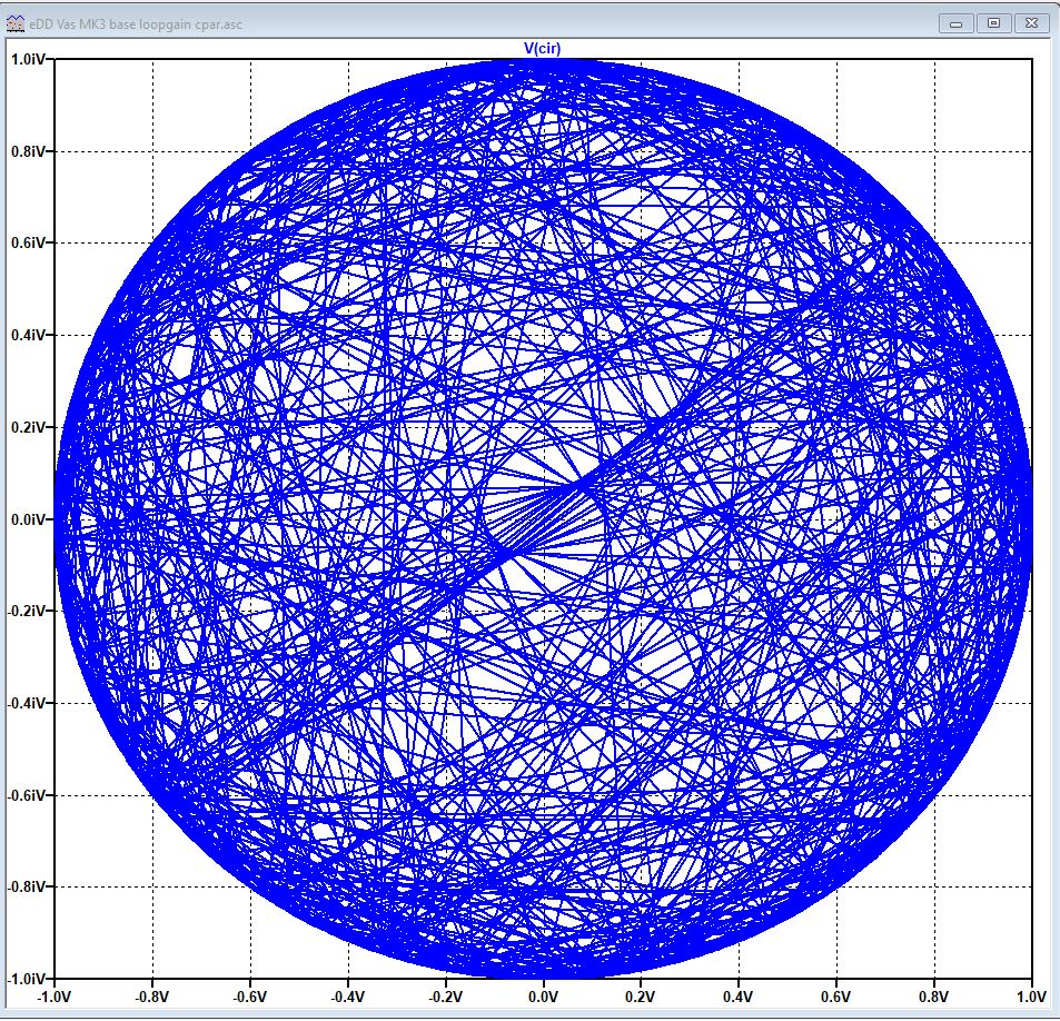

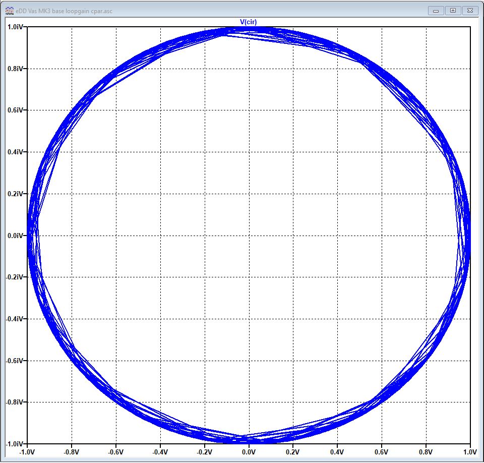

The issue is the freq range analyzed versus the period for the waveform.
Someone at the Yahoo LTspice forum suggested this:
But if I increase the freq range for the .ac, or the period in the param statement, the circle progressively becomes a 'ball of wound wool', filling up from outside to inside! See attachments.
Which I believe can be taken care of by making the period a specific fraction of the stop frequency.
Code:
The following delay.net file:
* delay
B1 out 0 V=V(src) laplace=exp(-s*period)
V1 src 0 AC 1
.param period=50us
.ac dec 1000 2k 30k
.end
... produces a perfect circle when you
look at V(out) in Nyquist view with linear axes.
The other ways of drawing the circle probably had a similar issue.
Jan

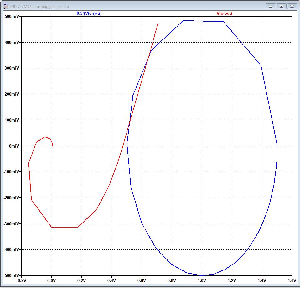

Try increasing the number of steps in the .ac line, you are seeing interpolation between datapoints.
Also you are plotting multiple-turn circles, so the datapoints are a lot farther apart than they need to be.
Anthony, that does not seem the case. Less points leads to a circle circumference that starts to show line segments instead of smooth curvature, but does not influence the '# of circles' so to say.
20 points vs. 2000 points.
Jan

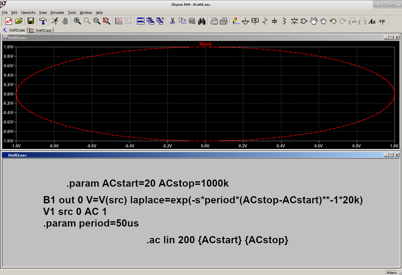

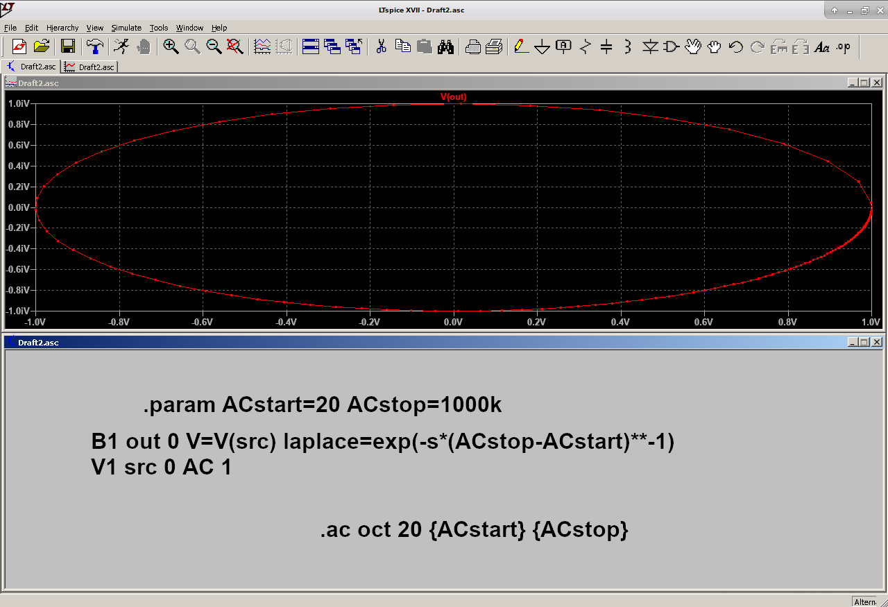

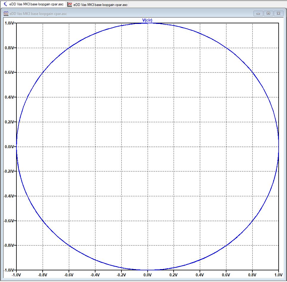

Jan, I played with it and figured out how to limit the circle to 1 turn and not waste data points. You have to let the Laplace transform know over what BW it needs to plot the circle, otherwise the circumference will change depending on the AC settings.
EDIT: sorry, that one was bad. Image updated.
To get an even smoother circle, set the AC analysis to linear. With logarithmic frequency the points concentrate towards the high frequencies.
Excellent!
I guess the 20k in the Laplace is related to the 50uS period.
Can that also be parametrized and made dependent on other parameters?
I mean, period = 1/20k which is the frequency you put in the Laplace. Why 20k?
Edit: if you make that 'test freq' = 1, and the period 1/1 = 1, it also works fine.
So the final then becomes:
V=V(src) laplace=exp(-s*(stopfreq-startfreq)**-1)
Thanks,
Jan
Yes, I just realized that. I thought the period was a Laplace variable. Ah, what will I do with myself. :/
It could be simplified to laplace=(-s*ACstop**-1) if you can tolerate a small gap in the circle.

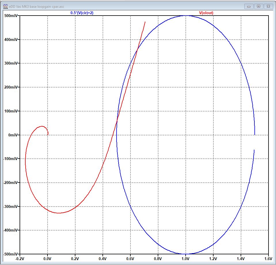

So to wrap up so far: the blue curve is the 6dB gain curve. If I understand the theory correctly (not 100% sure yet) this shows that at some frequency the gain margin is minimum at 6dB. That freq being about 1.3MHz.
Thanks guys, this was a very nice exercise, learned some new tricks thanks to you.
Jan

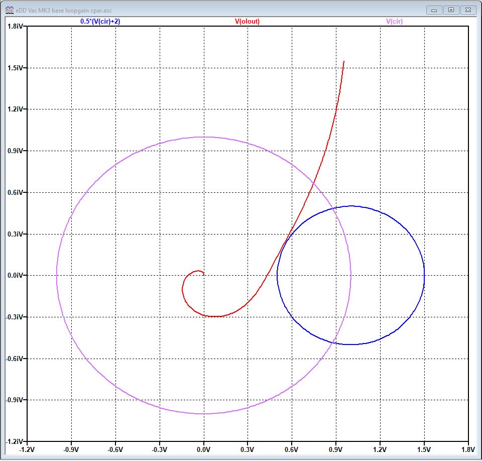

Simplest circle so far (courtesy Helmut Sennewald over at the Yahoo LTspice user forum):
Behavioral source (B): V=delay(V(src),1/(stopfreq-startfreq))
The floodgates are open: he gave at least three new ways, in various forms. If you really know LTspice (I don't yet) the sky is the limit!
Jan
