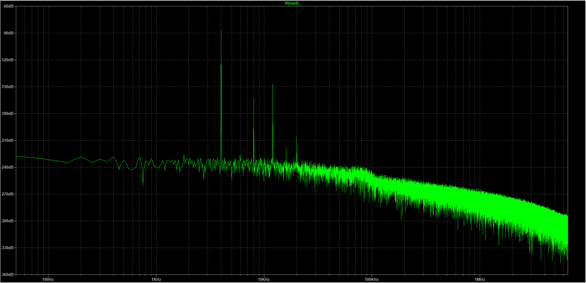

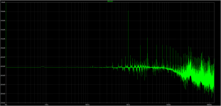

Using the procedure described in the tutorial at post #19 at 4kHz with.
.tran 0 250ms 230ms 0.0190734us
.option
+ plotwinsize=0
+ numdgt=7
+ noopiter
The simulation takes 10 minutes and I get the pretty good-looking FFT in the first screenshot.

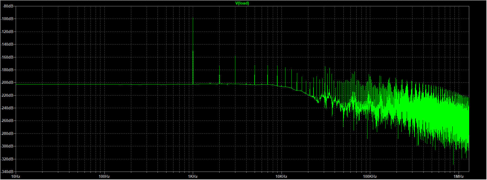

With the keantoken settings shown in the second screenshot (note "points=12") the simulation takes 2.7 seconds (great!) but the FFT is as shown in the third screenshot.

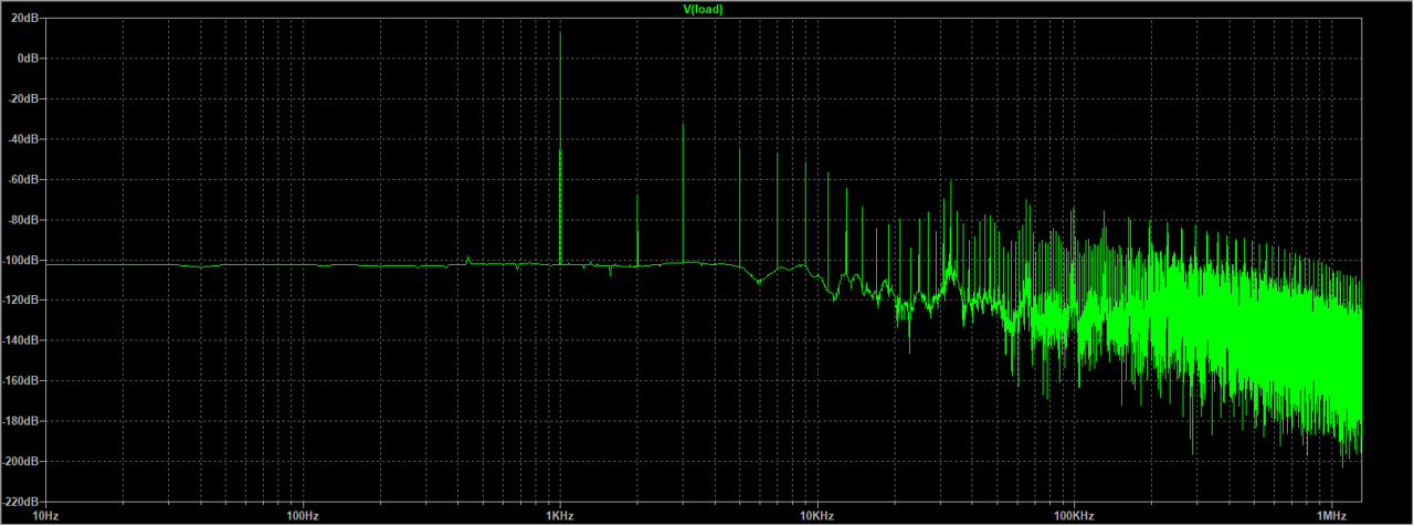

The very noisy FFT with "points=15" is shown in the 4th screenshot.

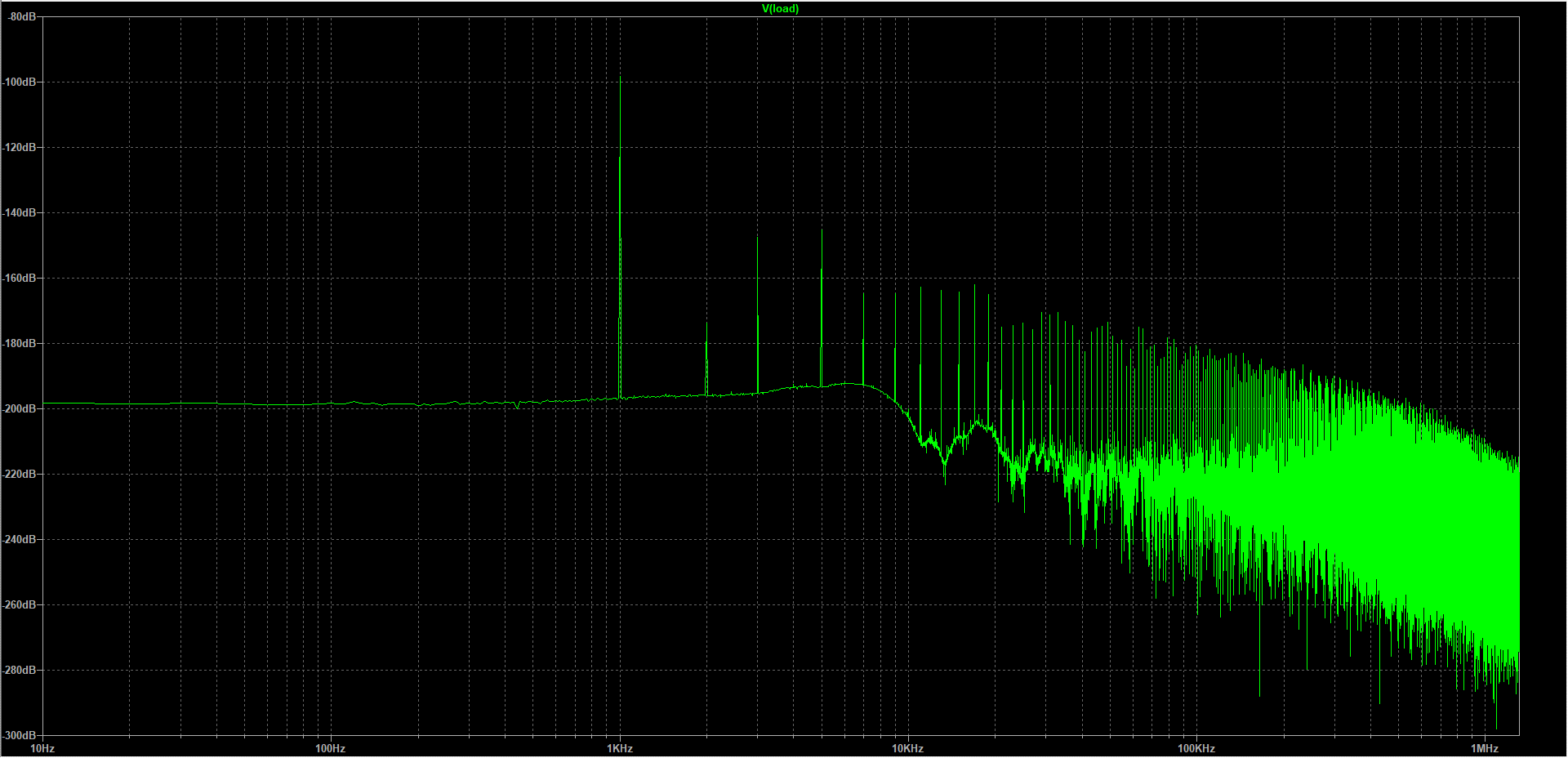

With trtol=100 I was able to get the improved FFT shown in the 5th screenshot.
Any way I can improve on the behaviour above 10kHz?

In principle only 'maxstep' sets the resolution/precision of your simulation, using TRTOL or RELTOL (and possibly others) will only lengthen the simulation (to make it more precise) , it seems to me that the first picture shows a more than decent FFT 🙂 if you want it faster you need to make 'maxstep' larger and then experiment, but (as the points=15 version is not what you want) it will slow down the simulation, and after spending a lot of time, you may return at the first (picture, points=16 I guess).
In general, tinkering with these (and other) parameters is only to be done when things do not function, when it functions 'maxstep' is your friend.
Maybe you need a faster computer 🙂 but, be aware, even on my dual i7 at 4G I have simulations than run for a few hours.

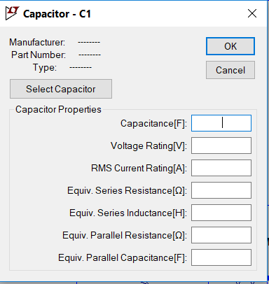

1 is 1 Farad. 1F would be 1 femto farad.
Thanks! Duh but of course! 😱

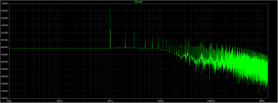

With 0.1uF capacitors I get the FFT shown below.
The tutorial suggests using very large capacitors so that brings me back to my original problem. Larger capacitors cause slower sims or when sufficiently large, the "time step too small" error.
100uF takes 25 seconds but the FFT looks the same.

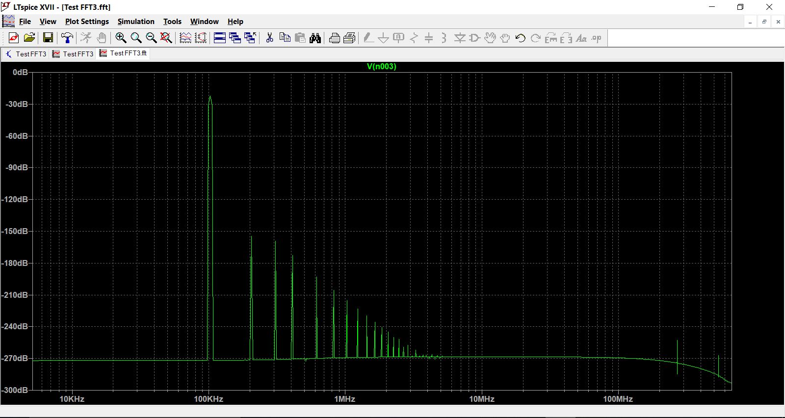

Different frequency range and circuit of course but I was hoping to obtain something like this from post #1301.
Is that possible?

I'm not sure what to suggest with your sim as its quite a complex design with a lot going on. Any caps across perfect voltage sources can be removed, any caps decoupling voltage sources (such as C, C3 and C10) can be removed and the voltage at that point replaced with a voltage source. Measure and record the DC voltages and then set a voltage source to equal the reading.
I'm not sure how wound components would behave tbh. They are reactive like a cap and so it seem logical to suppose they influence the result in similar ways.
I've always stuck to the longhand method of calculating the sim parameters, mainly because I don't fully understand the other methods in enough detail, and also because trying to push the noise floor ever lower is in reality something that wouldn't be achievable anyway in real life... its more an academic exercise to me.
If a sim has for example an FFT with peaks at -60db or even -90db then it doesn't really matter if the base noise floor is -150, -300 or -1000db, the peaks you are looking at are still accurately shown.
Yes, all I'm looking for is reliable harmonic indications out to 20kHz and realistic THD estimates.
Quick turnaround would be nice because I expect to be refining a number of interacting operating points to provide a starting point for an actual build.
Sorry to disagree - 1f (or better: 1fF) is one femto Farad in a cap. 1fA would be 1 femto amps in a current source ;-)

The problem I had (back when I puzzled over this) was in seeing the expected (well that's how I read it) unit to be F and to me F = Farad. The expected unit for volts is V.
It seemed entirely logical to me that if you enter 1 in the voltage box you are entering 1 volt, similarly entering 1 in the capacitance box would be 1 Farad. As we now know, it doesn't quite work like that.
