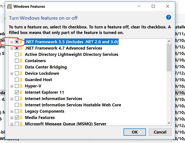

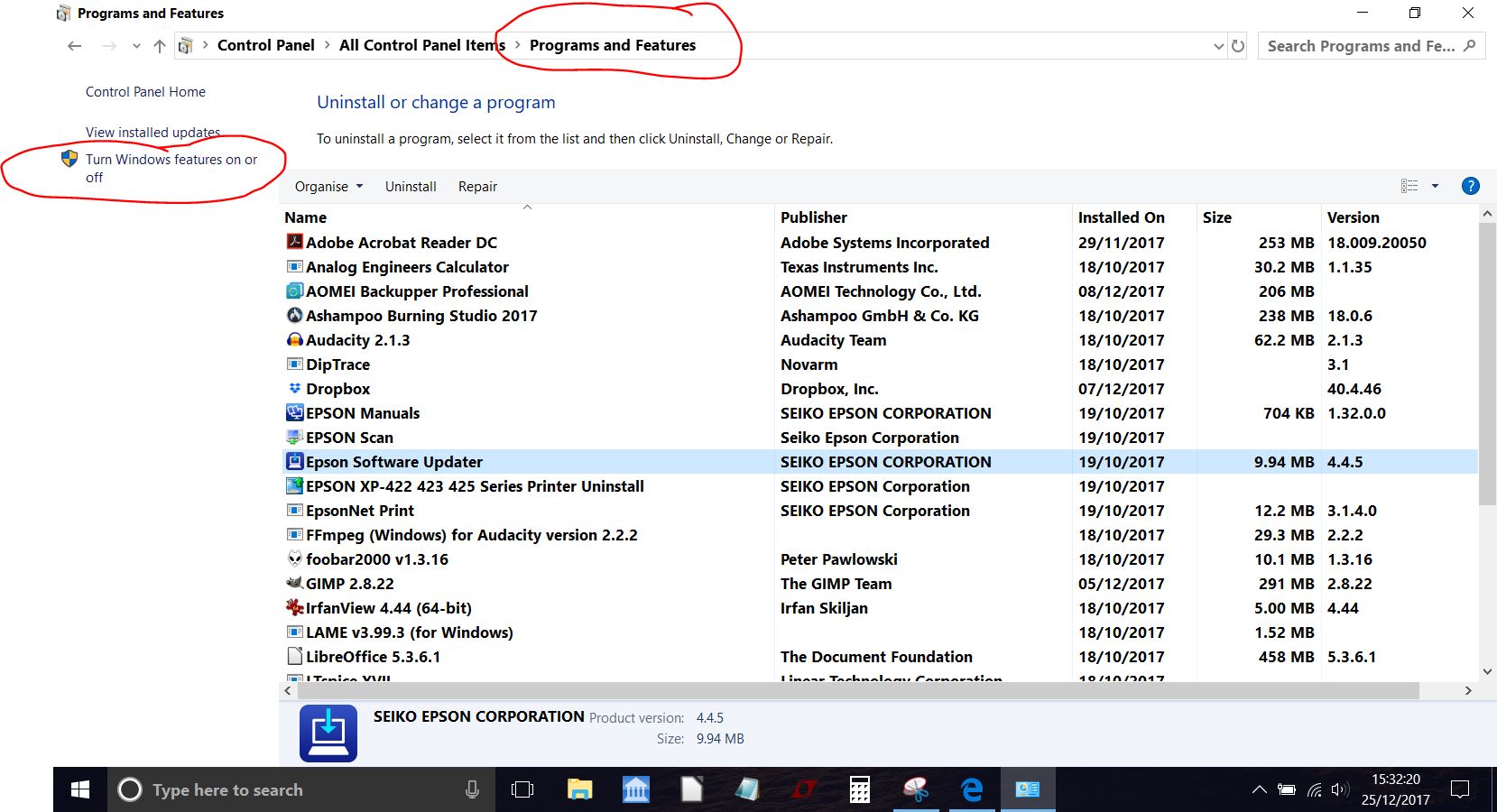

Try 'Control Panel' and then 'Programs and Features'. At the top left it says 'Turn Windows Features On or Off'
Enabling this will conect to Windows Update and install the required files. It only takes a few minutes from memory.
Odd though, you would think XVII would be suitable for the default W10 installation.

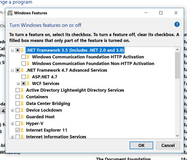

I checked in the settings and both .net 3.5 and 4.7 were enabled. BUT under the .net 3.5 entry were two sub-entries that were NOT enabled. I did enable those as well and so far, no more crashes. But only time limited test. Hopefully this is solved now.

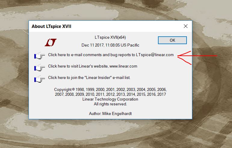

I've found Mike Engelhardt very approachable over any quirks or issues... he can be reached via the inbuilt link in LT and normally replies after a few days.
If it really does seem to be a specific circuit and you could share then send him a copy (plus a model sheet as appropriate).
