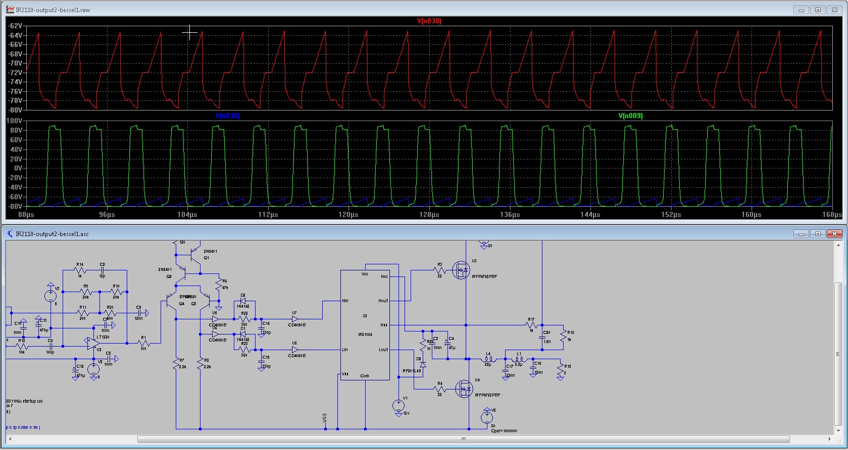

some question for the LTspice specialists here.
Why I get such a bad drive signal for the lower fet?, it looks not very good, I get the deadtime not right that way
Maybe @analog do now because he did make them.

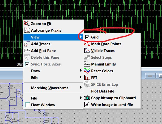

I have two issues with LTspiceXVII:
- I can't get the grid in the waveform viewer to show. I can set the color preferences and it shows the grid in the little preview window, but not in the main waveform window. Anybody know what I do wrong?
- Every 10 minutes or so, LTspice crashes. A nuisance. It happens on both computers, a laptop and a PC, both running W10 Pro. Anybody seem this too?

Hi Jan,I have two issues with LTspiceXVII:
Jan
I have no idea why your systems are crashing. I'm using LTSpice on a very frequent base with complex simulations taking sometimes more than 60 minutes. Never had a single crash with XVII using W10 nor with version IV.
In the Command Bar select "Plot Settings" and you can select Grid on or off.
