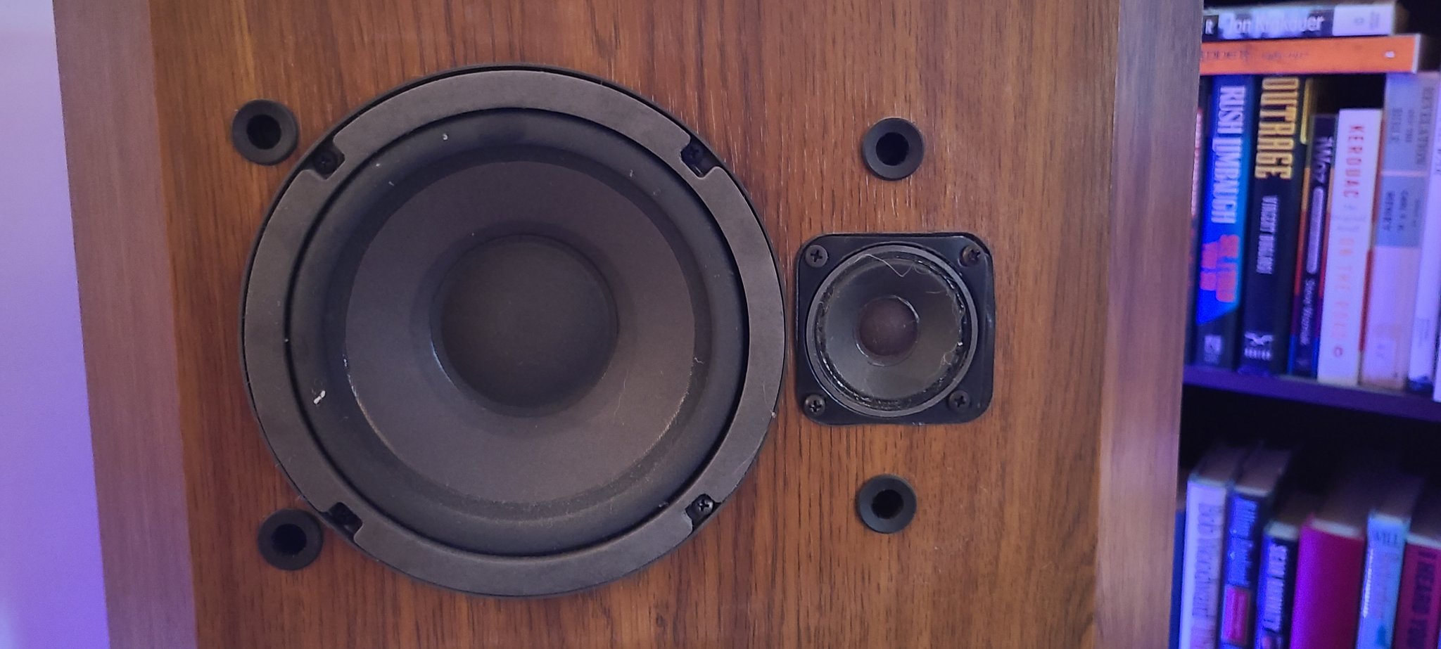

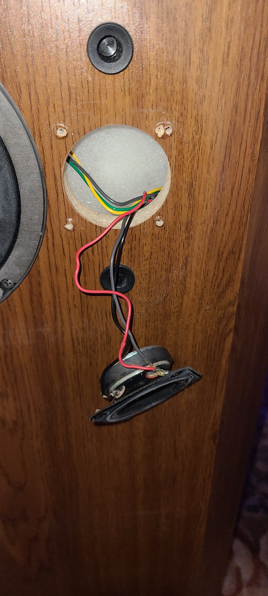

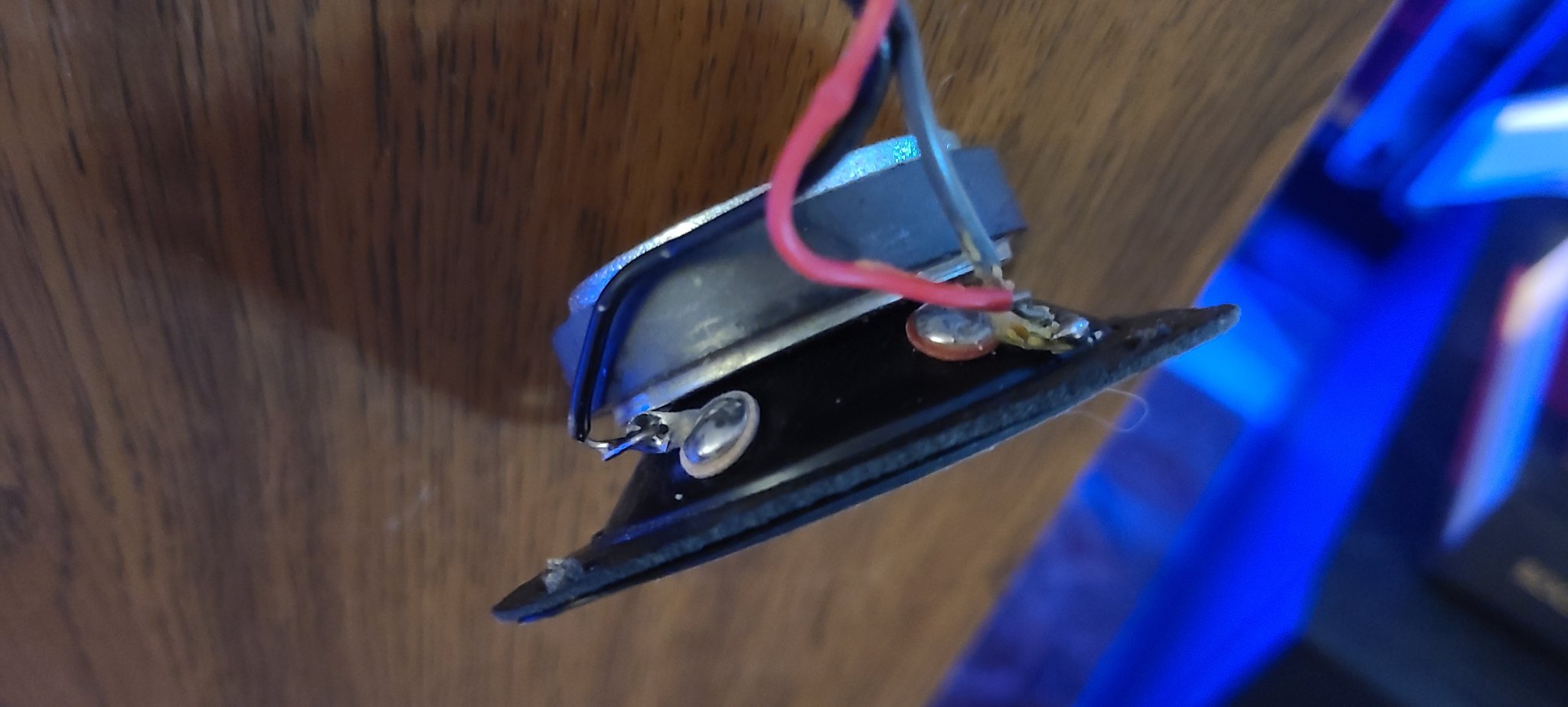

I am new to this site and am hoping you guys can assist me with some improvement modifications to my pair of Bose 401's I picked up at an estate sale. The cabinets are in perfect condition, the grills are good and original, and the drivers and tweeters are fine (I replaced one tweeter with a replica of the size and specs that was broken.)
As seems to be the case with these speakers, the highs are muddled. Those from the left tweeter almost sound as if the tweeter is blown, but it is new, so that is not the case.
Welcome to the forum!
In the first instance you should replace the tweeter's ageing bipolar electrolytic capacitor with a modern equivalent.
Over the years, electrolytic capacitors can change significantly in capacitance and series resistance values.
Replacement will return the capacitor to the original specifications and hopefully restore the missing 'sparkle' to the tweeter.
I suggest you try this before attempting any other modifications then report back on your findings.
P.S. A photograph of the capacitor will confirm if it is an electrolytic or film type. Bose used a film (polypropylene) type in the 301 Series II I renovated.
It the 4.0 uf capacitor has two pinched ends, it is electrolytic and suspected of excessive age.
If the ends are not pinched and it is marked PP or MKP somewhere, is it already polyprophylene.
Here is one source of suitable capacitors in Ohio. https://www.parts-express.com/Dayton-Audio-PMPC-4.0-4.0uF-250V-Precision-Audio-Capacitor-027-226 Another supplier in Florida is Madisound. Also USspeakers
Usual suppliers like digikey, newark, mouser, do not usually stock >100 vac polypro capacitors. The one I listed is a 250 vac, good for >800 w/ch use.

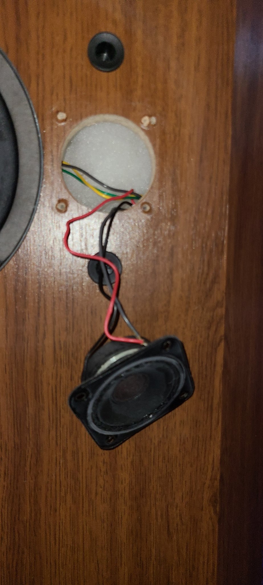

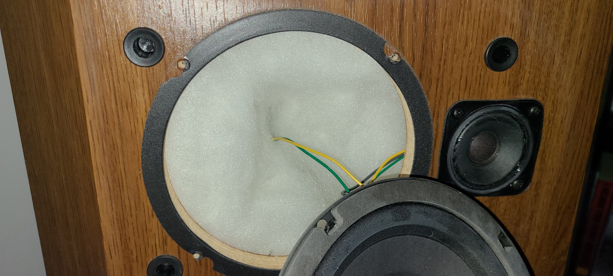

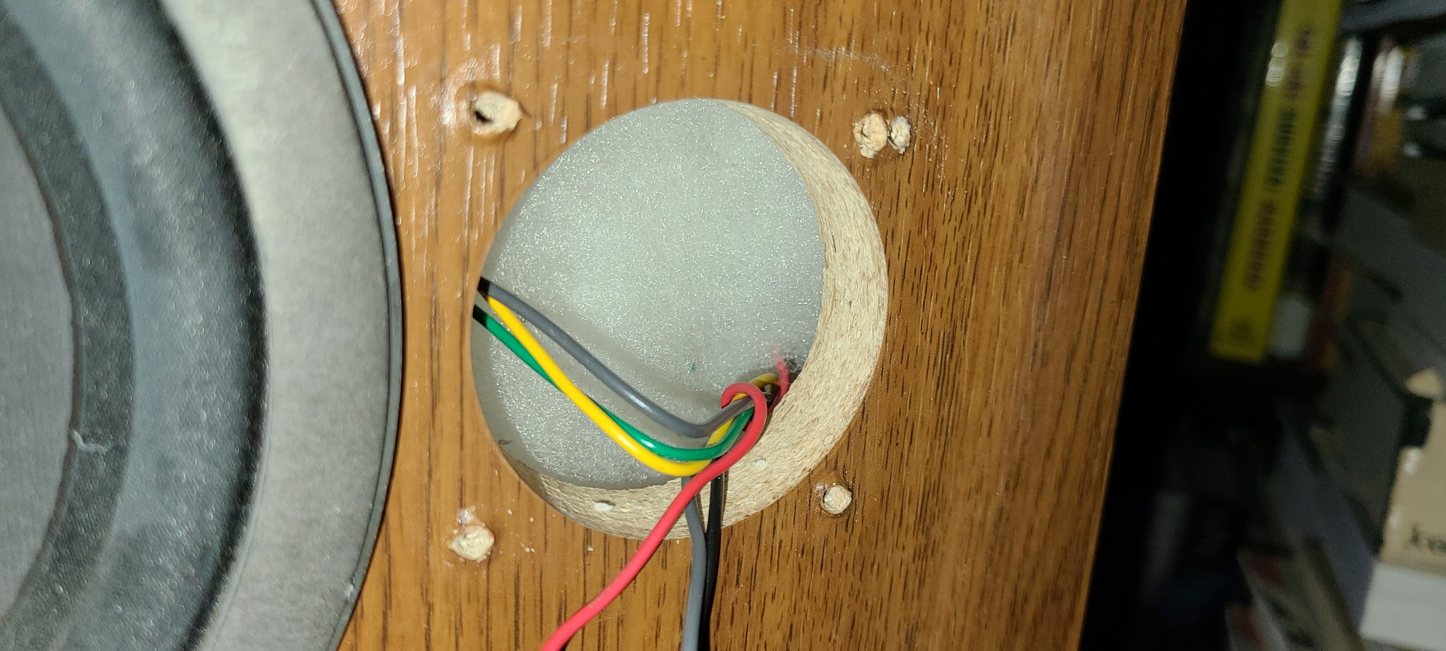

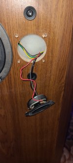

Where do I find the caps? With poly-fill so jam-packed inside the cabinet, I am unable to find them. Since the cabinet is not able to be opened without damaging it, please let me know how to locate those caps.
Thanks!
Thanks!

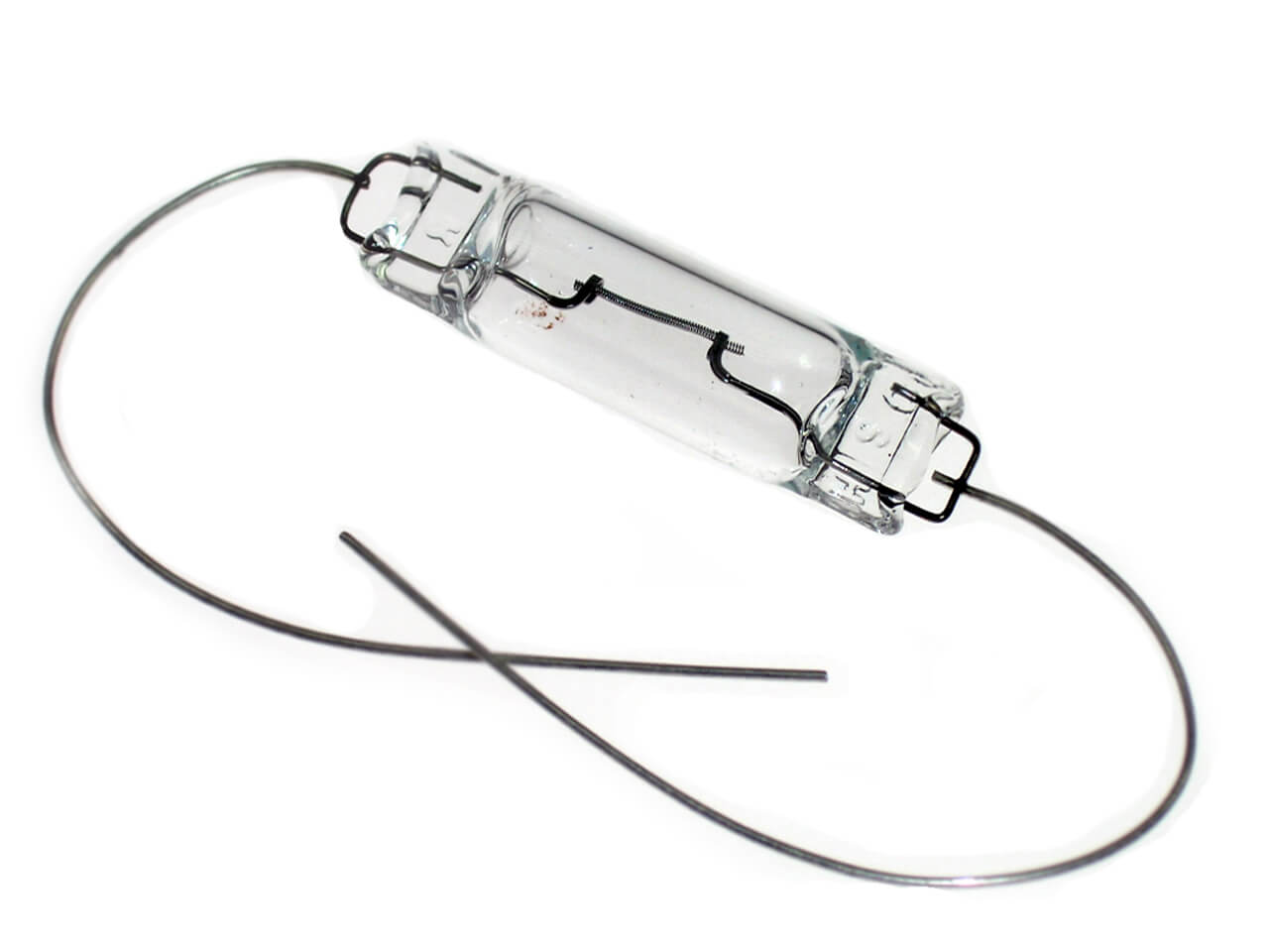

For your information, the capacitor and protection lamp are wire wrapped to posts screwed into the enclosure wall.
When removing a wire wrapped component, snip its leads at the posts but don't remove the wire which is wrapped round the posts.
The replacement component can then be soldered to the wire wrap instead of directly to the post which, not being copper, may not take solder.
P.S. Work with the speaker on its back so that no strain is placed on the wiring by dangling drivers!

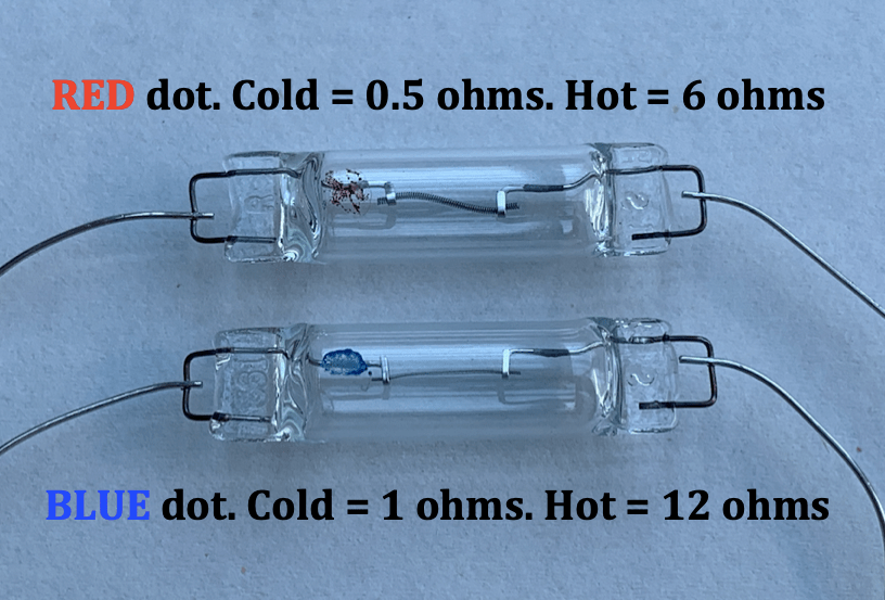

There are three different values used, designated by a colored dot on the lamp.
I believe it is a red dot that is fitted in the Bose 401.
P.S. I'm aware of the red and blue dots (see attachment). I'd be interested in knowing about the third value.
Check if there is something on the back of the terminal block.Where do I find the caps?
