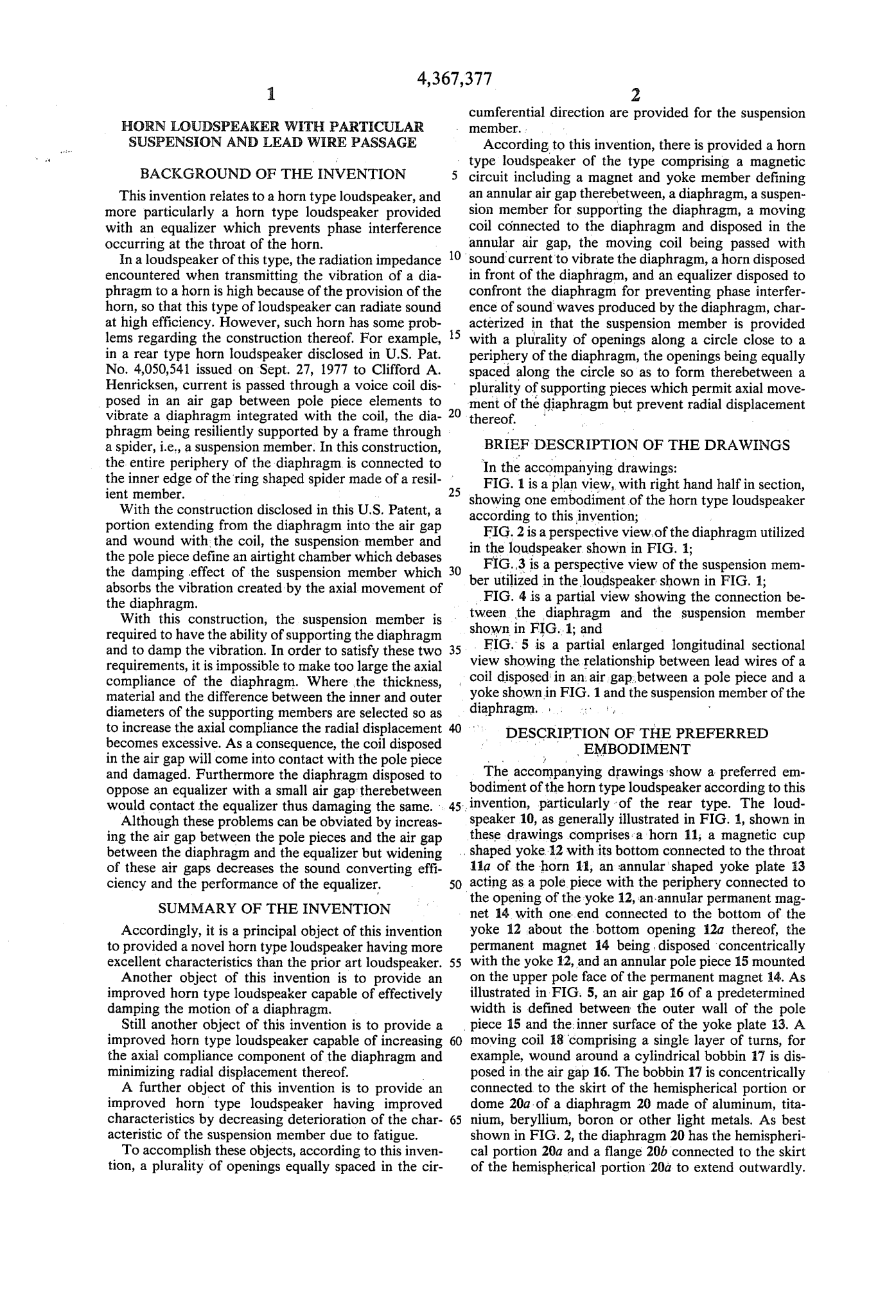

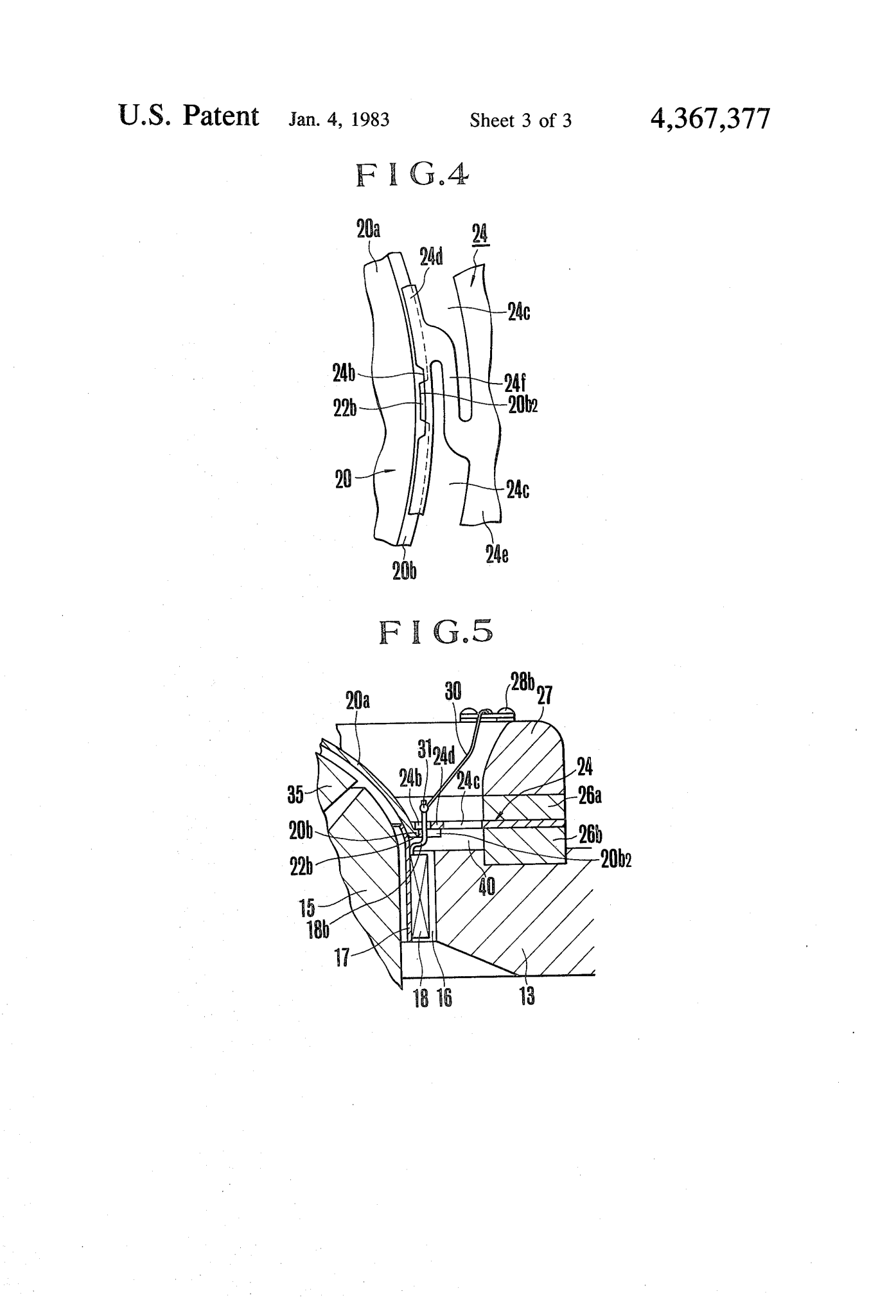

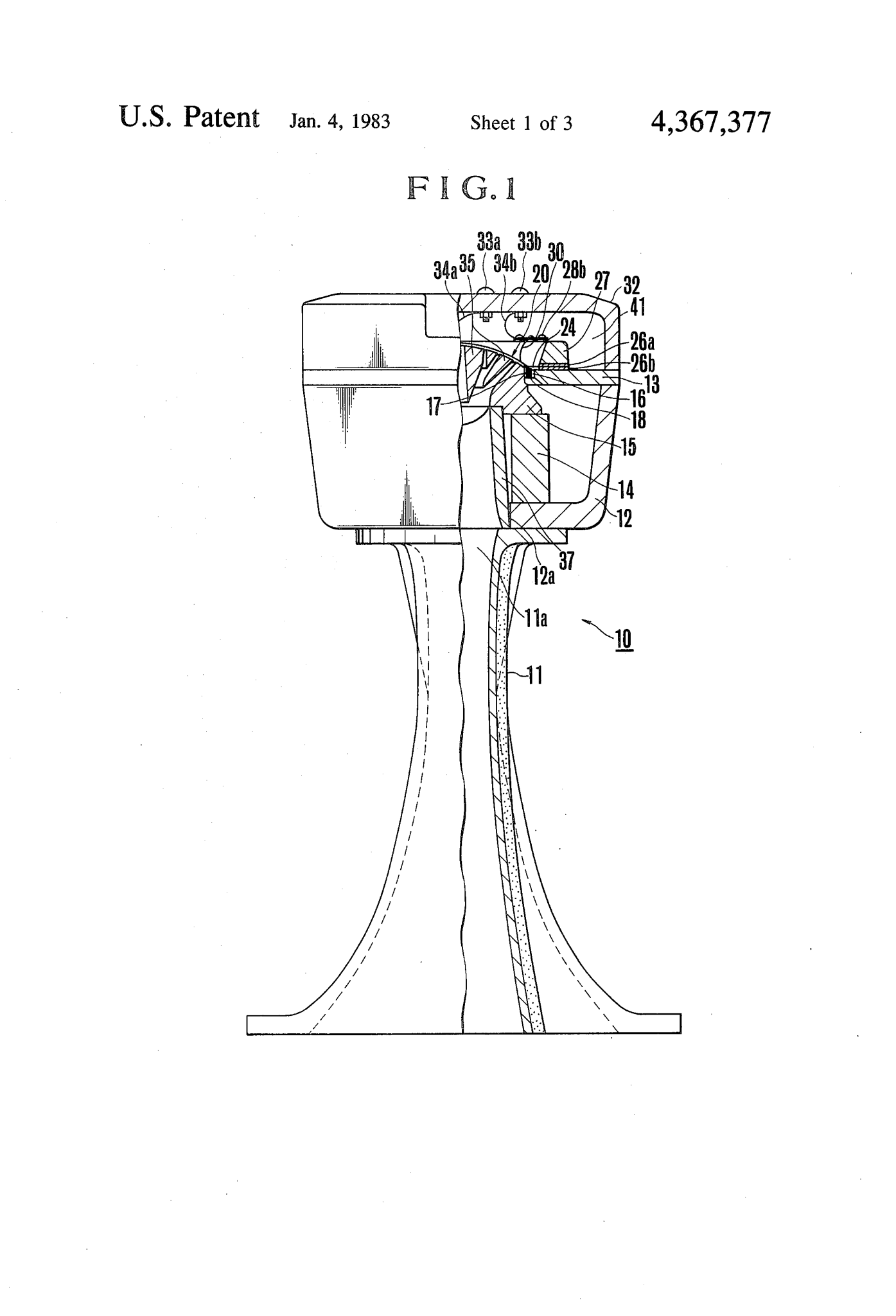

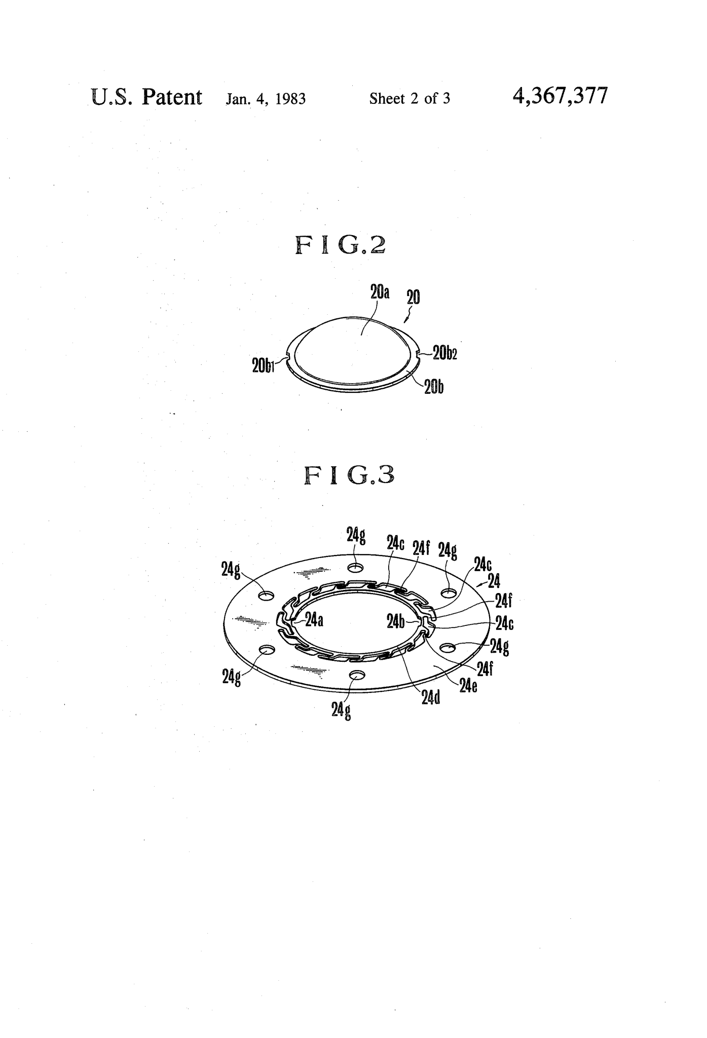

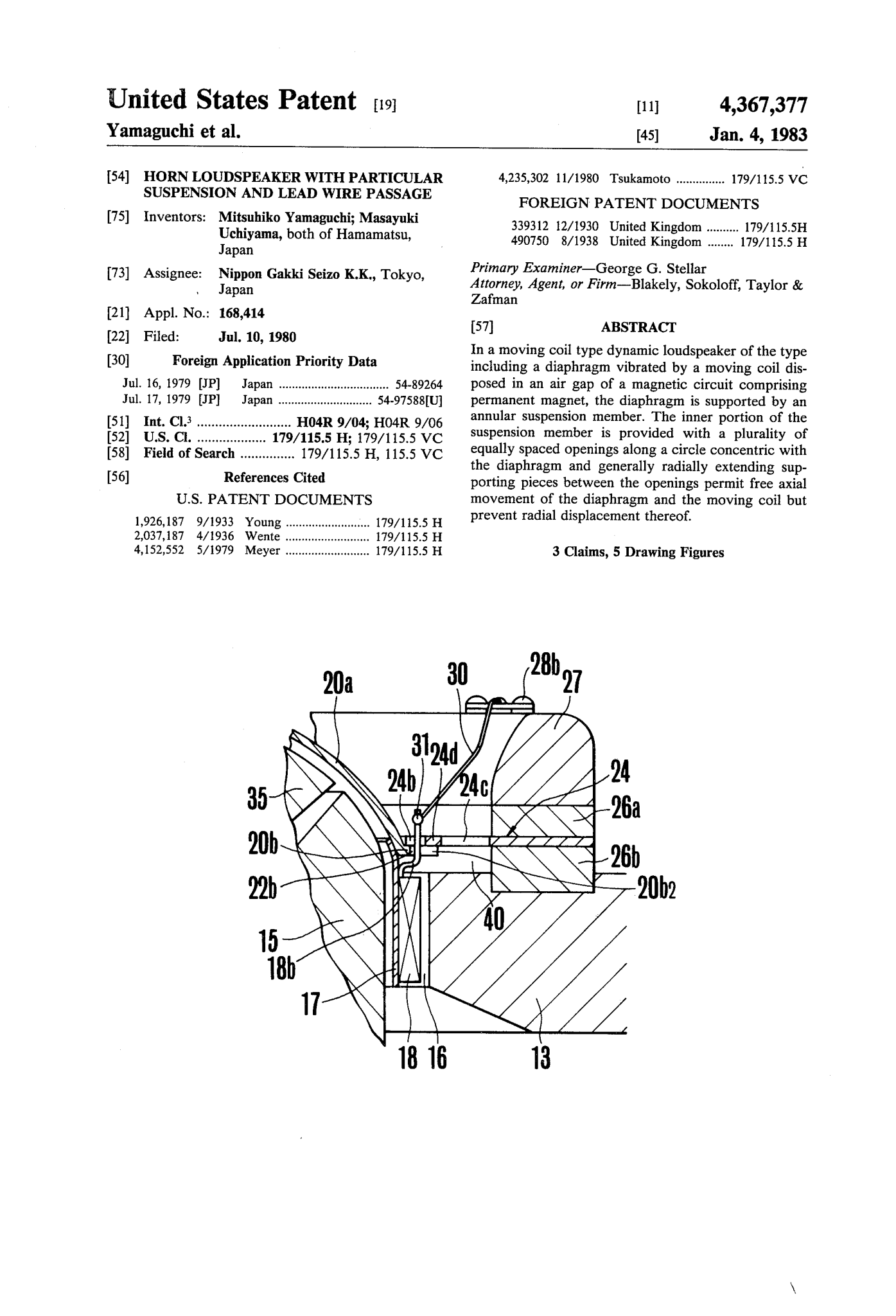

I find the can-do attitude in this thread uplifting. In case folks don't have it already, here's the Yamaguchi et al patent on the famed but short-lived Yamaha JA6681A diaphragm. I got this from a fellow DIYer years ago.
Trivia: Meyer Sound was the largest buyer of the JA6681A, which they used in their UPA-1A loudspeaker and 833 studio monitor. When they changed over to their own driver for the UPA-1P, Yamaha discontinued the JA6681A.
Good luck!
Yamaguchi Patent page 1.pngYamagughi Patent page 2.pngYamaguchi Patent page 3.pngYamaguchi Patent page 4.pngYamaguchi Patent page 5.pngYamaguchi Patent page 6.pngYamaguchi Patent page 7.pngYamaguchi Patent page 8.png

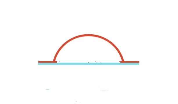

If we punch the duralmin AlCuMg at once we get a shape like in the red drawing. The blue line indicates different foils that the dome with the rim can be glued to. Then the Aluminium with the foil can be routed at once.
