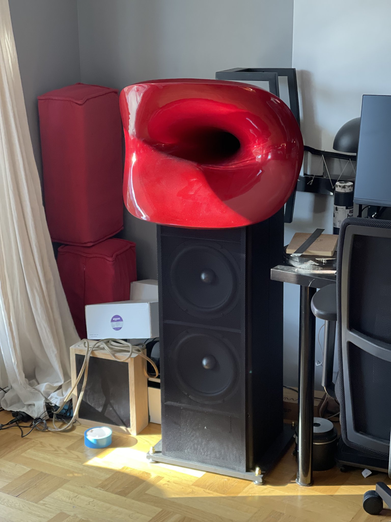

Hi, I am having a 2.5 m deep midbass horn laser cut, but until it is done, I am finishing a ”subwoofer” tower with two Seas W26FX002 on each side and the Ja6681B in an Iwata 300 with the HF10AK in a JMLC 1000. I dabbled with a 200Hz horn from JBL but it was too small.Hi rewind,
Good to see that you are still active with horn systems.
I have not heard any of my horn components for over 5 years. 😭
What's your latest system?

Didnt you at one time use Raal tweeters?Hi, I am having a 2.5 m deep midbass horn laser cut, but until it is done, I am finishing a ”subwoofer” tower with two Seas W26FX002 on each side and the Ja6681B in an Iwata 300 with the HF10AK in a JMLC 1000. I dabbled with a 200Hz horn from JBL but it was too small.
How is the HF10AK comparable to the Raal?
Is the JMLC the E version?
IF you had read my post correctly you would have understood that I had asked that one or more of us might agree to loan out a blownWe loan out a Meyer sound UPA 1A, take the diaphragms out, put our phenolic once in and send the meyer diaphragms in to be cloned. Just kidding.
Who in their right mind would part with their unoptainable fragile diaphragms.
diaphragm-which is essentially useless but would likely be required for OEM to examine and evaluate if we were to have any hope of it being accurately cloned.
Yes, the Raal was nice, but JA6681B is much better without any autotransformer, L-pad or even series resistor, which was be required when playing JA6681B with the Raal tweeter on the same amplifier. I will try the HF10AK more soon. My first impressions are that HF10AK is smooth and clear, while Raal is a bit timid, but possibly more detailed. Maybe I can hear a slight roughness with the HF10AK, due to some breakup, or whatnot.Didnt you at one time use Raal tweeters?
I have the regular round JMLC-1000 horns. I also tried JMLC iwata 600 with the HF10AK and the JMLC-1000 sounds better with the HF10AK. I use JA6681B in Iwata 300 and possibly 600. We will see. Right now this 2-way is playing the socks of anything I have heard: JA6681B in iwata 300 and four W26FX002. The woofers are surpsingly articulate for being slow home hifi bass woofers.
