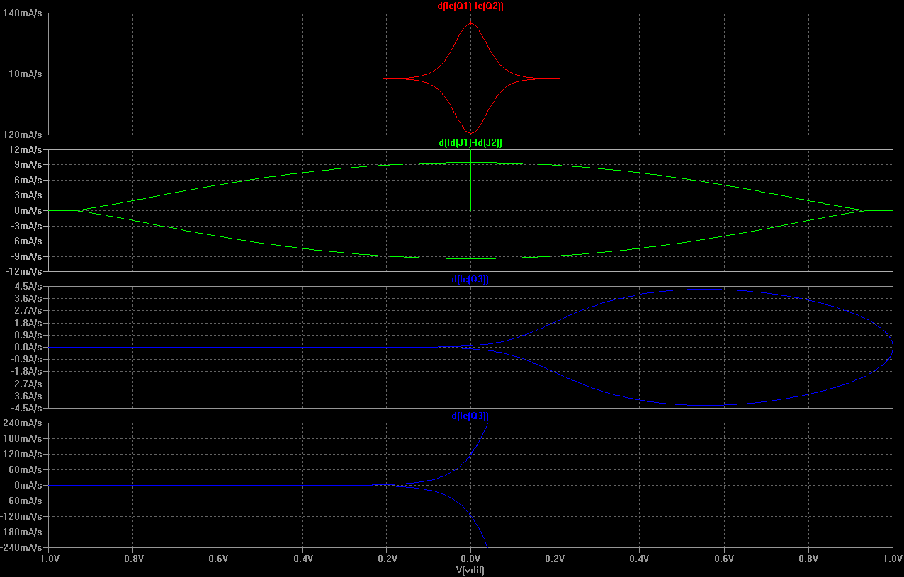

Alright...
R=BJT LTP
G=JFET LTP
B=NTP
Notes:
1: The NTP derivative would itself be exponential except that the BJT is not purely exponential because of IKF, parasitic properties...
2: Gain of the LTP and NTP is the same when their bias current is the same.
EDIT: changed traces a little, new attachment is more realistic...

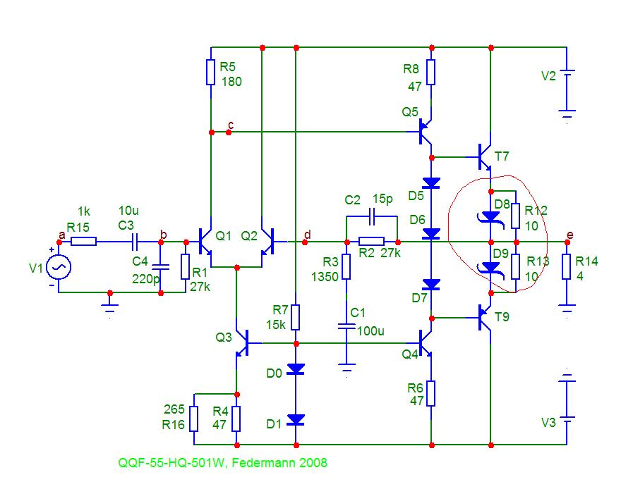

Looks like you guys are rediscovering the ins and outs of a diff pair. Well, I can think of worse ways to educate yourself, this is always worthwhile. Something you discover yourself stays for always clearly in your mind.
BTW, The 10ohms Re with parallel diodes is not a bad thing. There were several amps designed with it in The Netherlands in the 70's, published by 'Audio & Technique'. I did try it one time but it only has an advantage if you can get the point where the diodes take over to coincide with the point where the amp switches from class A to AB, so it restricts some other parameters. In the end, it was found not worth the hassle. But it DOES work.

I especially love his emitter 10R resistors and diodes (red circled)
Look - he was only 39 years late after Clive Sinclair!
And the D5,D6,D7 bias - wow!
These diodes are excellent, but must be sufficient profit in the high frequencies.

For 10% deviation:
Maximum Vdif for a D(transfer) of a BJT LTP is 18mV.
Maximum Vdif for a D(transfer) of a Jfet LTP is 268mV.
The NTP is weird though because there are different margins for positive and negative errors...
10% deviation margin for positive excursions is about 3mV, while for negative is 6.3mV. The NTP is very odd in comparison...
But these are all things I already knew.
And please, if you have nothing to say that will contribute to the discussion, do not say anything.
- keantoken

I'm thinking maybe you misunderstood the latter part of my post.
I am interested whether or not the NTP (blue trace) performs better or worse than the LTP in terms of this odd modulation distortion. I am thankful for the help plotting derivatives and such, since even though it is not what I had in mind I've learned some things that will come in handy.
I would like those who haven't/won't contribute anything meaningful to leave. If I want to do my own research on the subject, I want to do it in peace without several arbitrary voices decreasing the S/N ratio. (if Federman is wrong, I will find out myself!)
I'm working on plotting some more solid data...
- keantoken
