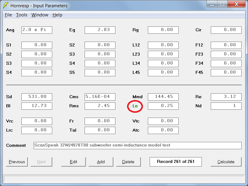

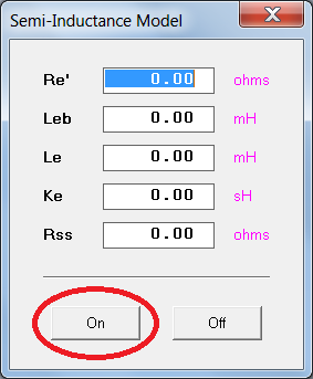

Great minds think alike - I too had decided to use a green Le label to indicate when the semi-inductance model option is being used (see Attachment 1). The red Le label will be retained for the Lossy Le option, and the Lossy Le functionality will remain unchanged.
The semi-inductance model pop-up input parameters window will be as shown in Attachment 2, and will be opened by double-clicking on the Le text box, rather than by toggling the Le label. If the Lossy Le option is currently selected, it will be automatically replaced by the semi-inductance model option when the 'On' button is clicked to activate the semi-inductance model.

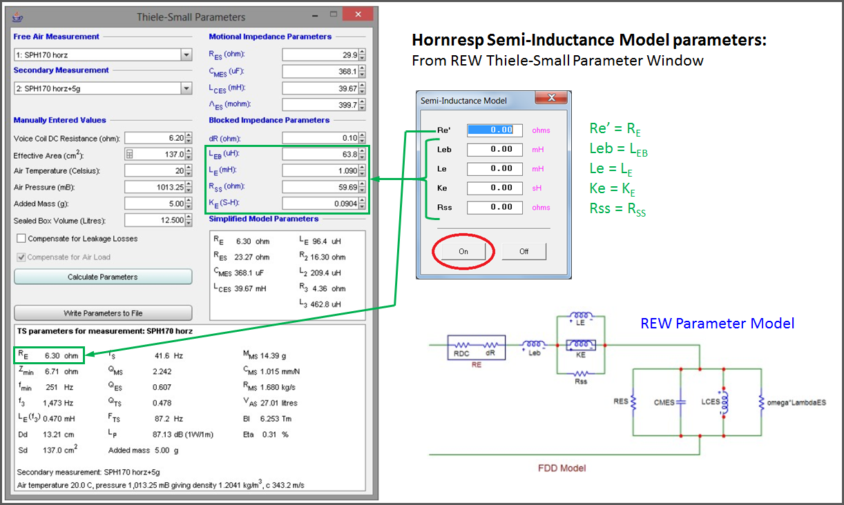

I was thinking more along the lines of which low cost measurement tools/methods/variations/applications can provide these values. What is needed to get going on the hobbyist workbench?
I am very aware they are not specified in from most manufacturers, I think the fastest way is to just start measuring and post the specs on the drivers measured. Waiting for industries to implement new methods or standards can take forever. Luckily we live in a world where we do not have to wait for an industrial mindset lagging behind.
Room Eq Wizard and ARTA give these extra parameters as I understand it, you don't have to do anything different, just measure the driver as usual and note these extra parameters. Then use them in Hornresp after the next update. As for hardware to run REW and ARTA, it's a simple jig you can diy with $2 in parts that you probably already have, just a couple of 3.5 mm jack ends and a resistor. Doesn't have to be a high power resistor, doesn't have to be any specific value as long as you know what it is (although some values are better for some applications).
I'm not sure whether WT2, WT3, DATS give these parameters, never had any of that hardware. I think the S&L WT2 might, it's the best of the bunch of this type of hardware/software combo.
The documentation for REW and ARTA(LIMP module) both reference the Thorborg et al AES papers as the source for the impedance model, but it is implemented slightly differently. Hopefully the attached pics will help identify where to grab the required semi-inductance parameters for use in Hornresp.
If you have text files of impedance measurements taken with other programs, REW can import them to perform the calculations. Oh, speaking of REW, I noticed recently that the curve fitting on the impedance was not so good for some woofers. I mentioned this to the author of REW (JohnPM on diyAudio) and he will be releasing a fix in the next Beta version.
I use an Excel spreadsheet to perform a least squares fit for these parameters if a manufacturer provides traditional TSP and data for the free air impedance curve. It also allows manual tweaking if needed. If only a plot of the impedance curve is available, it is also possible to extra the data to perform the fit using tools like WebPlotDigitizer - Extract data from plots, images, and maps
I have data for a few of the Dayton subwoofers I can post later this week for people to “play” with once the Hornresp update has been released. If there are any woofers from the Databass website that are of particular interest, let me know and I will see if I can get the numbers included in the post. Ricci usually provides a free air impedance curve for each driver along with the traditional TSP.

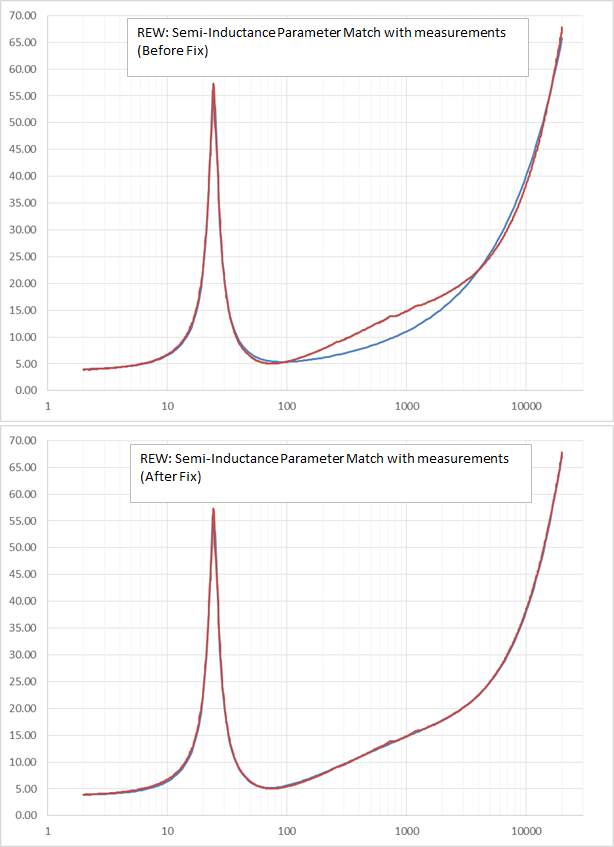

No, I was talking about the matching of model to measurements, not the measurements themselves. The issue you linked to is with mismatch in the LF response of the two channels in the soundcard. Both REW and ARTA can compensate for it, but it is up to the user to realize his particular soundcard has an issue and perform the extra calibration steps. Also, it is best to perform impedance measurements with an amplifier between soundcard and woofer so you can use a low value series resistance.
Attached is an example of the semi-inductance model matching I was talking about.
Results are shown before and after the fix. (JohnPM had sent me a pre-release to try out)

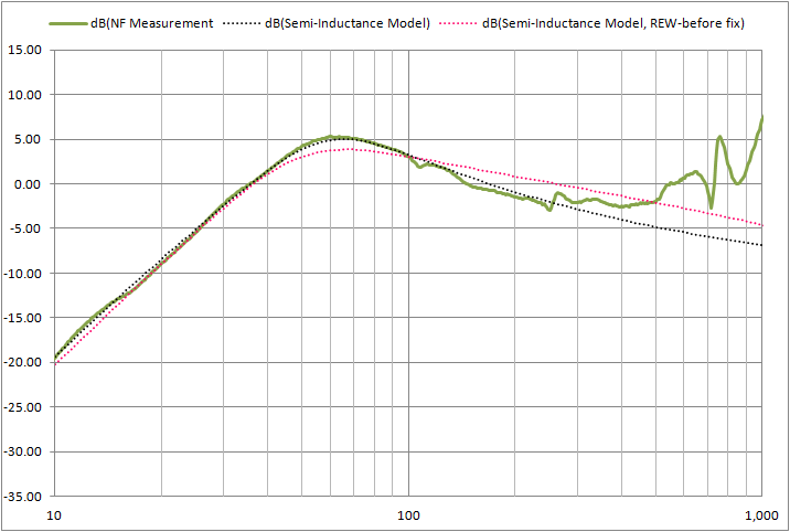

Surprisingly, getting the semi-inductance parameter value incorrect by poor matching above 100Hz does affects the response below 100Hz as it shifts the ratio of resistance to inductance even though the total impedance may be quite close. In this case, it failed to full capture the Q'ing up of the response...still not too shabby compared to the traditional model.
This is one of the unique things I found with the semi-inductance model. Since it is modeling the physical reality of the lossy iron core, getting a match above 100Hz provides proper behavior below 100Hz. In comparison, I noticed least-square fitting of the more generic L2R model, or Wright model did not always match response measurements at low frequencies even though impedance match at high frequencies was reasonably good.
