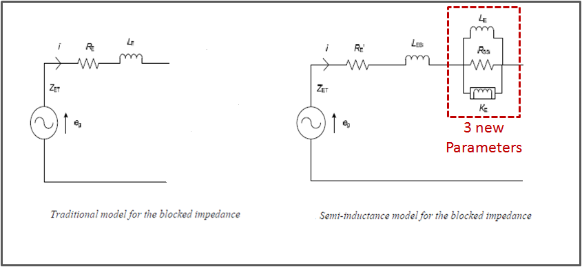

Sorry for the confusion, there ARE a total of 5 parameters, but 2 of them (a series resistance and series inductance) are already in the traditional model. So, you are only keeping track of an additional 3 parameters.It would seem that the Scanspeak data sheets specify five additional parameters for the semi-inductance model, not three
The 2 parameters in common between the 2 models represent different things depending which model is used, so it makes sense that their values will be different.(The values of resistance [Re'] and bound inductance [Le] are different to those specified elsewhere in the sheets for DC resistance [Re] and voice coil inductance [Le]).
Am I missing something here?
Traditional Model
Re = DC resistance
Le = inductance at an arbitrary frequency of 1kHz
Semi-Inductance Model
Re’ = DC resistance + resistance of any shorting rings outside the gap transformer coupled to the voice coil. Depending on the woofer design, this value might be the same as Re, or a few tenths to half an ohm greater than Re. The effects of shorting rings in or very near the gap are captured by Rss.
Leb = inductance of the portion of the voice coil that is more distant from the iron. This parameter mainly affects the impedance in the top 2 octaves. The inductance/semi-inductance of the portion of the voice coil in closer proximity to the iron is captured by the parallel combination of Le and Ke.
BTW, the model began with 15 parameters to describe the magnetic circuit. It took quite some doing to simplify down to a more manageable 5 parameters while retaining the features necessary to capture the variations of woofer motor design.
Ha!it would have seemed more logical for bound inductance be designated as [Leb] rather than [Le], and free inductance to be designated as [Le] rather than [Leb]
Funny thing is, the terms “bound inductance” and “free inductance” do not appear in any of the Thorborg AES papers or other presentations on the subject. I actually had not noticed the terms in the data sheet until you pointed them out. I had always assumed Leb stood for blocked inductance, but not sure that makes sense either. I posed the question to one of the authors of the 2011 AES paper, will let you know what I find out.
Hi bolserst,
Many thanks for the clarification. Just to check that I now understand correctly - in effect Re and Le simply get a name change to Re' and Leb when used in the semi-inductance model, and the Re' and Leb values given by Scanspeak are substituted for the traditional DC resistance and voice coil inductance values. Is this correct?

That is correct.…in effect Re and Le simply get a name change to Re' and Leb when used in the semi-inductance model, and the Re' and Leb values given by Scanspeak are substituted for the traditional DC resistance and voice coil inductance values. Is this correct?

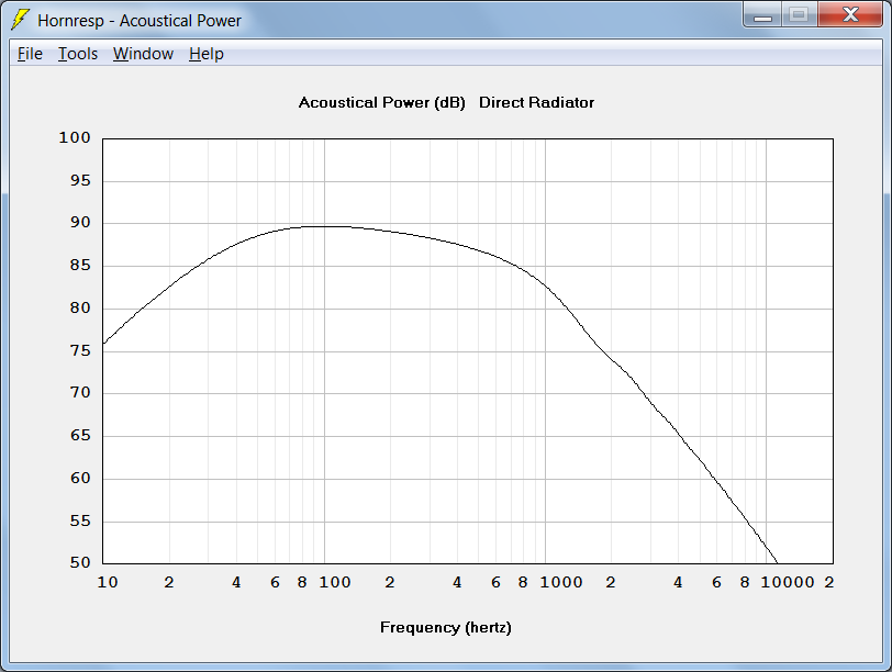

I have started looking at the possibility of including the semi-inductance model as another option in Hornresp (the existing Lossy Le model option developed by 'just a guy' would be retained).
The attachment shows the power response for the ScanSpeak 32W/4878T00 subwoofer mounted in an infinite baffle, using the semi-inductance model.
For the sake of completeness I will probably also consider making allowance for the admittance parameter, even though it seems to make little difference to the results, as you say.
It may take a while for the new production version of Hornresp to be released. The easy part is coding the calculations. The more time-consuming parts are sorting out the user interface to enable the required "advanced parameter" values to be entered, and changing the data files to permanently store the required extra parameters. I know what I want to do, but getting everything to work as intended can sometimes be quite a challenge .

This is fantastic. I'm sure Ricci will be on board to include these parameters for models he tests on data-bass, and hopefully he still has screenshots of all his previously measured drivers that he can add to the driver collection that's already there.
I felt the tide going this way so I've already imagined what this feature might look like. Perhaps toggling through "Le" (normal, lossy le, semi inductance le) by double clicking them, and maybe semi inductance Le could be green. Then if semi inductance model is chosen (green Le), a new small window could pop up asking for the 3 extra parameters. If you needed to change these parameters you would cycle through until Le is green again and the box would pop up again.
Not sure how else it could be done, it would be tough to fit 3 more boxes on the input screen.
But I'm sure you probably already have your own ideas that are better.
