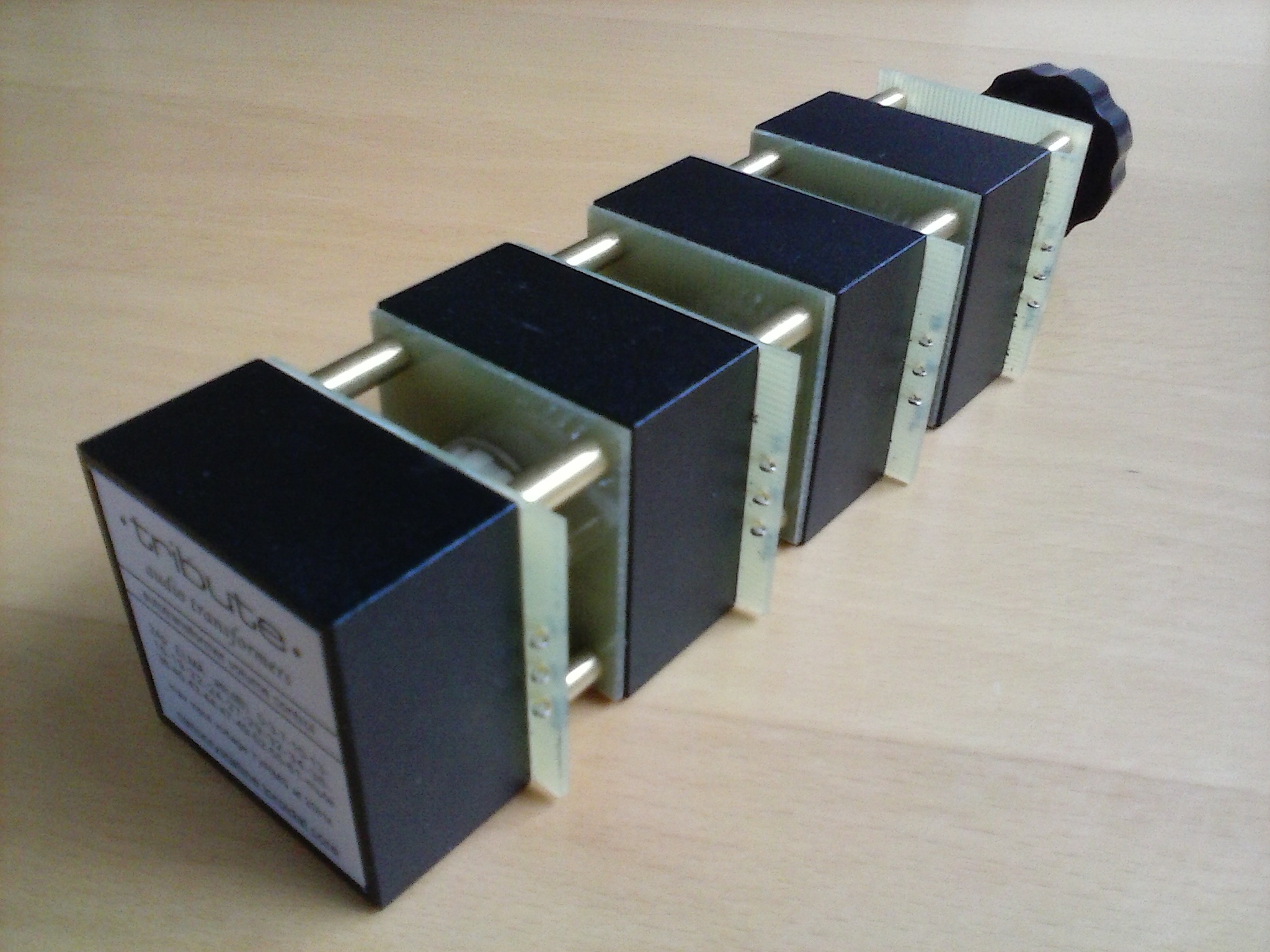

Wanted to post briefly in praise of the Tribute Autoformer Volume control. I've been sceptical about passive preamps for a while but something about the simplicity made me want to give them a try. It was complicated by the fact that everything up to the power amp inputs in my system is fully balanced (phono is fully balanced valve stage). Pieter supplied me with a beautiful 4 way AVC.
Having built it in a crummy old box, with a 4 way selector switch and tried it I was blown away by how much better this was. And it wasnt competing against junk, but a handcrafted balanced valve line stage!
In my view well worth the money.

The Tribute balanced AVC is 4 autoformers on a single spindle. Left/Right x +/- phases so 4 way.
The Autoformer is like a transformer but only one coil. The secondary is 24 taps.
Read lots about them and the way they present such an easy load to the source, but also instead of wasting signal as heat it changes volts for amps. So instead of sounding worse at low volumes it sounds in theory better. Ok not sure if go that far, but I can't quite believe how much of my system I've been masking.

Picture of the Tribute

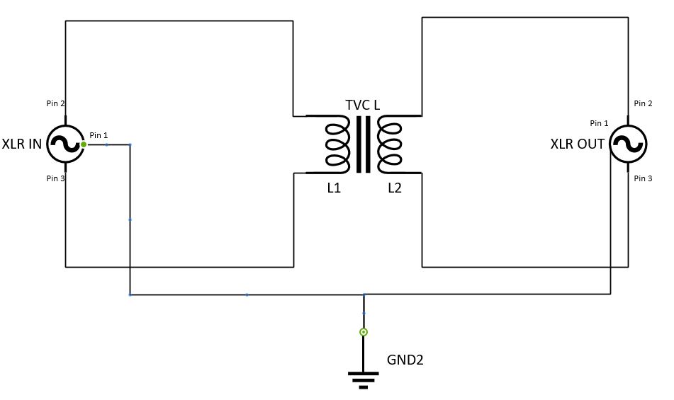

Mick, my system is balanced all the way - my phono-preamp is balanced in from the cartridge and balanced out. My Dac is balanced out. My power amps are fully balanced from input to output. Yes balanced is the way to go. My TVC is also balanced but it does not have one coil per phase. Only one coil per channel. A transformer cares not if the input (or the output) is single ended or balanced.
My question was not around the complexity of balanced operation - in fact balanced operation has enabled me to simplify my system and sounds great as well. My question was why the cost of a 4 way AVC - I simply use 2 transformers and its all balanced.

Perhaps my inexperience but I don't get it. Surely to volume control left (+ and -) and right (+ and -) you need 4 AVCs (or TVCs) ?
Perhaps the AVCs are different to the TVCs. With the Tribute, each of the 4 AVCs has IN, OUT and Ground. XLR pins 2/3 go to the INs (via the switch) and I've commoned the grounds for each channel across the inputs, the AVC and the XLR out.
Perhaps you're saying you connect the + and - of the input across the transformer primary, and similar with the secondary ? Hmmm ok I think I see. I wonder if a stereo autoformer (which I have spare) would provide a balanced volume control in that way ? I think I'd need more experienced heads than mine to comment on that.

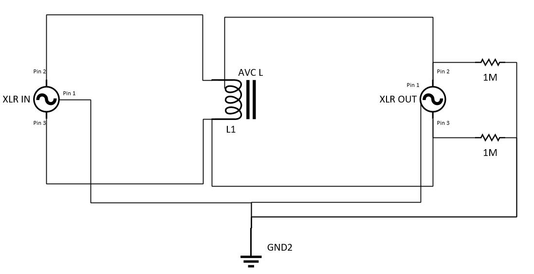

So is this how you're connecting ? (1 channel shown and no switch for simplicity)
Yes, +ve and _ve inputs across the primary and secondary. No centre tap.

Thanks. Pieter at Tribute was adamant that balanced stereo needed a 4-way, but I understand what you're saying. I doubt his motives are purely cynical/commercial so I think I'll pose a private question to him.
Re power amp, I'm strictly a valve man but thanks.
Speaking to Pieter and to more experienced friends yes I see how this works.
The Tribute stereo (2-way) control can accept 7VRMS so as long as the voltage across the two phases doesn't exceed this then it should be ok. There's also the increased indutnace : 150H of single coil inductance is some 18k at 20Hz (becoming much higher at higher frequencies), with 2 coils not a problem but possible effects from running it across the 2 phases.

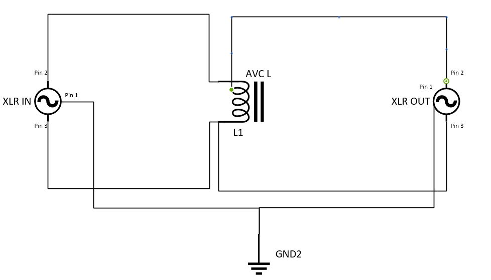

Some of this is beyond my experience and knowledge level, so I'm going to build it and try it out. One suggestion was to give the output a 0v reference as per the diagram attached.
