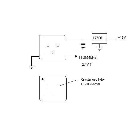

I was sceptical about what a new clock could bring to these old Philips chipset cd players.
I knocked together a cheap clock the other day from parts found at http://www.rapidelectronics.co.uk/ (oscon caps, TTL 11.2896 crystal oscilator module, 8 pin dil socket, small stripboard etc). It took about an hour to build, I then triple checked wirings/ solderings/ layout, and then measured the voltage on the outputs of the new clock (2.4V) when unconnected. Connected it up, listened, and could instantly tell that the player had changed for the better (less fatiguing, more foot tapping).
As I don't have the equipment to measure jitter I mounted the canned oscilator on a 8dil socket so I can easily fit a Tent oscillator ( which is potentially low jitter) in the future.
I had thought about building a kwak clock but I came to the conclusion that I wouldn't be able to get the layout right.
Kind regards,
Ashley.
Kind regards,
Ashley.
riccardo said:Hi. could you post the schematics and some picure , oro link,of your new clock?
Thanks.
R
Well I just wanted to test a clock change first.
I just got a L7805 regulator,oscon capacitor , a oscillator module, and connected them together.
This isn't really ideal so maybe next week I will build the powersupply from one of the attached links now that I know how large the effect of the clock is!
Reading on the forum, and net it seems oscillator design is a black art so probably best to stick to proven designs. Also it seems few people actually have the equipment to measure jitter properly which explains the plethora of aftermarket clocks available.

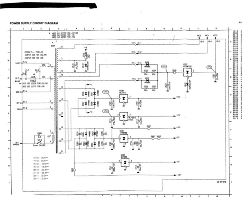

Digital Supply!!!!
The same +10V supply feeds the servos and the +5V regulator. This +5V regulator supplies the digital section and the DAC. You probably need to connect to supply to your clock PCB somewhere between the 6,800uF cap and the +5V regulator. However, a better result should be obtained by giving the clock its own transformer and supply.

I did connect the new clock Pcb (from Elso Kwack, txs) before voltages +5 and +6 digital regulators.
After that, i did connect clock output directly to pin 11 of SAA 720, and ground to PIN 12.
Obviously, i removed, at first, two cap of 47pF at oscillator leads.

changing supplys caps
Hello.
I'm restoring this old cdplayer, and at first i did change the cap after the trasnformer, with panasonic FC same value.
I have a doubt about the caps after the voltages regulator.
So, my question is: what caps and values i could use for 47uF 25V and 33 mF 16 volts (old caps are Nichicon VX(m))?
And, again, what kind of caps? Sanyo OS CON?
Thanks a lot, i need some suggestion 'cause caps change drammatically the sound of cdp.
TXS.
In attacched schematics.
Riccardo
Hello.
TXS.
In attacched schematics, i hope more readable.
Ciao riccardo
