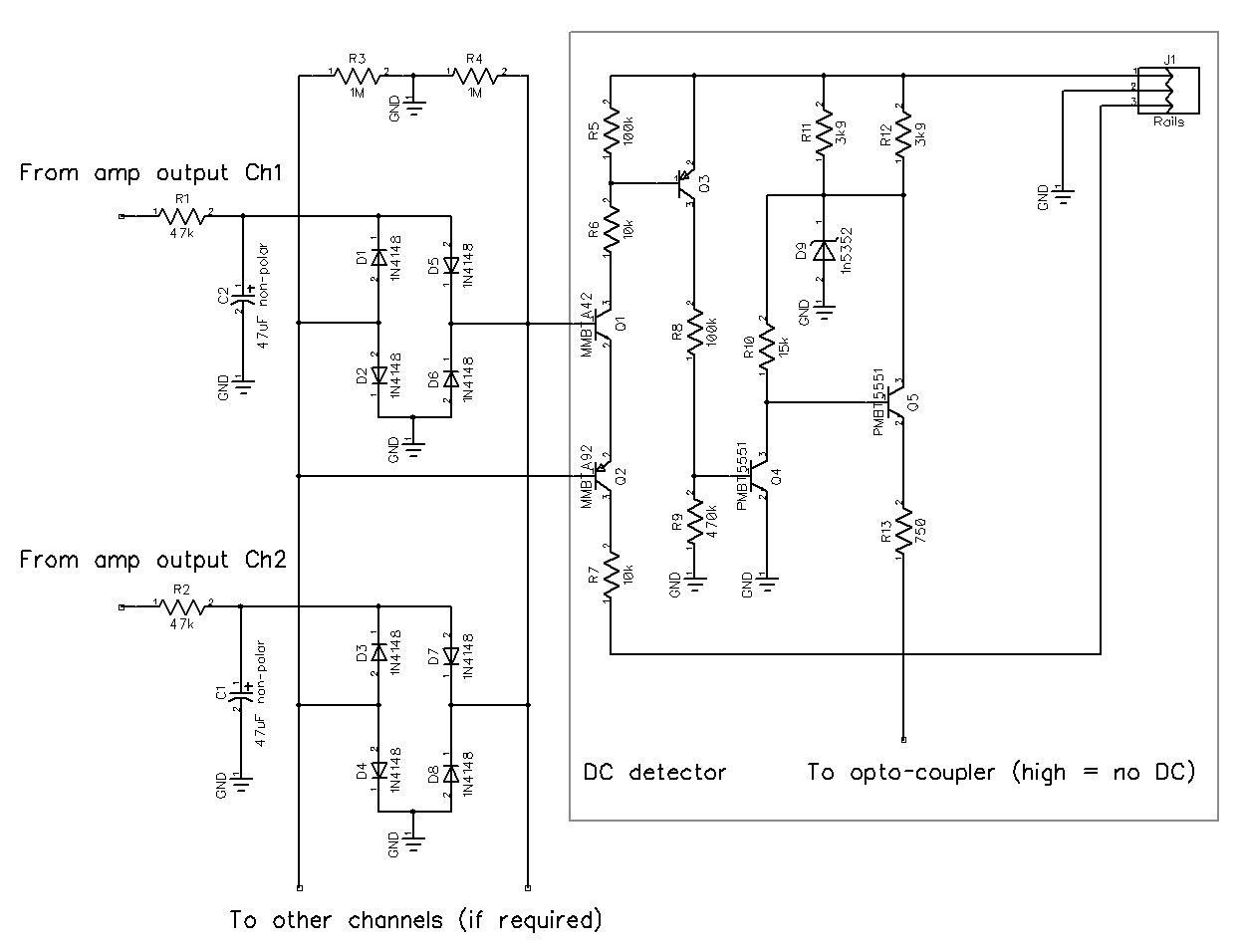

Here is the way we do it in our "21-st century control board".
Single DC detector, separate independent integrators, serving as many channels as required - no limit, literally.
Easy scaling - to add more channels, you just need to add one resistor, one cap and one small signal diode bridge per channel.
Extremely reliable - saved many speakers as well as output stages.
Channels are sensed independently - if one channel goes positive and the other one goes negative for the same offset voltage - it works anyway
Any combination of voltages in any number of channels is fine

Thank you very much for sharing your design!
This looks promising and I will have have a closer look at it.
The circuit seems to run with a symmetric supply, right?
Yes, we run it from the main amp rails - like +/-50...70V DC.
Its output signal is opto-coupled with the rest of the circuit for keeping the ground separate from the digital part (less noise and other artifacts).

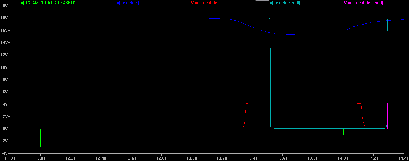

I compared different DC detectors with quite interesting results:
The detector I currently have in the schematic has the disadvantage that it is far less sensitive to negative DC than to positive.
The Zero Audio one is based on the one D. Self has in his books but more complicated. I simulated a circuit half in between both. This runs from dual supplies and does show equal sensitivity for positive and negative DC.
I also simulated another one from Selfs book based on a differential pair that runs from dual supplies as well and shows similar behavior. This one I found rather difficult to get running.
It seems that for equal good +/- sensitivity dual supplies are necessary.
However, once the output is fed to the latch circuit, the difference in sensitivity is negligible.
Attached plot compares my current one with the Self like one in case of negative DC of 3V.
