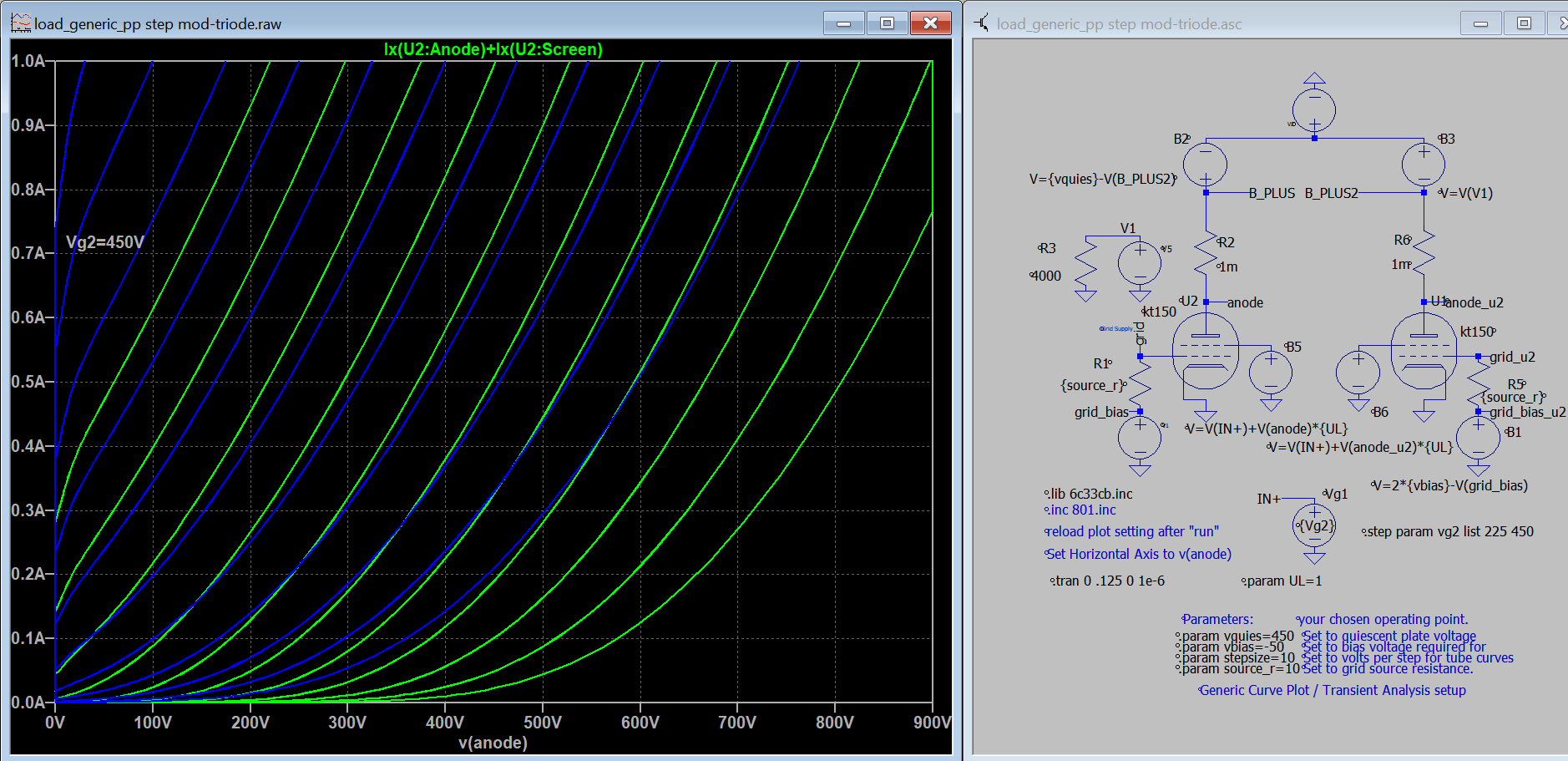

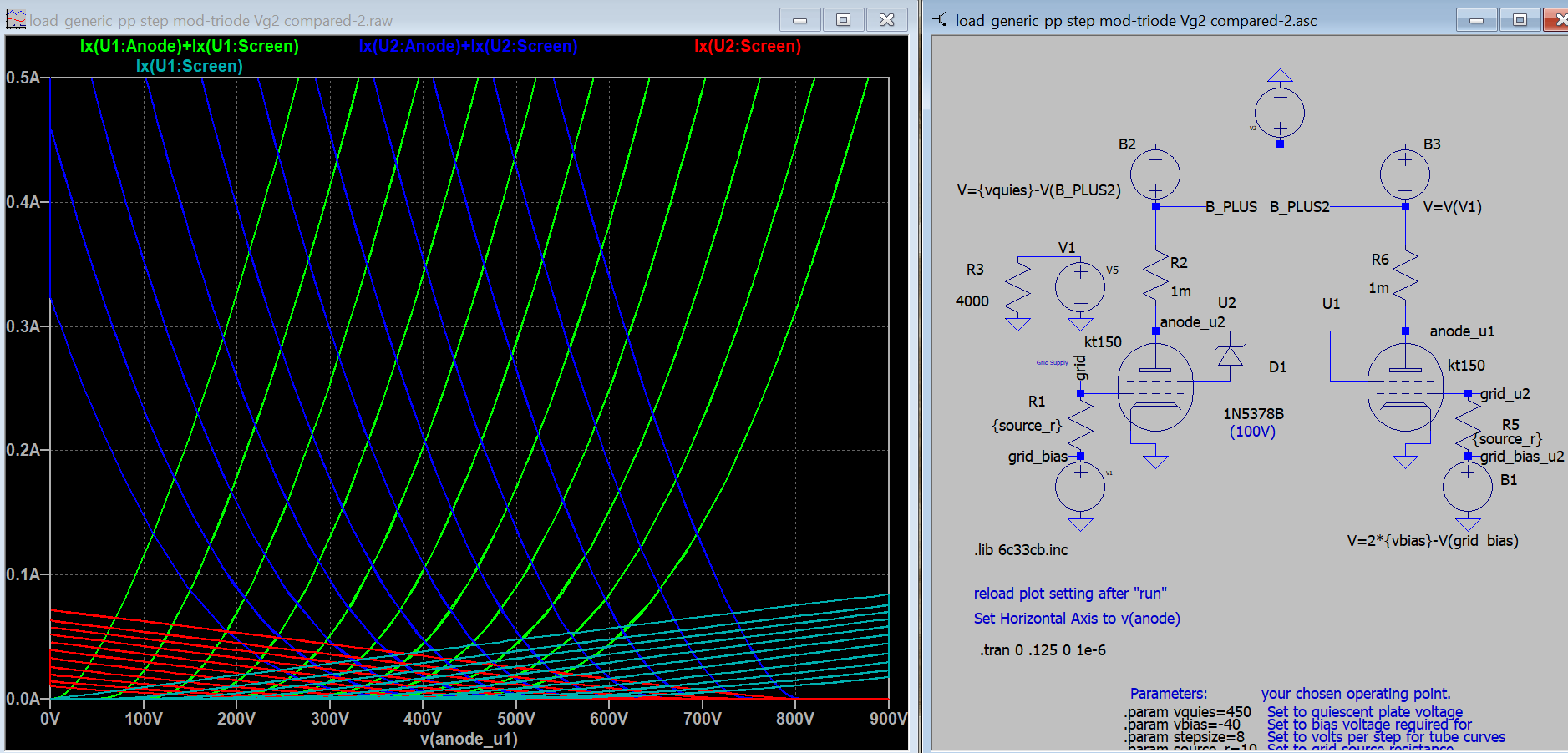

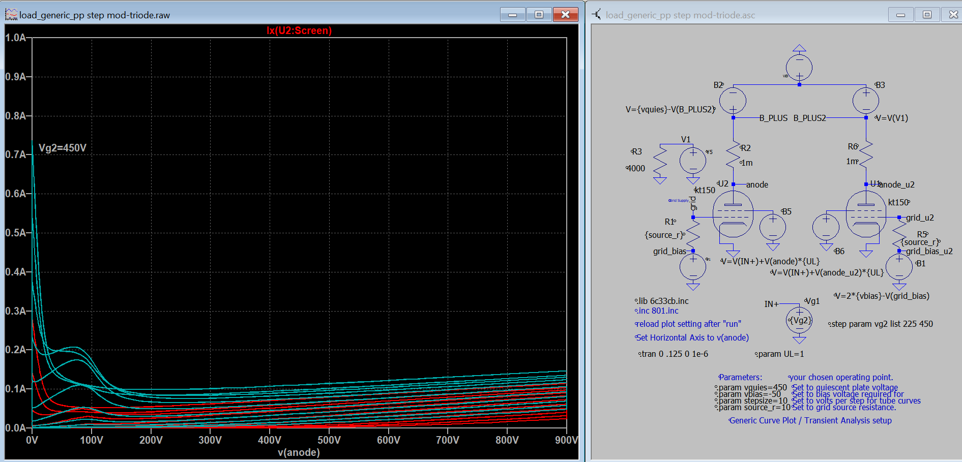

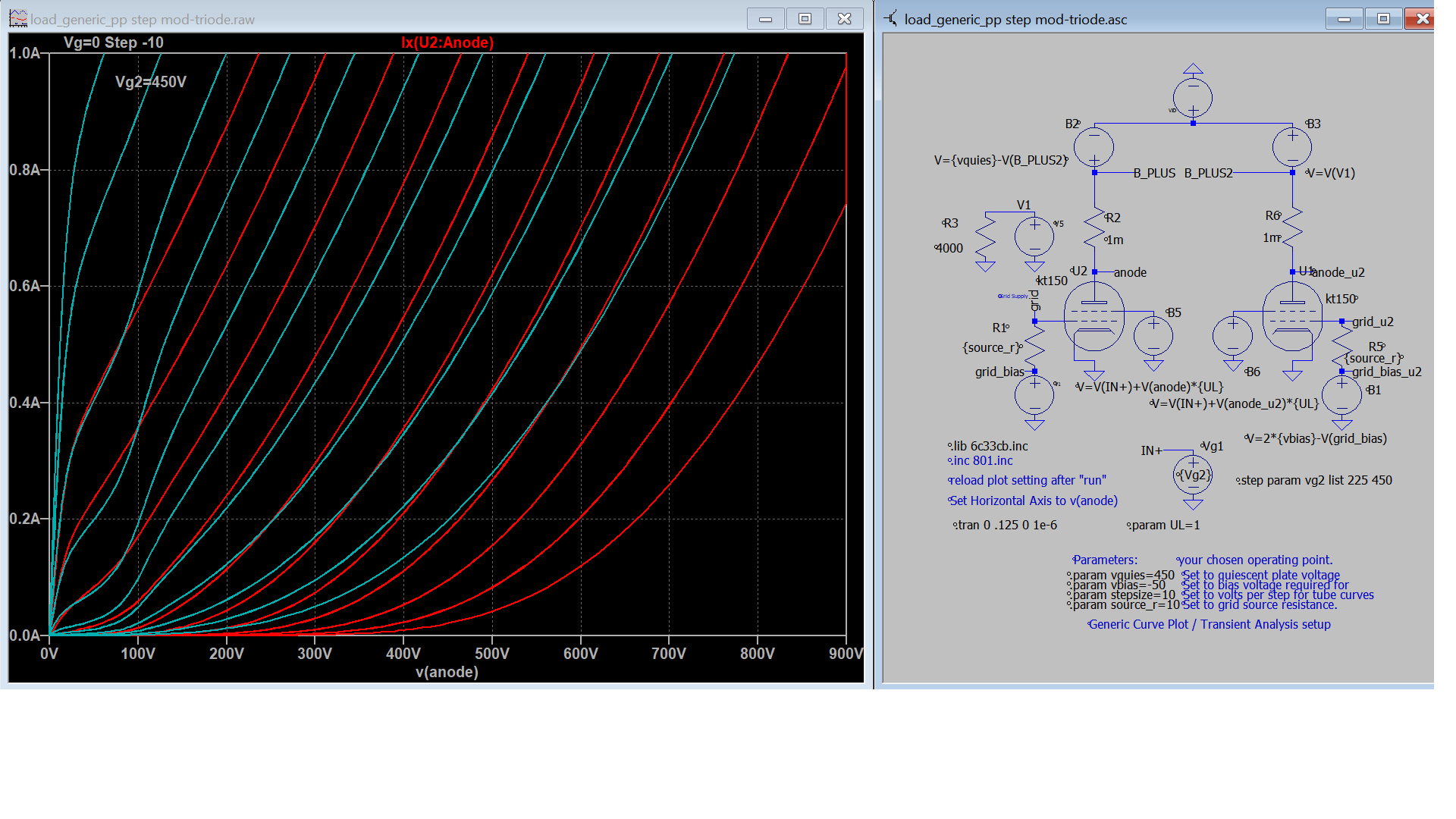

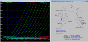

Food for thought. Just plot screen current of triode mode with Vg2 225V and 450V. The kinks are more pronoun when Vg2 is at the plate potential, Ig2 is exceeding power dissipation (unconfirmed), triode curve shifted to the left by about 35v

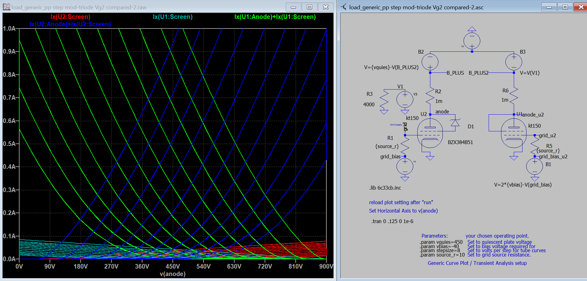

These plots are more accurate than previous, I need to revise the simulation, using zener diode is easier than using equations.

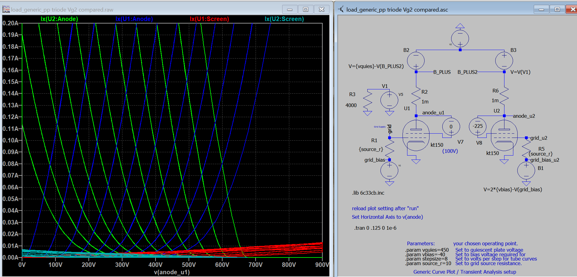

The screen grid2 current has been adjusted downward, dissipation appears with 9W limit. If the screen voltage is reduced the dissipation is lower, there is no Vg2 current curve in the datasheet, but it said not more than 15mA, it depends on the operating points.

Ok, for what I understood until now in triode mode plate surface has the major area than screen and if they are tied together (=same V) electrons are most in the plate. So the screen can tolerate some more V than specs.
In case of UL things appears to me more complicate, because also of UL% contribution...I don't know.
For the 5B/255M circuit you posted indeed the tubes run at +40V than max operating values, I can't say how it comes out. They can be "pushed" over without negative effects.
