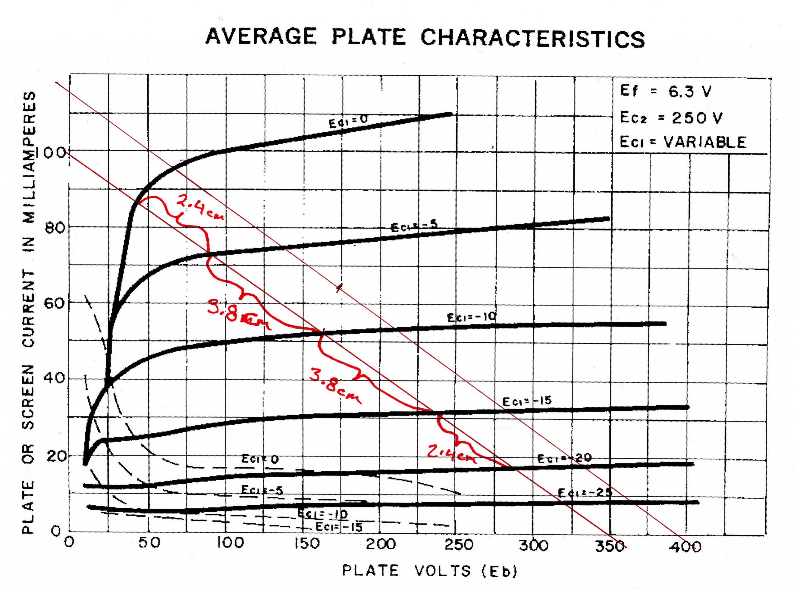

But if I choose a lower g2 voltage, the curves change, voiding the choice of operating point and load I decided on based on the curves. No?
In other words, are the curves given by the manufacturer actually useful in choosing an operating point or does every good designer toss the data sheet and make their own set?
Both are done on the data sheet curves. The graph on the left is my choice (Vp 162.5, Ip 52mA, Vg1 =-10 , Rl = 3k25.
The graph posted on the right is meant to be an approximation based on the operating point suggested by sser2 in answer to my question "If you were going to build based on these curves, where would you set your operating point?" His answer was Vp250 (withVg2=250) , Vg1= -15, and load of "500V / 80mA = 6.25K (approximately, by eyeball)"
As for trying curves with lower g2. I don't know how to calculate that. I'd have to set up a jig and make my own from measurements.

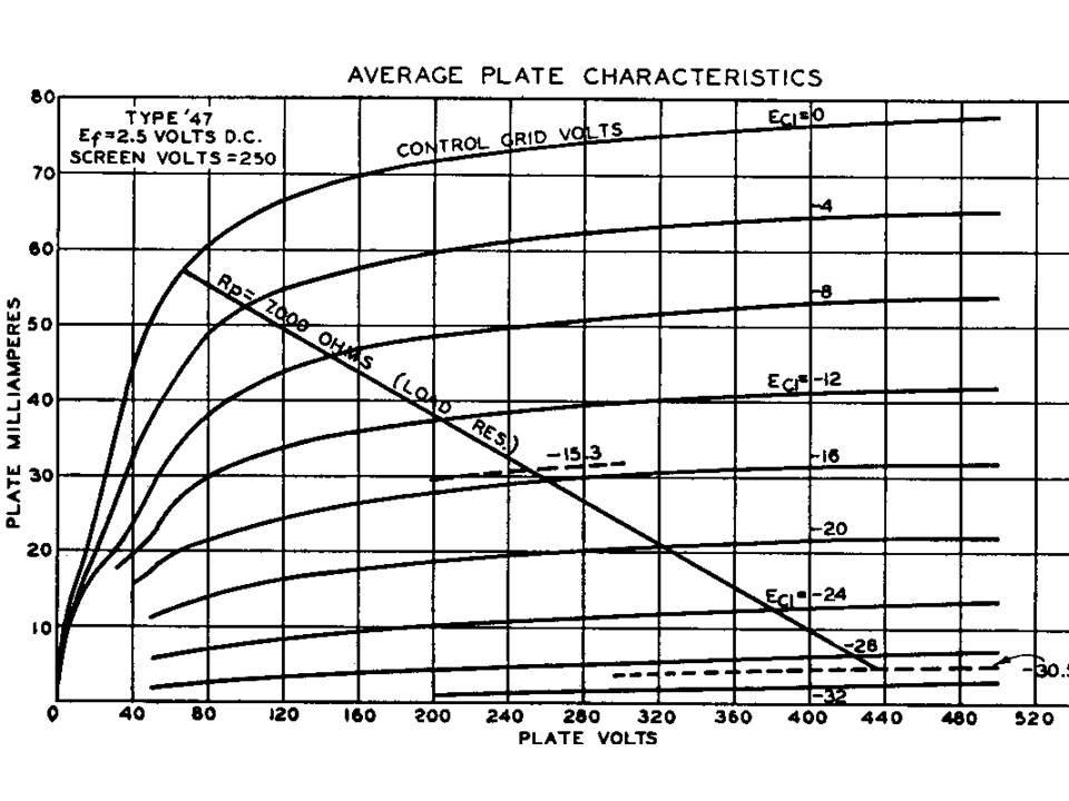

The tube on your graph is not very linear to begin with. Load lines for different load resistances are all kind of compromised in one way or another: it is either more 2nd order distortion (decreased curve spacing towards the bottom right of the load line), or more 3rd order (decreased spacing at both ends of the load line). At one particular load value, 2nd order distortion becomes minimal, and this is what is recommended as optimal load. 3rd order distortion is low at low Rl, and it increases monotonously until load line crosses the "knee", after which it does not increase much further with Rl.
Pentode distortion cannot be regarded without simultaneously regarding power. With low Rl, distortion may seem low from the way the load line crosses the plate current lines, but what is important is how much distortion you get at certain power output. For example with 3.5K load, the maximum power is, say 2W at 5% THD. If the load is 6.2K, the maximum power is 3W at 7% THD. In the second case, distortion seems worse. But if you turn signal volume down so that power is limited to 2W, distortion will get down to 3%. Thus, although the 6.2K load looks worse on the plate curves, it performs better than 3.5K load at equal power.
Here are the curves and load line for 47, which is a pretty linear audio pentode:
Yes, but because of that I'm getting a much better education from you than I likely would have if I started this with picture perfect curves. You're helping me to understand the basis for making the choices rather than a cut and past answer, which I'm not really interested in.
With low Rl, distortion may seem low from the way the load line crosses the plate current lines, . . .
I was actually using the distance between Vg1 lines. I think I see that they're not exactly equivalent at the upper left which tells a little more about the distortion around the knee.

And also does that mean that on my load diagram if the Vg1 swing is kept between -5 and -15 the 3rd harmonic will stay relatively low? . . . And then that going more positive than that, the load line at the Vg1=0 curve indicates that 3rd harmonic will be higher because it is going through below the knee?
....many comments online advising against operating a pentode with Vp much less than Vg2.....
There are "many comments online" about EVERYthing. Many of them are junk.
The #1 engineering objection to your plan is that you need a large amount of 162V and a small amount of 250V. Do you build a 250V supply for Vg2, then waste-off 90V at high current for plate supply? Do you build two supplies, one 250V one 160? Either way, your Product Manager objects to the cost. Most audio pentodes were designed to work well with Vg2 very near to Vp (or a bit less because Vg2 should be filtered better).
DIY economics is very different, true. Maybe we "like" building power supplies. The next issue is that as peak plate potential falls below typically 1/5th of Vg2, the G2 current goes way up. (Same reason a True Tetrode can't usefully swing plate below G2, but shifted due to G3 action.) Taken to extremes (guitar amps), G2 melts. If not melted, the reduced plate swing and G2 current-stealing reduces power output.
In general, a higher power amp may play lower power with lower THD. That means between a 6W 3%THD design and a 3W 2%THD design, there may be little difference at the 3W level, and the 6W plan will go a little louder before it goes "splatt". It rarely makes sense to aim at a lower power, even if the lower target has lower THD. Between similar plans of slightly different power, the difference may be much less than can be inferred from old hand-plots or SPICE models (both inaccurate at fine detail).
But sure: if you like Vp=160 Vg2=250, do it. Nobody will arrest you. You are not so far-out that any damage is likely.

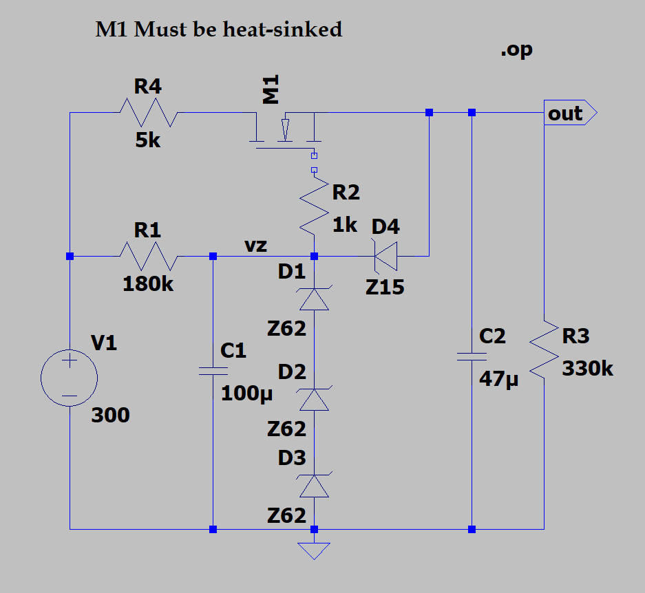

What kind of FETs would one use to make a solid state regulator ?
I see those transistors 78xx - Wikipedia but that stuff is limited to lower voltages.
Thanks.

Search Maida Regulator -- there are lots of implementations which limit the voltage across an LM317. Many threads on the MAIDA on DIYAUDIO.
Here's a version of the screen regulator used by Pete Millett. M1 is an FQPF8N60 or similar:
