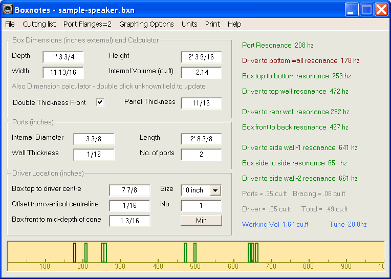

I've just uploaded the latest version of my "boxnotes" program, containing the new imperial measurements option.
This was a major undertaking, and was the reason for developing the routines in the first place. !
I'll now have some time to look at a calculator.
Here's a screenshot of "boxnotes" in all it's imperial splendor

I agree!
The first time I saw the screen fully populated with imperial data, I thought "how can anyone make sense of this". Anyway, I imagine that those who are forced to work that way, will be happy that they're catered for.
Your comment about "only metric (mm & m not cm)," is interesting. I too, think in mm or metres but not cm. The cm just doesn't seem to be of much use, at least for building speakers.
