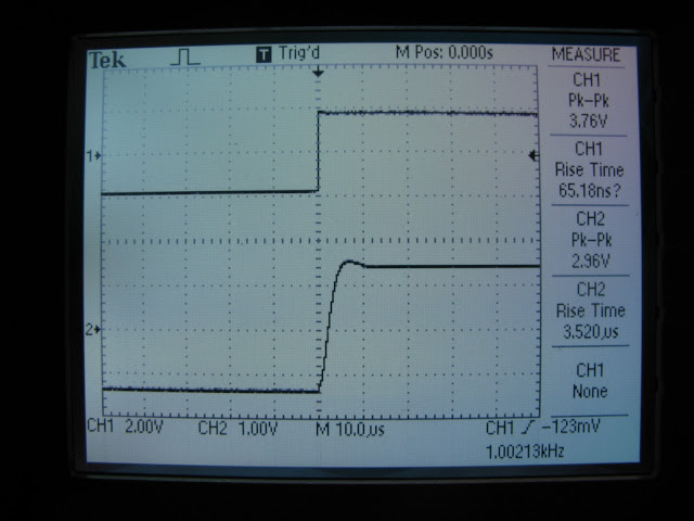

I didn't get a chance to add a capacitor, but I'm curious to its effect. Does it straighten up the waveform a bit? Here are my measurements.
I tied together all the leads on the primary and injected the signal on the red wire. The was connected to one probe, and my Tek CFG280. Signal was measured on the scope to be a 4dBu sine wave, then I hit the square wave button. (not all that scientific, but I tried). The other probe was connected to the yellow wire, and the ground clip to the orange wire.
First test was 10K across the secondary:
Then 15K:
Then 18K:
Then I decided to pull out a crappy heat gun for stripping paint and try to see if I could induce some noise into the transformer..
Tried all kinds of configurations, but no noise, even in peak detect acquisition mode.
Then I was wondering... should I take the 100K pot into consideration? Also, this would give me slightly different measurements... so I did the following:
100K || 18K
100K || 15K
100K || 10K
Anyways, yeah a pot would have been smarter, huh :dead:
So, was this testing quasi correct? Of course, I'll just use your final values, but it was a rather fun experiment :)
First, let me say that I'm envious of your storage scope! And you've done a nice demonstration of the virtues of a good input transformer.
The RC combo gets rid of some ringing that I saw in mine when terminated by 15k. Now, that ringing is also dependent on the source resistance, so YMMV greatly. I used a 600R source for my measurements, your was probably lower, judging from the waveforms you're showing.

Thanks! My source impedance was 150 ohms, straight from my function generator. I'm just beginning to understand the importance of impedance in testing jigs, as I ran into a case this week where I needed to divide a signal down -60dB from my function generator and was surprised to not get what I thought I would.
Can you explain why you did the testing with (10K + 220pF) || 15K? I don't understand the 15K, as the next element is the 100K pot? The 600R source is what is mentioned on the datasheet. So, is it the case that you'd expect the values you choose with 600R to work well with lesser input impedance (i.e. 600R is a "worse-case" scenario?), or is more that is some sort of standard value to use.

The 600R was arbitrary, representing my worst source. With that source and a 25k pot (which is what I'm using), there were three cycles of overshoot. To be honest, there was nothing systematic, I just chunked in various Rs and Cs until the square wave looked right. It still looked OK with a 50R source, so I soldered that Zobel in.
With just a 100k pot and no resistor across it to bring the load down, you can come up with a Zobel to get rid of the ringing, but the source impedance becomes MUCH more critical- change it just a bit and the Zobel doesn't do its job.
