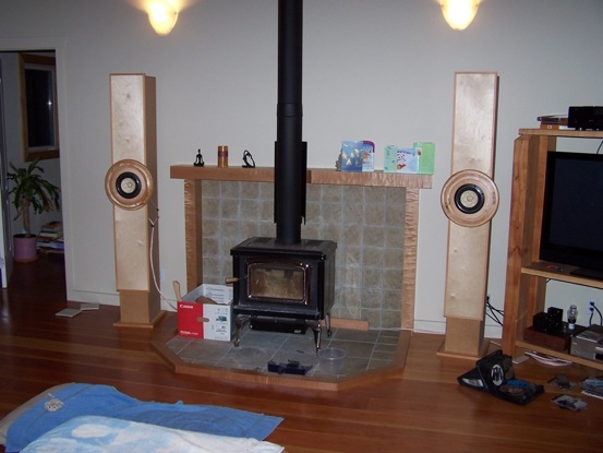

Id try to rearrange the room first.. The BIB's look like they are firing from behind your gear stand, and the sound field looks like it will be bouncing all over the place from the pic.. Why not if possible get the gear rack up against the wall at least, and have the BIB's forward from the rack instead of behind it, Id bet you'd experience a world of difference.. Dave
