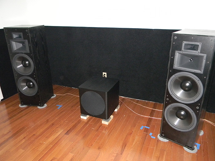

Hi Guys, I came across a nice repairable pair of Klipsch KLF-30's. I fixed up the loose baffles and backs and will be sticking with them. They are far superior to anything I have ever built. Also the first cabinets I've ever heard that don't sound like cabinets. So I guess my DIY days are over. :eek:
I can't beat this sound.

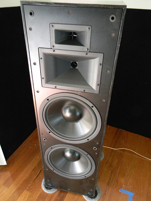

So right Dave, as a whole the systems performance is in the top 10 percentile. Closer than I have ever heard in my house. I have read many a story about people picking these things up cheap because the hot melt failed on the backs and baffles. I installed some oak strips all the way around both sides and siliconed and glued them in. Then I siliconed and screwed the backs and baffles on and wah-lah. It was a little work but the payout was worth it.
